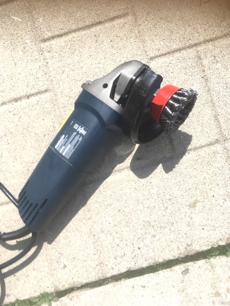

Above treatment suggested was for small rust areas, near plastic, connectors and electrical components, where care must be taken.
Larger, more exposed areas will benefit from power tool usage.
Of course, wear gloves and goggles. Grinder with wire brush attachment.
