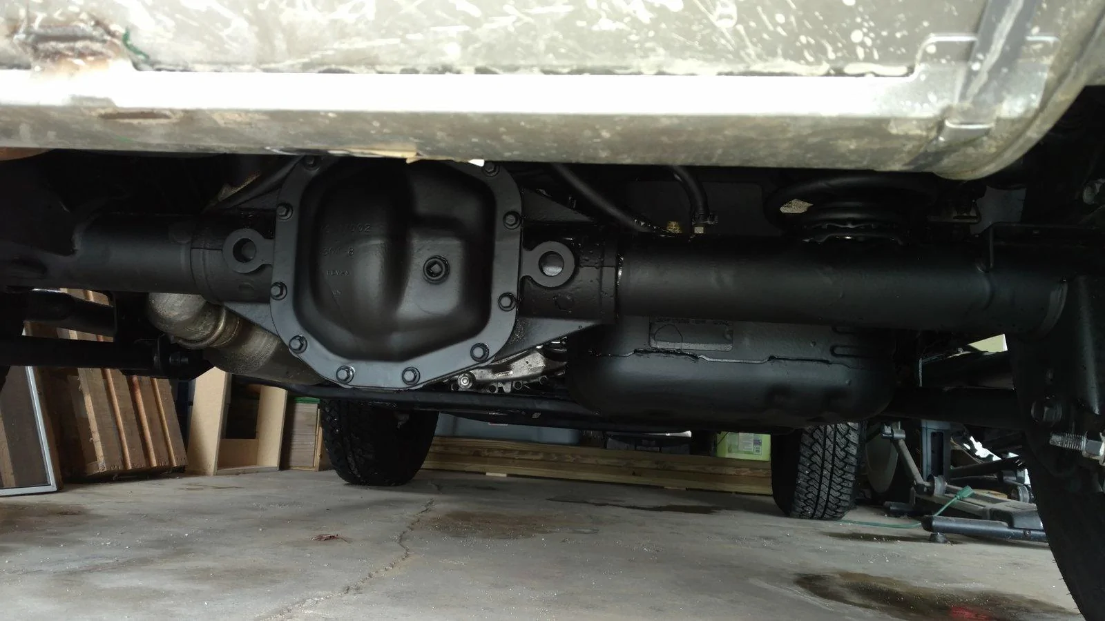

I paint everything under neath when brand new after pressure wash. Use rust encapsulator from Eastwoods, then use their chasis black epoxy paint. spray some wax coated rust inhibitors on top. also use their paintable seam seal on all the floor pan seams to keep the salt out. their inner frame coating is excellent to use for the interior box sections of the frame, cross members and rockers. I use fluid film for the inside of the doors, tailgate, hood.
Por-15 and Eastwood's inner frame coating are my favorite.

plenty of openings in the frame and cross members to thread the wand in. I also pulled the trim in the door openings to flood the rockers.
Trick to rust proofings is to apply them when everything under neath is new and clean. I do it first thing on every brand new car, takes me a couple weeks in my garage.

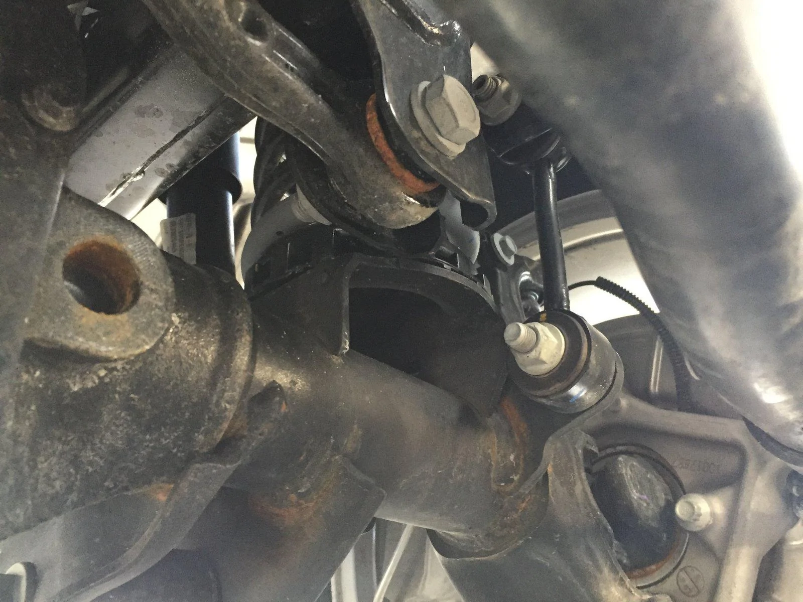

Mine started like this, and now a few months later the body has all kinds of surface rust and pitting all over it and it's scary. Never seen this before and our other cars from different brands don't have this problem. There is something very strange going on here.
