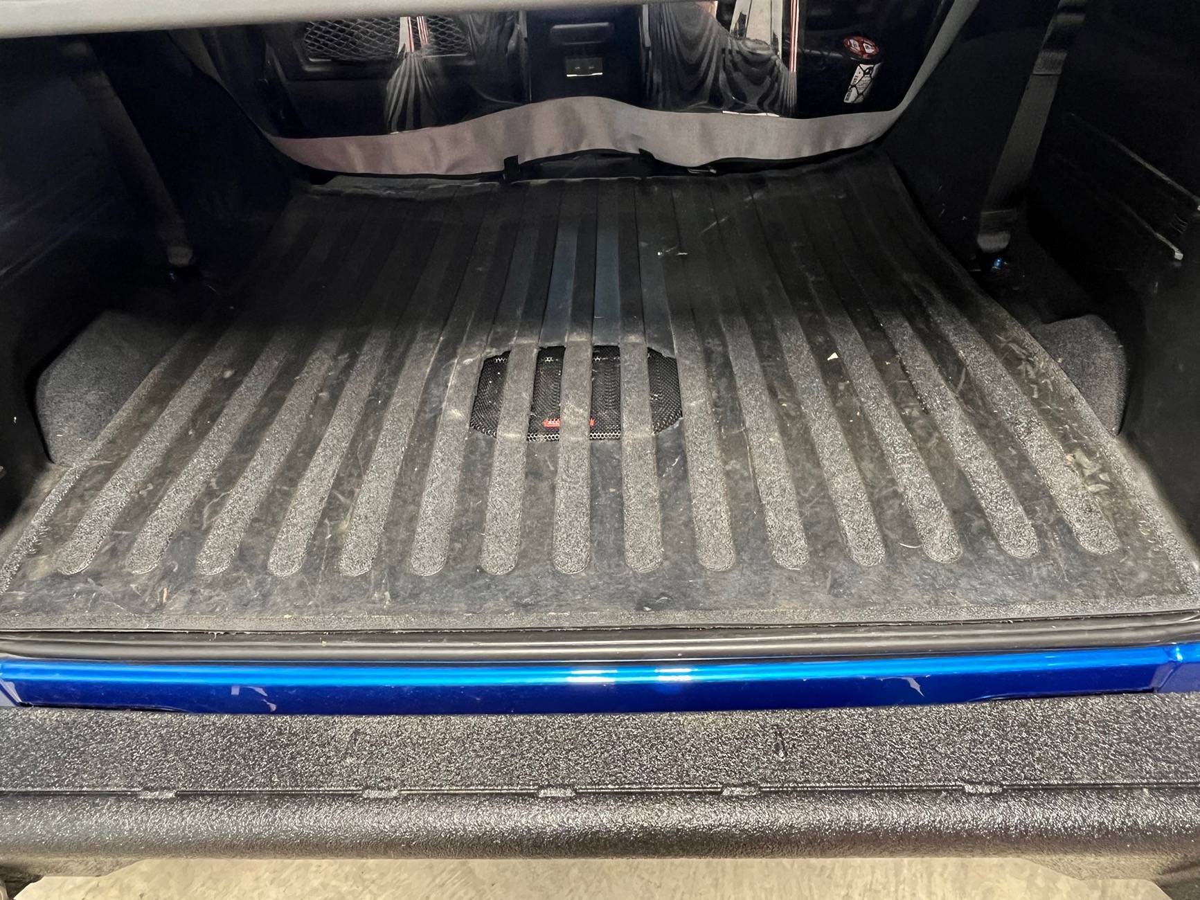

Jeep Wrangler JL Interior Carpet Be-Gone IMG_0112
