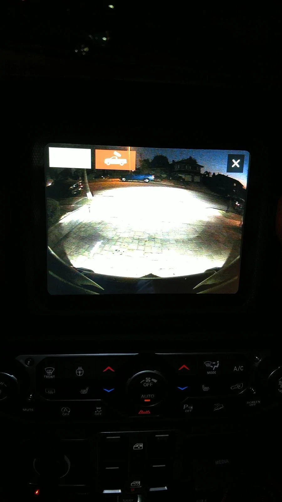

Would love to see how the camera looks on the screen. I was curious about installing one below front bumper and would love to see if higher up makes sense.

Here is it at night. I'll take a day time one later.
So did you use the small red wire that comes out of the yellow video cable or does the camera just have power all the time?

I didn't use the red wire coming from the RCA cable. Only the power and ground for the camera connected to the ignition input on the trailer aux harness at the passenger footwell.
