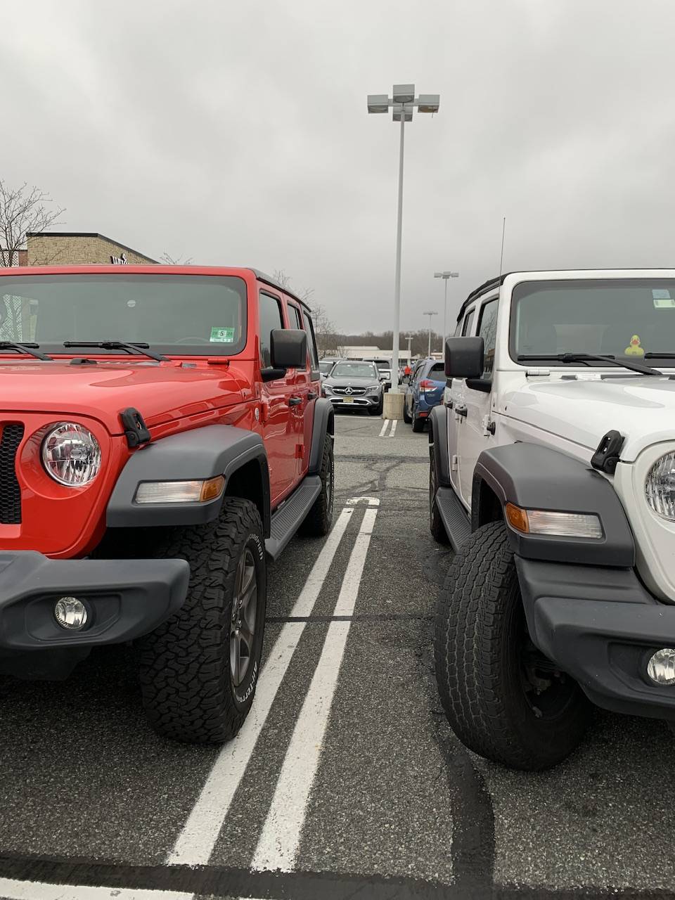

Thanks! My son and I (mostly him) banged it out in a few hours at the shop on a Saturday.
FWIW I found a stock Sport S at the store today. Between the tires (285/70 KO2s) and springs you can see my wife’s is a few inches taller, look at the mirrors.

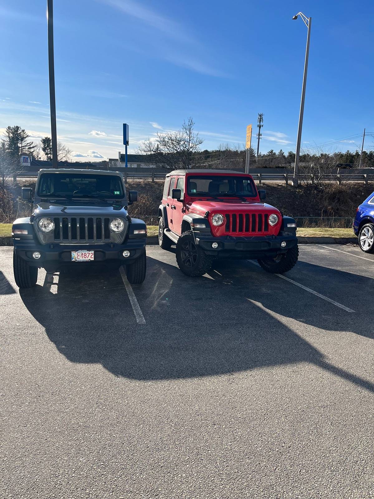

Back a couple years ago, I had a ‘18 JLU sport that I swapped in Rubi takeoff suspension into. No evidence to prove it, but my personal feeling was that the ride improved after the swap. As far as ride height difference, this pic is my 18 with rubicon, and my 20 stock sport.
