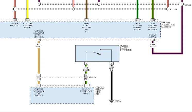

I know they do not recommend for a manual trans, but if anyone is interested I think you can ground the clutch switch with a relay (dark green wire with yellow stripe). Could also be triggered by the power locks. Just be sure it's in neutral!!!
Can you explain this a bit more? I've always had to get compustar for my old manual trans vehicles. All the Amazon reviews say no to the MT.
I've installed remote starts on recent gen manual Volkswagens when they said it couldn't be done. Used a very similar 3x lock with the OEM fob.
I haven't done the JL, but I believe grounding the clutch switch will allow you to do it. On the previous units I've used, there was a 'grounded when locked' output that I used to spoof pressing the clutch. Of course no one on Amazon has tried it, it requires an extra step and if you leave it in gear it could take off on you. I've thought about installing one but I'm happy to be able to do pit stop mode from the factory (leave it running, walk away and lock it with the fob).
