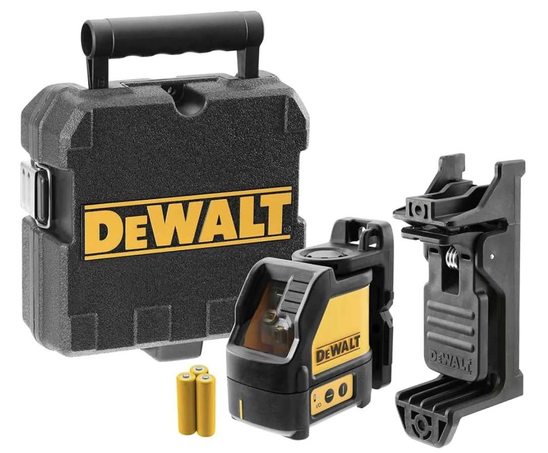

I have one of these laser levels and have tried using it a few times as a straight line on something that isn’t necessarily level.
The first problem I have when doing this is the laser inside is on a gimbal. So I have to rotate the entire thing out of level far enough that it hits one of its limits and the line stops trying to self level.
The second problem I have is that I’m using a regular camera tripod. It’s a fairly good one, but like most, it’s made to pan, tilt, and rotate (a camera) where large adjustments are what you want. It doesn’t have a fine adjustment mechanism to make minuscule changes.
If you figure out something that works please share. It could be a trick up my sleeve for next time.

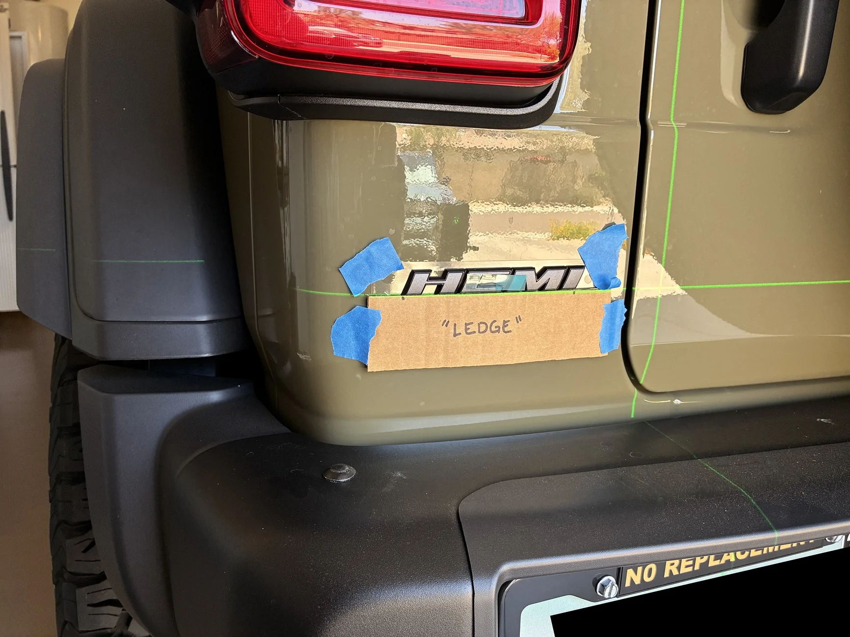

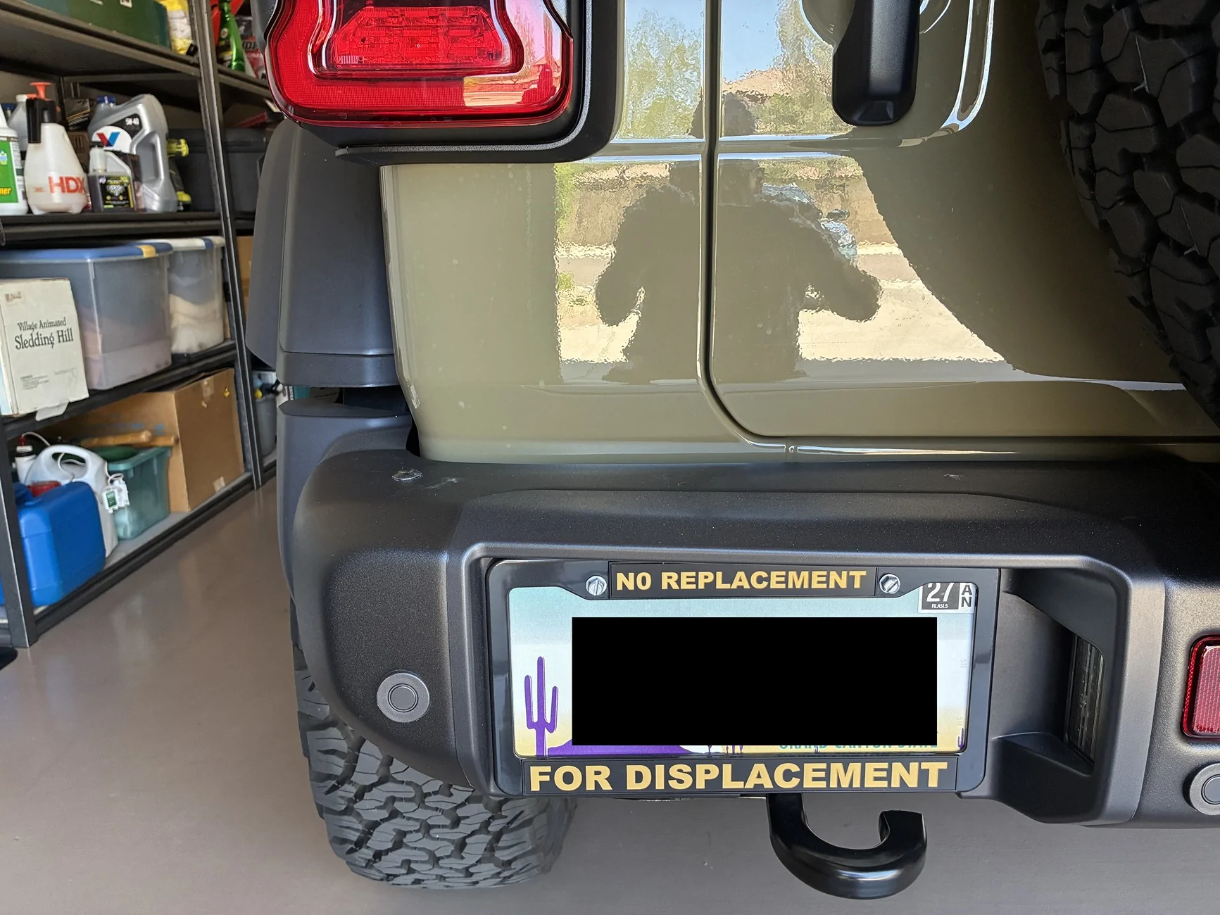

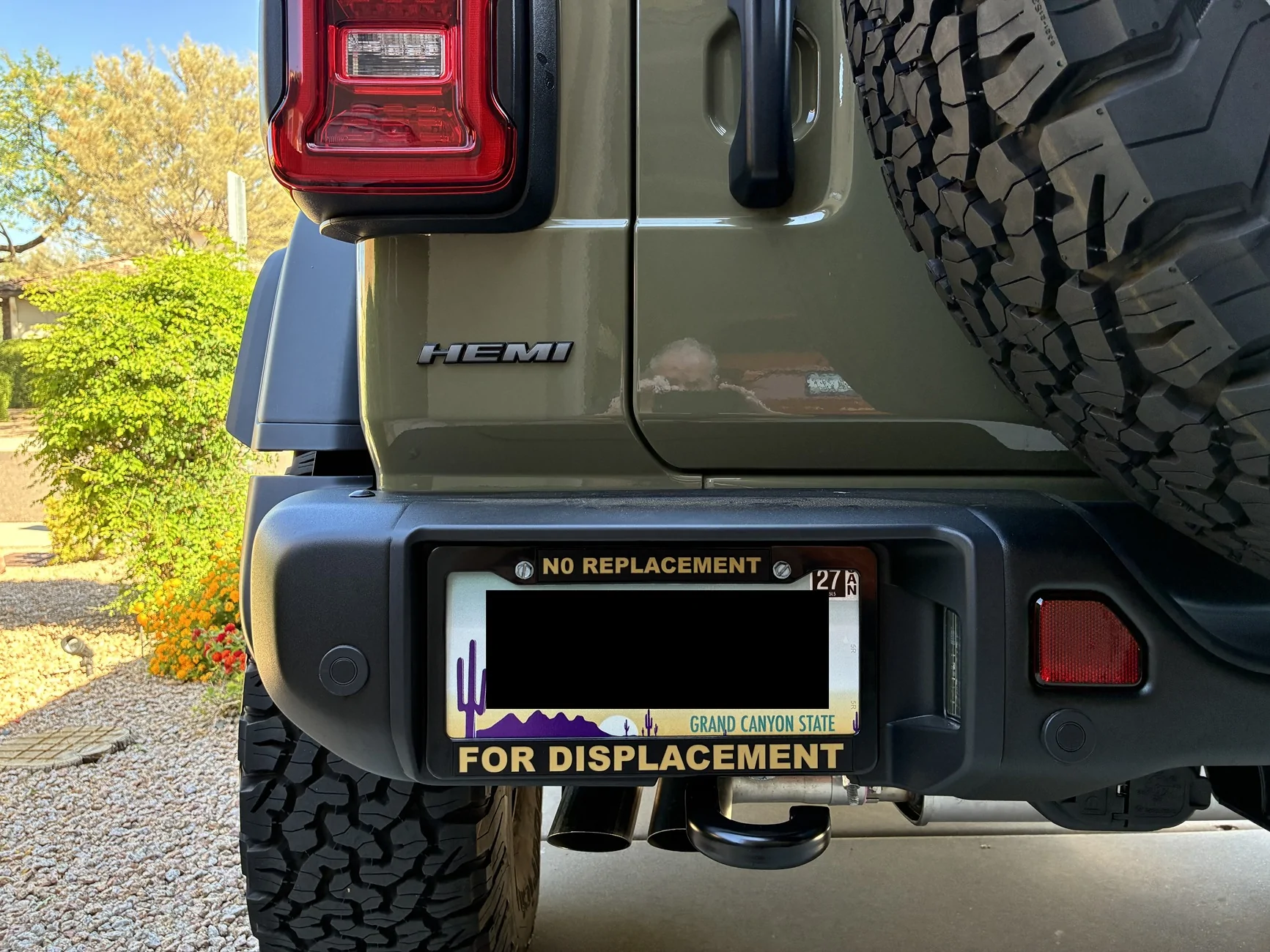

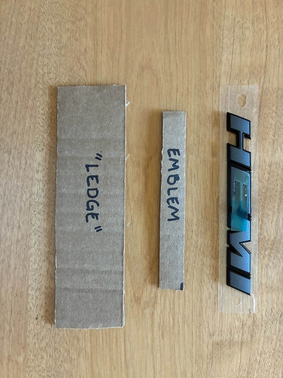

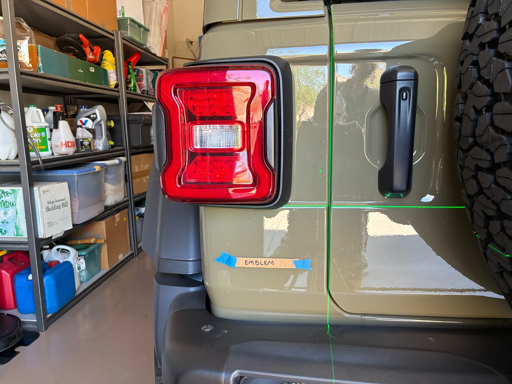

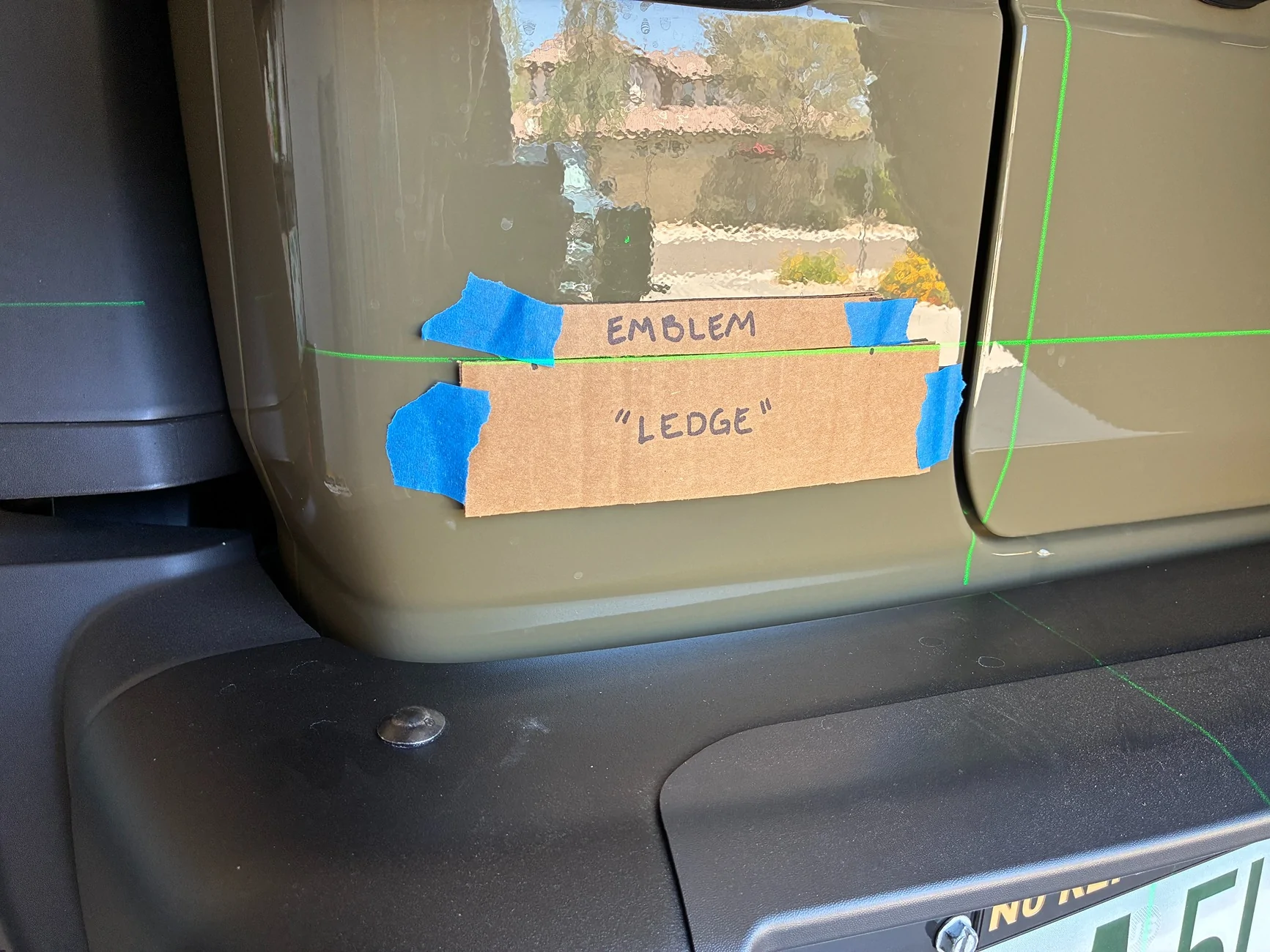

Here is a photolog for your entertainment. Given that it’s 101° with bright sunshine the pictures have a lot of glare. The first one of you wiseasses who says "it looks crooked" gets bitch slapped. :)
My Dad would have called this: "Turning a routine pop fly into a circus catch"
Jeep Wrangler JL Installing emblem with laser level? 1
Jeep Wrangler JL Installing emblem with laser level? 2
Jeep Wrangler JL Installing emblem with laser level? 3
Jeep Wrangler JL Installing emblem with laser level? 4
Jeep Wrangler JL Installing emblem with laser level? 5
Jeep Wrangler JL Installing emblem with laser level? 6EDIT
Jeep Wrangler JL Installing emblem with laser level? 7EDIT

Looks real good to me

Looks good and no scratches from using a framing square 😂

looks good. this is kinda' like what i would do.
i'd typically find some painters tape that is the same width as the distance i want the emblem to be from the nearest seam, lay the tape down parallel to the seam, and align the emblem/sticker referencing that.
