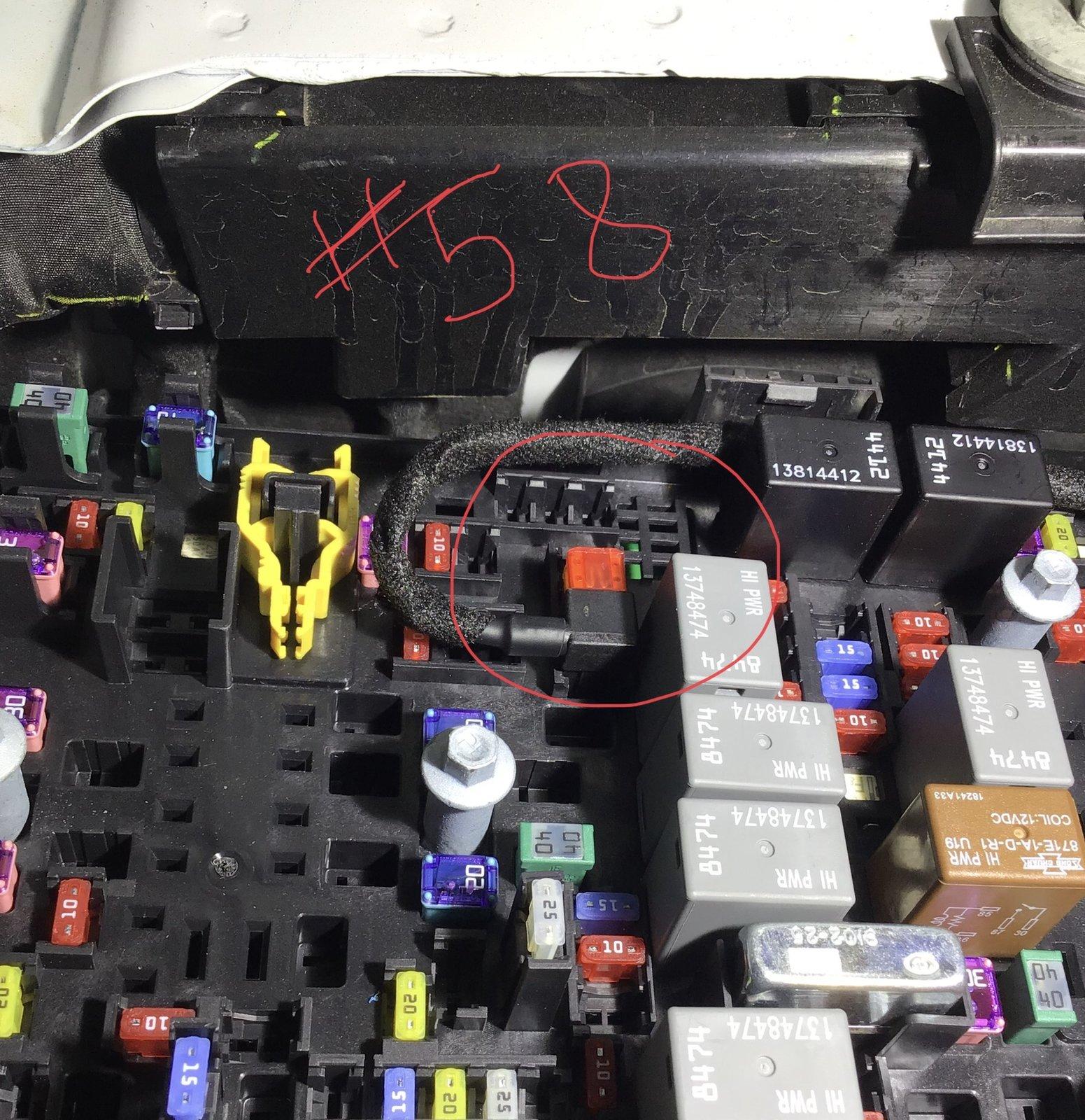

Recently installed a switch power set up in the interior of my JL.
The switched supply will be used to run my dash cam, radar detector, and whatever other interior accessories I install in the future.
There’s a write up with pictures at the bottom. I was an installer many (many) years ago BUT If you have any questions, comments, or suggestions on how I could do this better… PLEASE LMK.

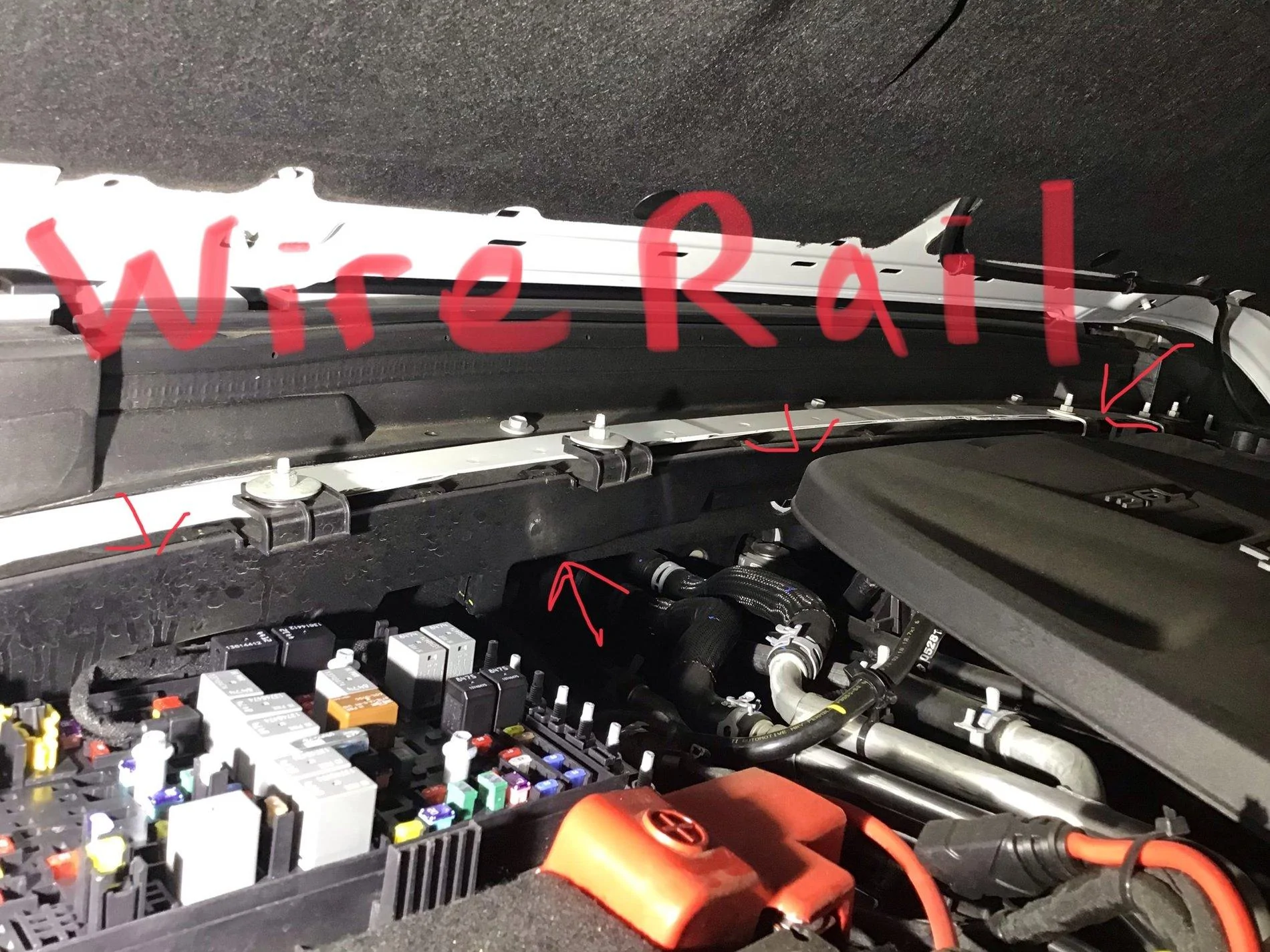

The set up runs from a tap in the fuse box, number 58, down the top of the firewall through the wire rail (?) mounted on top of the firewall, down thru the driver side.

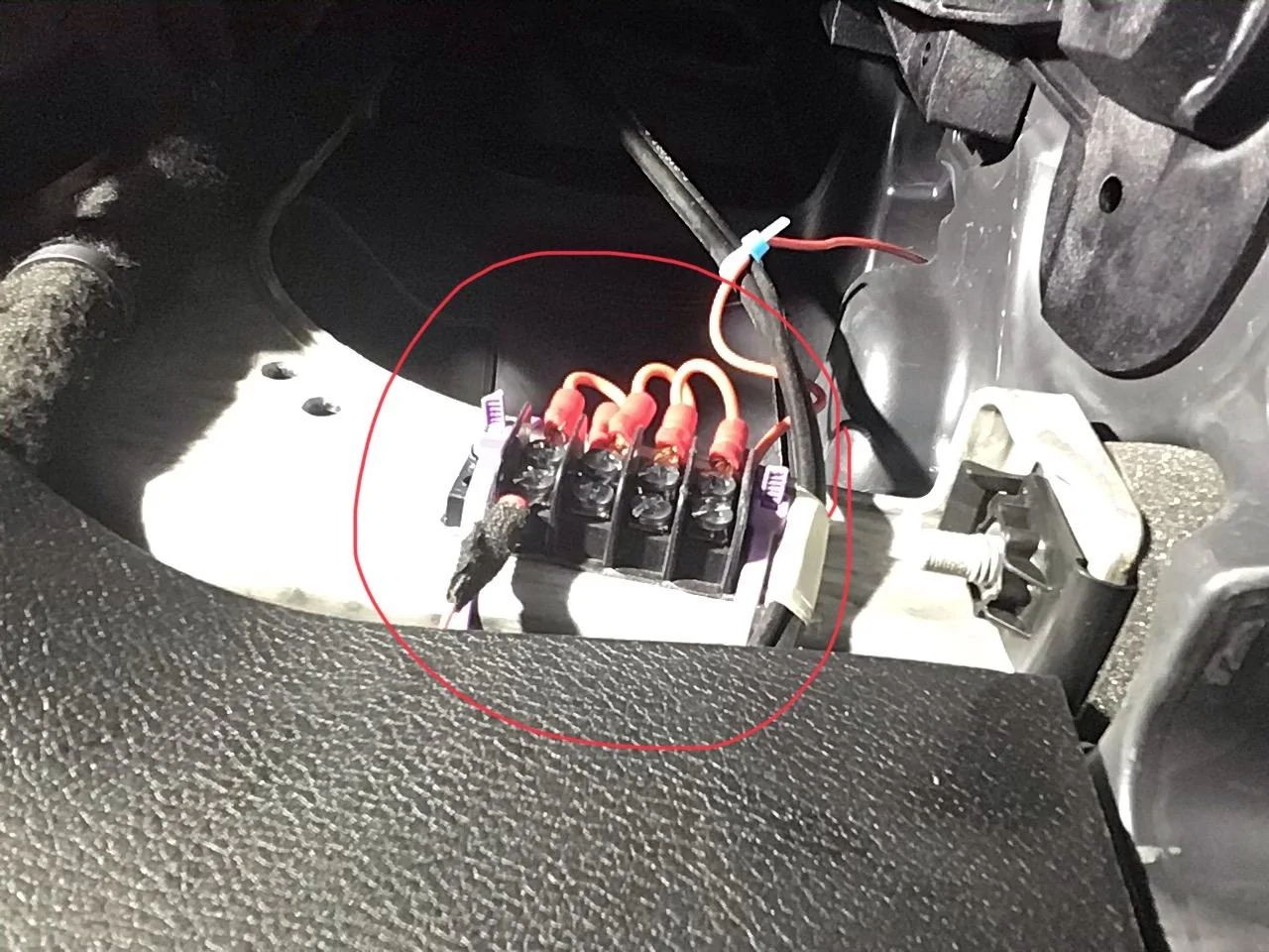

Once on the driver side I connected a 4 terminal strip with homemade jumpers (to power the other terminals) and fastened it to the aluminum sub frame with 3M sticky tape and zip wires just to make sure.
Here is the fuse with the tap, as you can see I covered the wire with loom tape. I think I used 30a fuse thinking ahead. I’ve seen people do this without using fuses but that’s just insane, if you value your jeep, ALWAYS use a fuse!

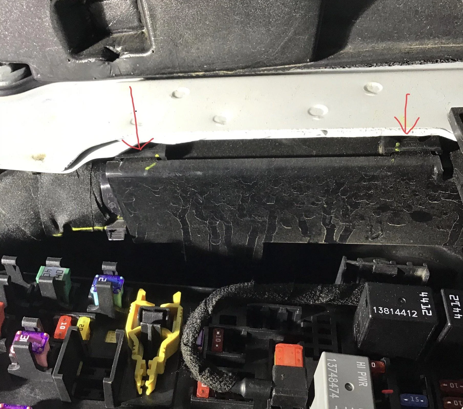

The arrows here show the location of the tabs to open the rail. I believe I had to remove the bolts on top in order to fully access the rail and run the wire through. I tried to fish the wire through the rail using a rod however, it just got jammed up so I decided to open the rail

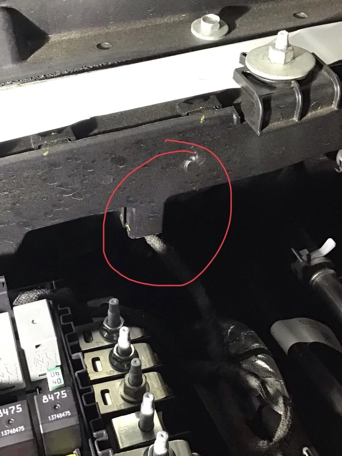

This is where the wire enters the rail, There is an existing wire are there so I just loomed them both together.

Next is just a shot of the entire rail.

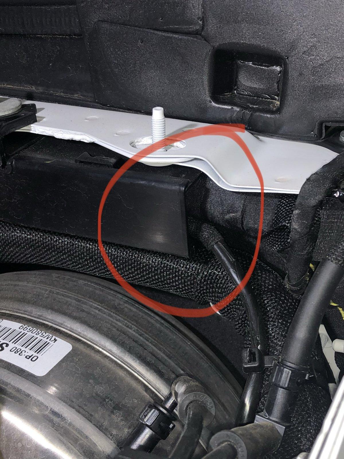

Next shot shows where the wire exits the rail near the master brake cylinder. As soon as the wire exits the rail, I covered it with quarter inch irrigation drip tubing As an extra measure of protection, probably unneeded but…

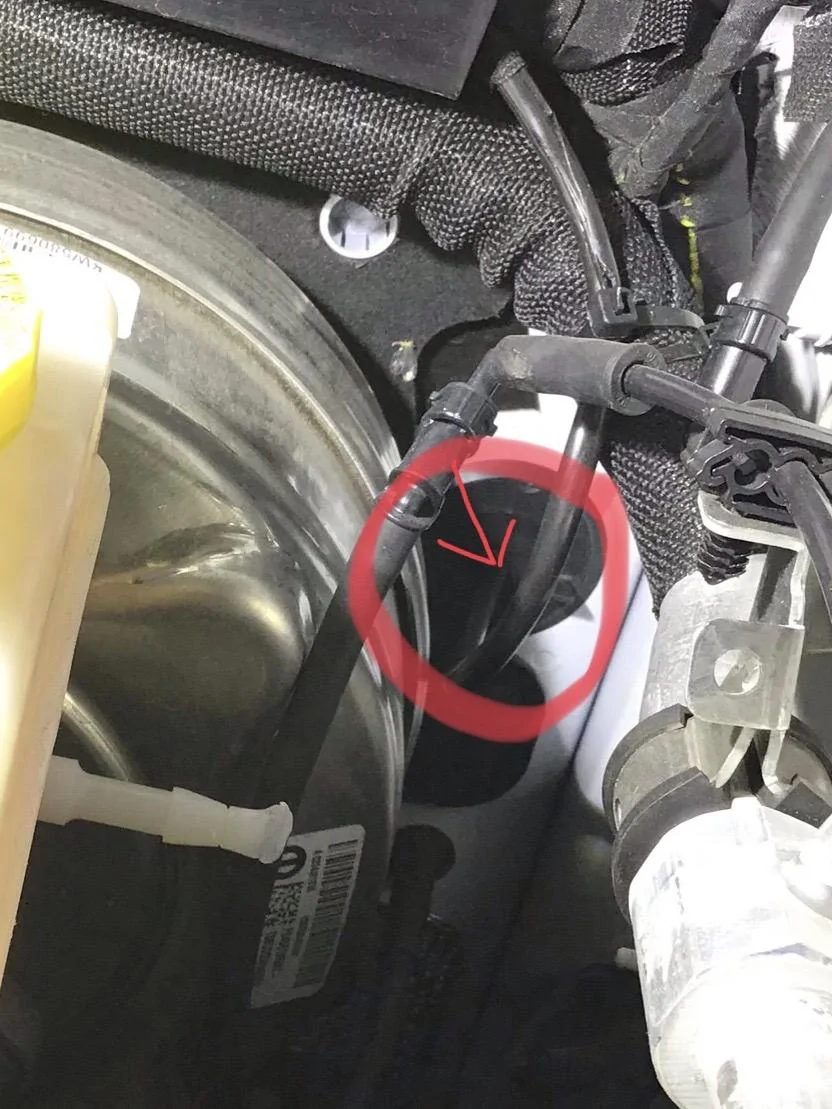

Next to the master cylinder there’s a little black grommet, it’s hard plastic on my JL but I drilled a small hole through it and ran the wire through the firewall and under the dash.

What under the dash, I used a four terminal strip, the strip that I had did not have jumpers so I made my own jumpers as you can see. Now, I have space for three extra accessories, more if I stack them.

I'd say YES, each device Should have a fuse because power still has to get from the strip to the device. That way if something happens between the strip and the device you'd have extra protection from potential device damage and damage to your jeep.

However, I was wanting power on with both engine and ACC modes, so I used the "Cigar Lighter" fuse #F52. It's a 20A micro, so I needed a micro-tap, which I couldn't find at 3 of the local parts stores (they had full-sized and mini). So I ordered a pack of 10 on the Bay for about $10.
