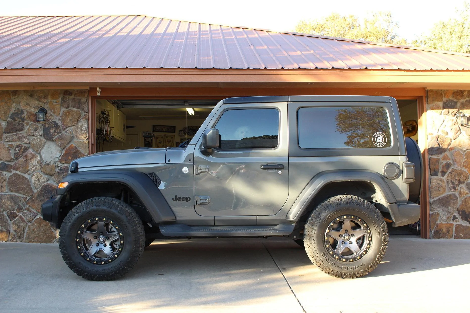

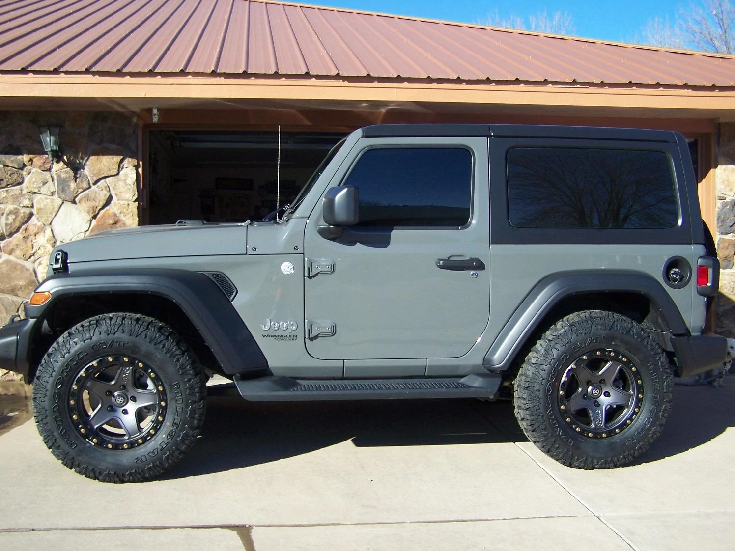

My 295/70/17s (33.3" tall) were a bit tight w/ stock springs, but after the Rubicon swap I could run 35s without issue I'm fairly certain, although w/ the sock high gearing of the Sport axles I don't think I'd run more than a 285/75 (34" tall). With the 295s I don't hit 8th gear except on totally flat hwy running. Also the KO2s and KM3s are completely different tires, so if you want a all around 4x4 tire the KO2s get the nod, but if you want a much more aggressive mud tire the KM3s FTW!
As much as I like the KO2s, those KM3s are just bad to the bone!
Here's before & after
