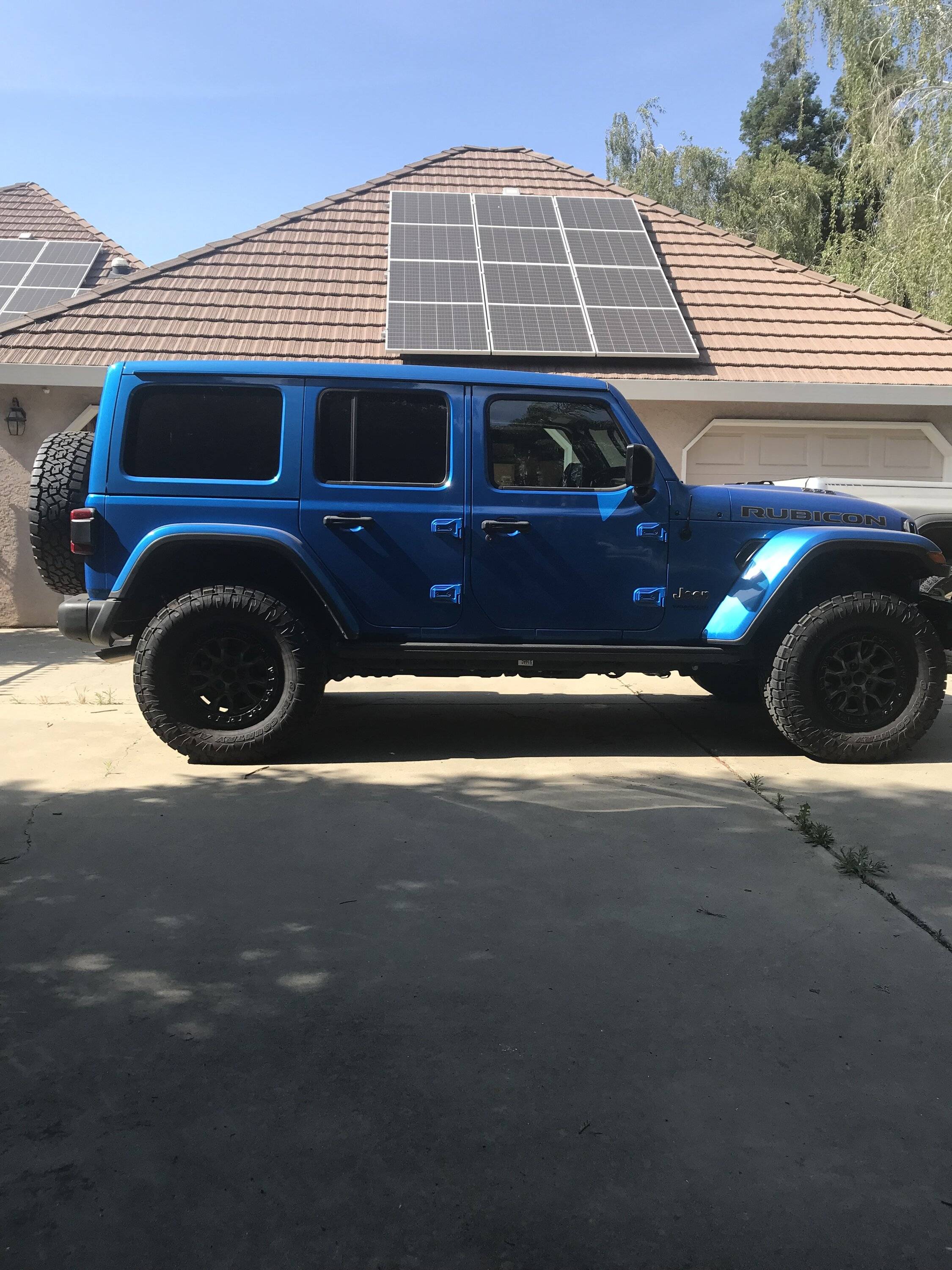

Older guy also fearful of taking out the camera got Toyo AT3 35/12.50/C 59 lbs. The lightest 3peak. Have ordered (back order) forged 8.5” wheels 10 lbs lighter than stock, the combo is 2 lbs lighter than stock. 35’s would not fit with the stock spare carrier so I got featherweight aluminum Teraflex relocation brackets (~$150) Fills the gap well with the stock ~1.5” lift
Jeep Wrangler JL 35"s BFC32DD8-1E8E-461C-963D-940E5F2A60F3
BTW - the Toyo’s are superior wet, not near the rock magnet, and better ride than the KO2’s they replaced but size could be a factor for ride, also 5 lbs lighter than 315/70/C KO2’s

Plus every lb of unsprung weight is worth a good 3 lbs of sprung weight. I don’t intended to use the true beadlock so why have an extra 40 lbs of rotational mass/ unsprung weight. Not to mention the tire shop inconsistency regarding trim rings. But I will keep them in case I change my mind. ?
