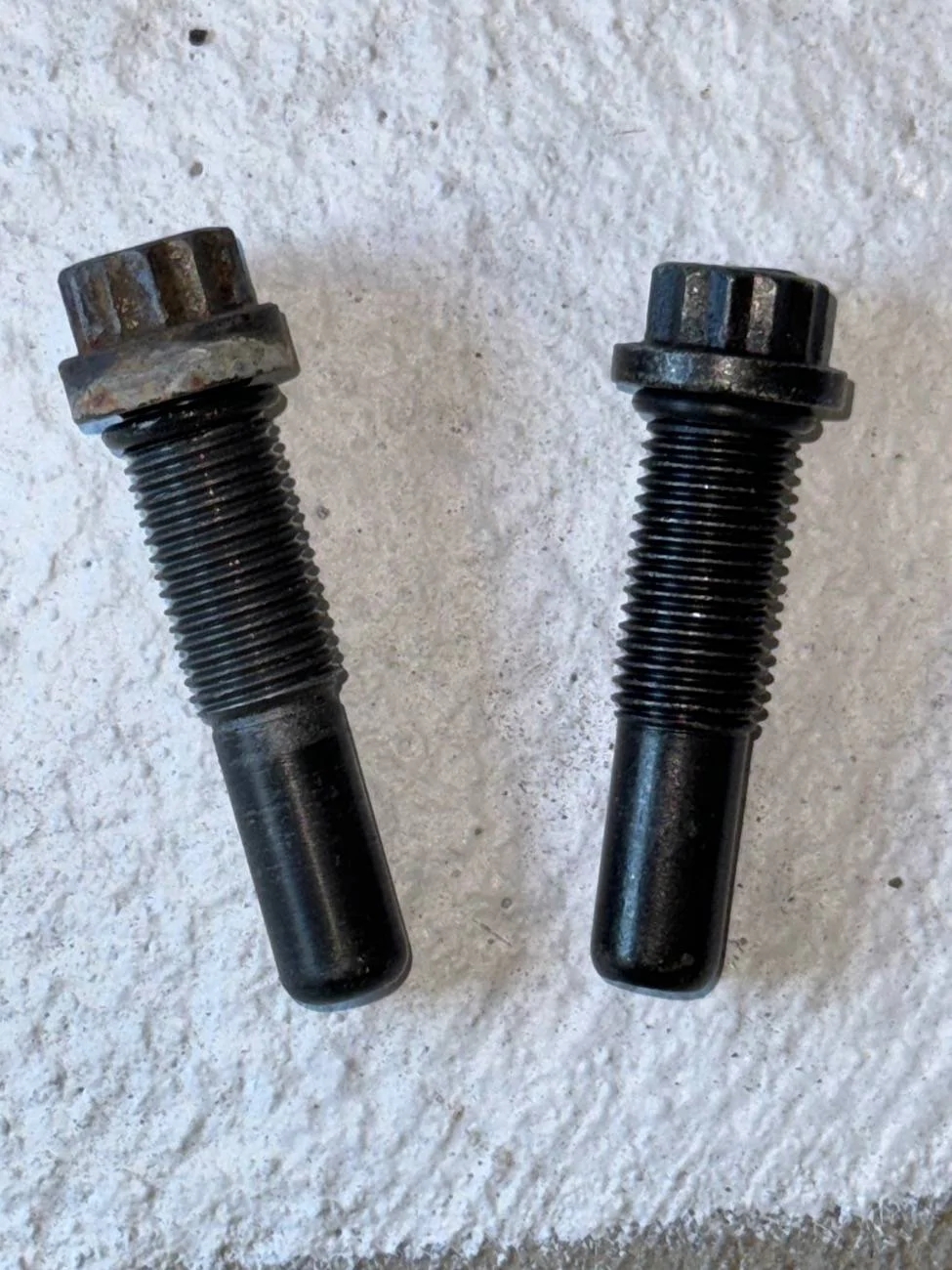

The new bolts are redesigned. More thread, and they sit lower on the wheel. Its been over a week and zero leaks. Very happy with how things turned out. Sending the old bolts back to ICON in case they need to examine them.

I wonder what the purpose/need for the longer threads?

I checked on a wheel before the new tire was mounted. Once torqued to 20 foot pounds, the old bolt stopped short of the final threads on the inside of the hole, and the bolt head stuck out more on the outside.
The new bolt threads stop at the right spot, taking advantage of all the hole threads. The head sits lower on the outside due to the shorter collar on the bolts. So looks like a functionality improvement. ICON is serious about weight, not sure if the bolt shortening was driven by weight.
IMO the new bolts would seem stronger and lighter due to the above details not sure if they’ll mention to the public. Since rotating weight is important, I hope they do.
Forgot to mention, I replaced the o-ring after torquing during the test on the one bolt.
