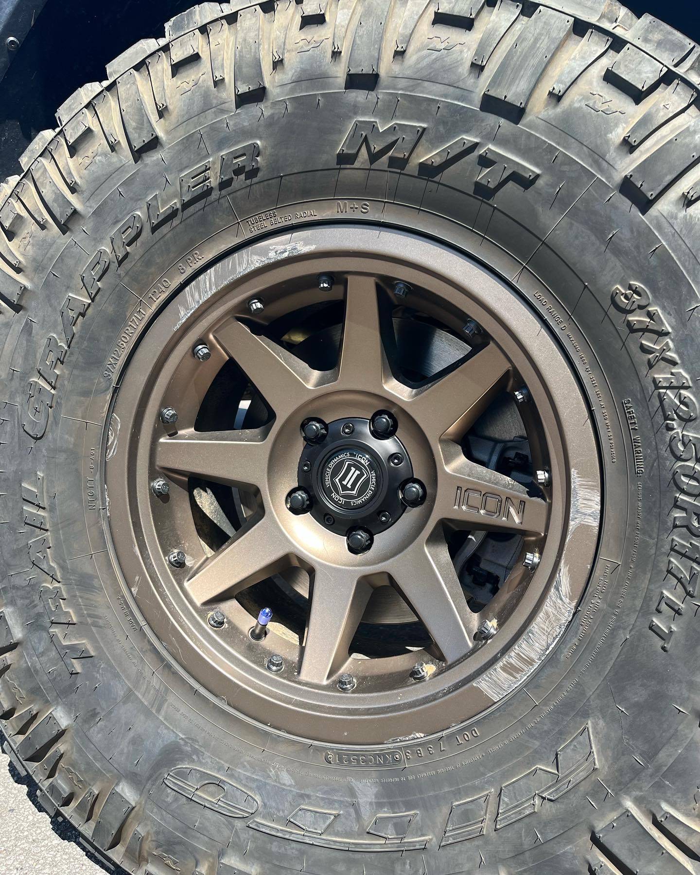

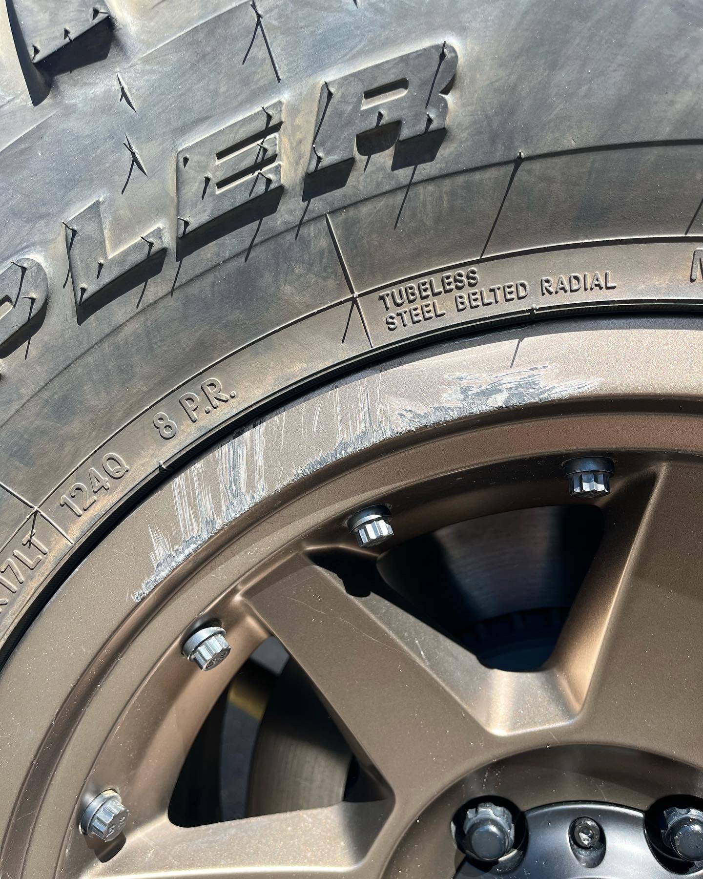

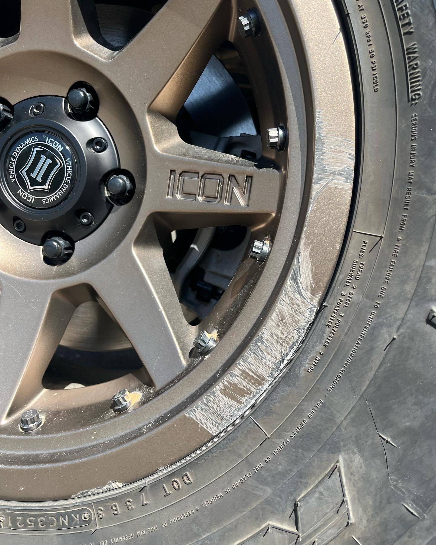

I think they do very well for what they are but for a lot off road use/abuse I think a traditional beadlock is a better choice. These really should have had a sacrificial rock ring. Been on trails 3 times and mine are starting to get beat to shit. If you don’t hit a lot of rock trails then these are a good choice. Been down to 8-9psi each time I’m on the trails and they do great. But if you wheel on challenging trails expect rock rash.

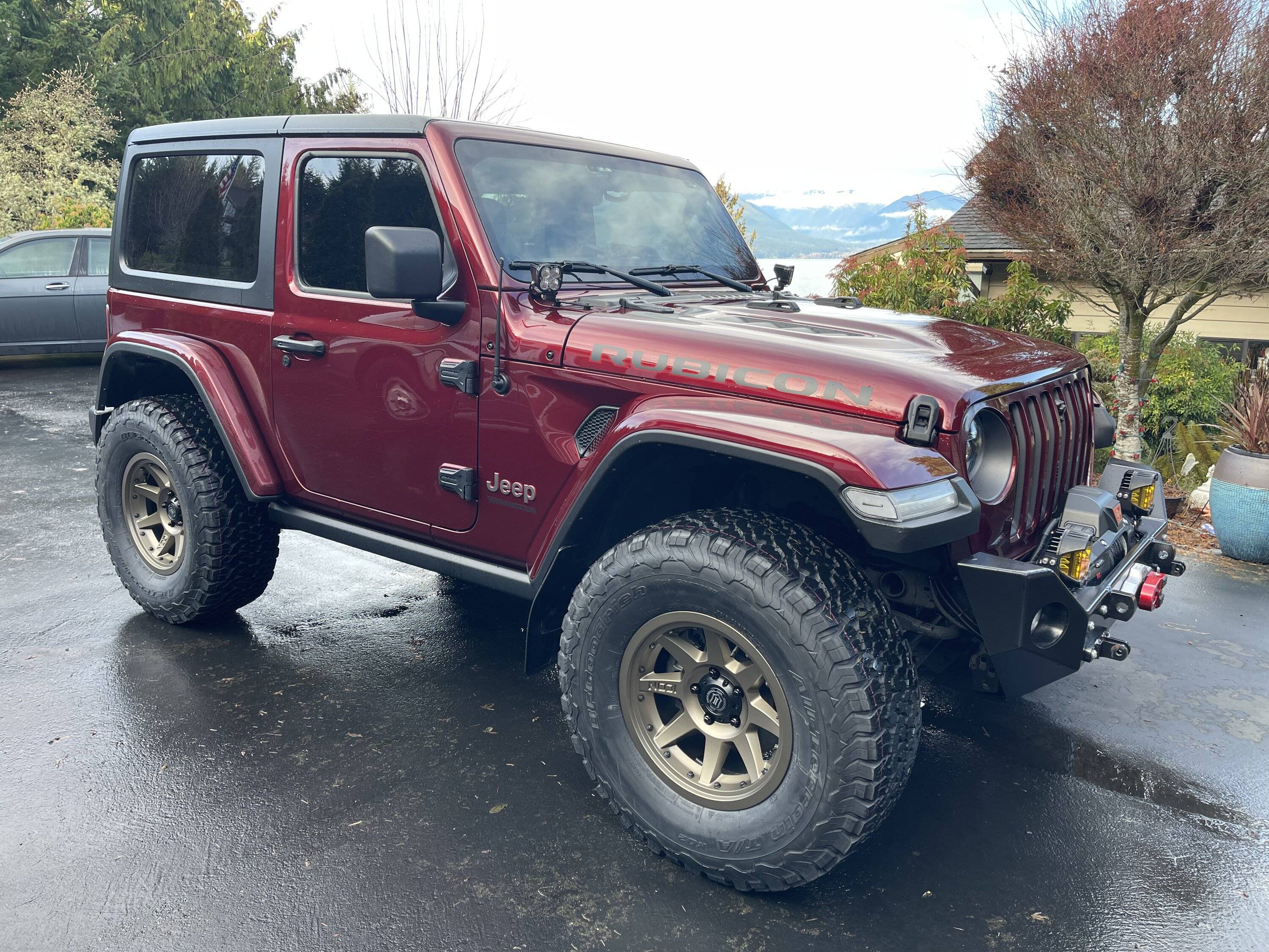

Just got mine installed. Definitely worried about rash. Wondering if there is some way to put a protective ring on them? Gonna do some thinking on that before summer crawling.

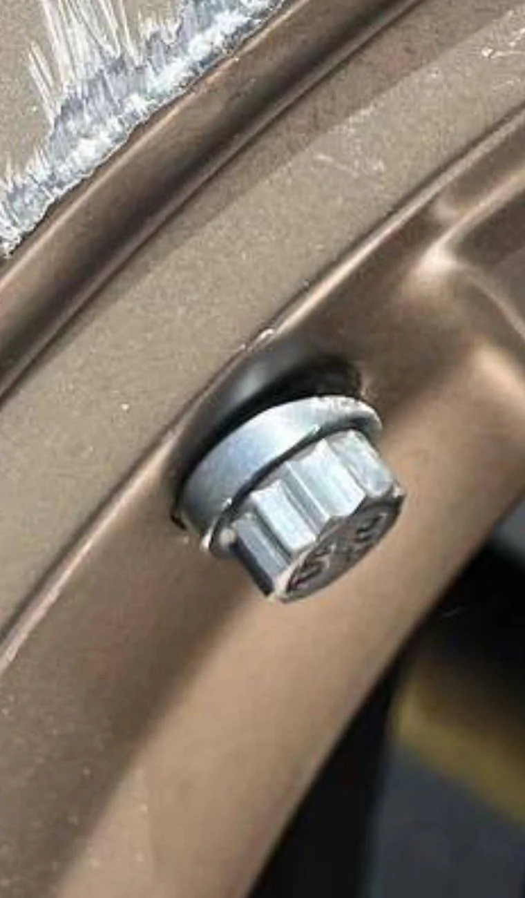

I would be more worried about torquing your bolts properly, to avoid destroying the o-rings. :)
