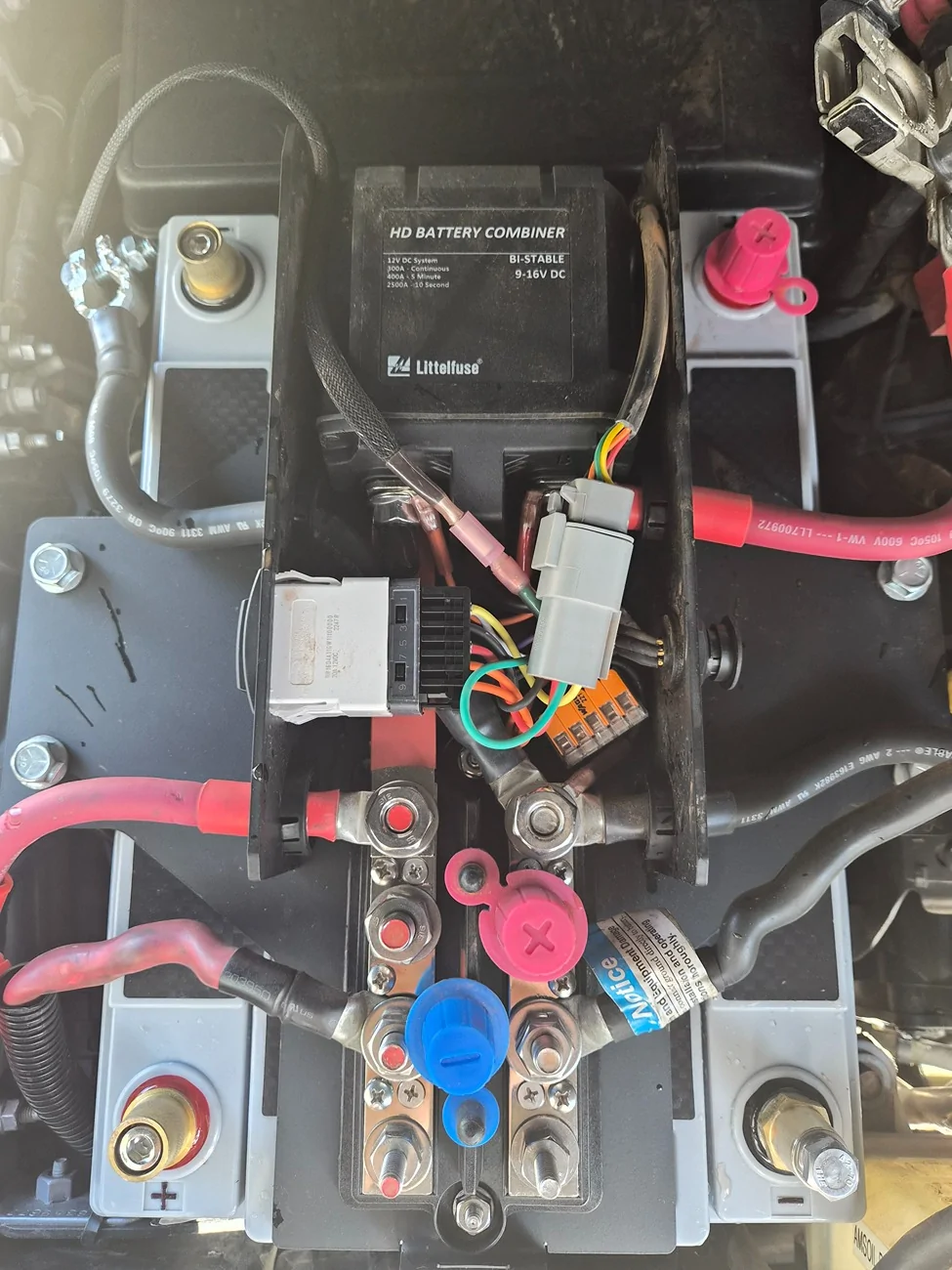

Sorry, I had a Dr's apptmt and now a dinner. But, it appears that the negative side of both batteries are hard tied by a buss bar in the Genesis.
Thanks for the picture. Right, the negatives are permanently tied together, and the positive connection is broken after shutdown.
But, as I understand it, the Genesis wiring connects to the factory negative clamp on the top side of the IBS, so the IBS shunt registers current only for the front/auxiliary battery where the IBS is attached.
I think your issue might be that when the Jeep starts and the batteries are combined, the IBS sees a fully charged battery (i.e. one that accepts very little current at alternator voltage). The IBS sees a charged battery because it's attached to the front/auxiliary battery that was disconnected while the Jeep was off, so wasn't discharged by the fridge. Then, the Jeep sets lower alternator voltage, and the rear/Jeep battery (that would/does accept current, since it was discharged by the fridge) doesn't get proper charging voltage to fully recharge.
Moving the fridge to the front/auxiliary battery or moving the IBS to the rear/Jeep battery would ensure the IBS tracks charging for the (typically) more discharged battery, so the Jeep should maintain high enough charging voltage for the fridge battery to recharge.
