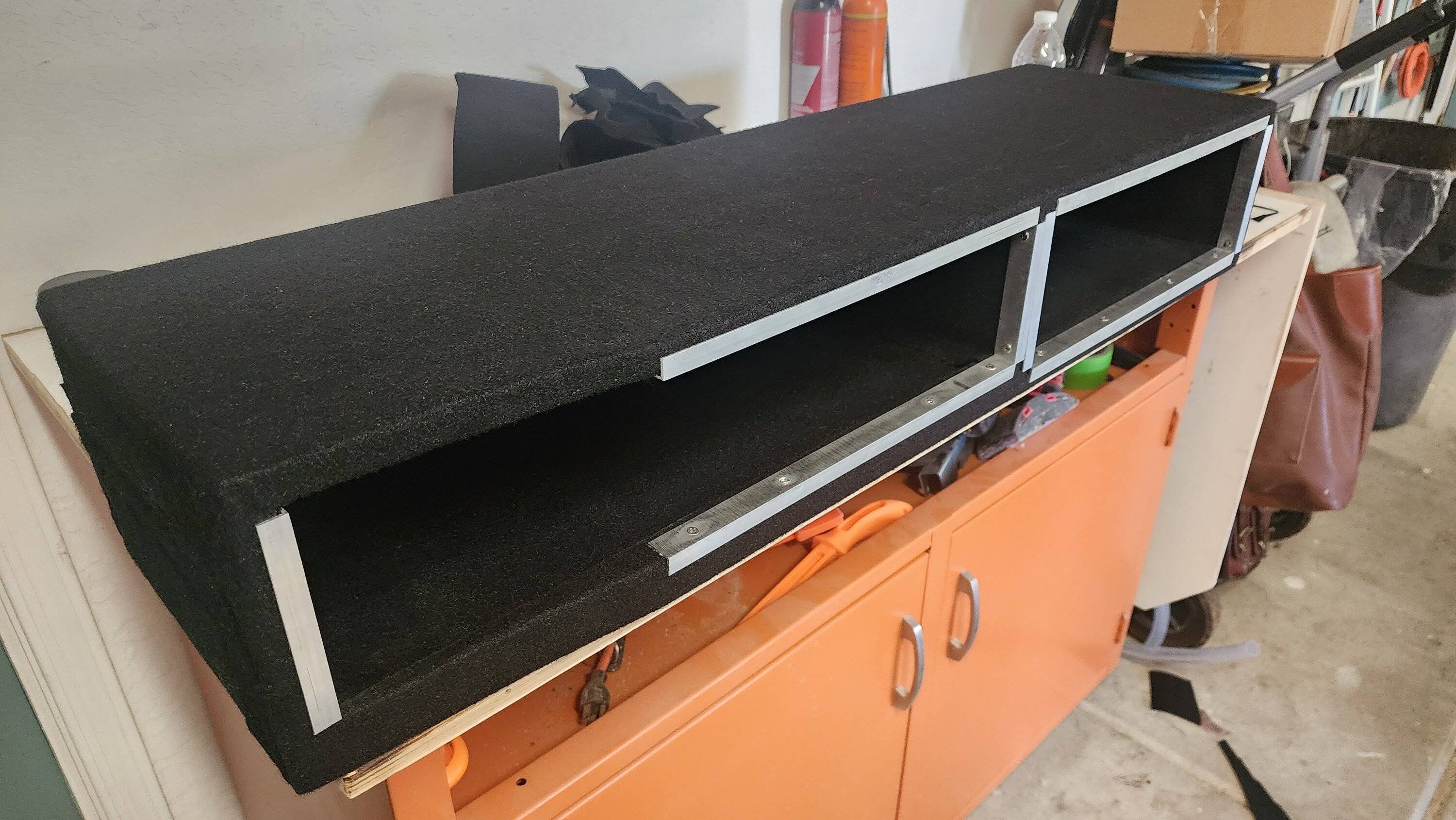

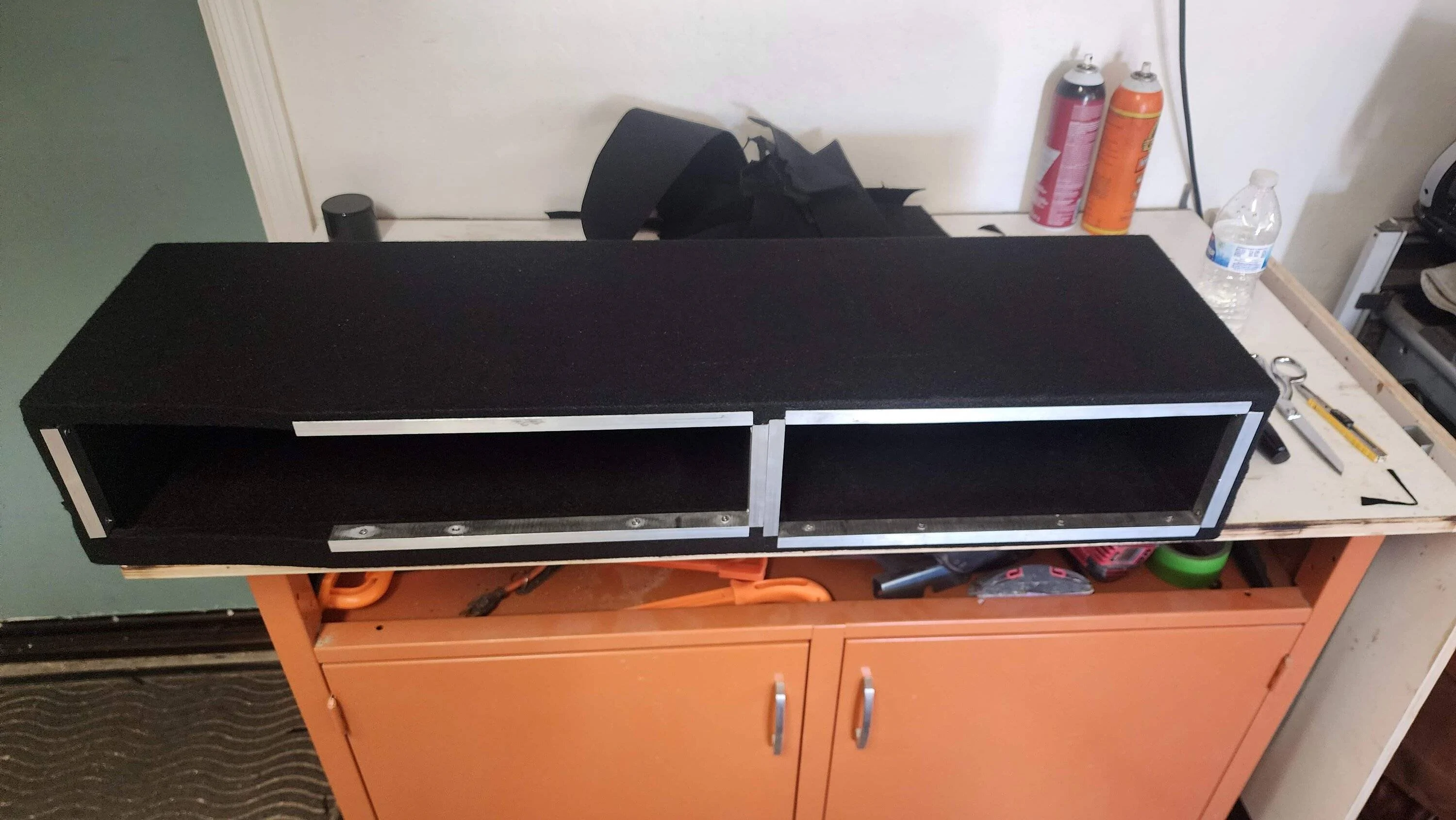

Hello! I'm new to the forum and purchased a JL last year. I go wheeling often and like to always have tools/gear on-board. My last Jeep was a JKUR and I built a full platform box with a drawer to keep tools and parts. I found it much more difficult to find space on the 2 dr JL with the rear seat installed. I was hoping to build another drawer, but the added layers of a box and drawer didn't leave enough room for tools. Anyway, here's what I came up with:

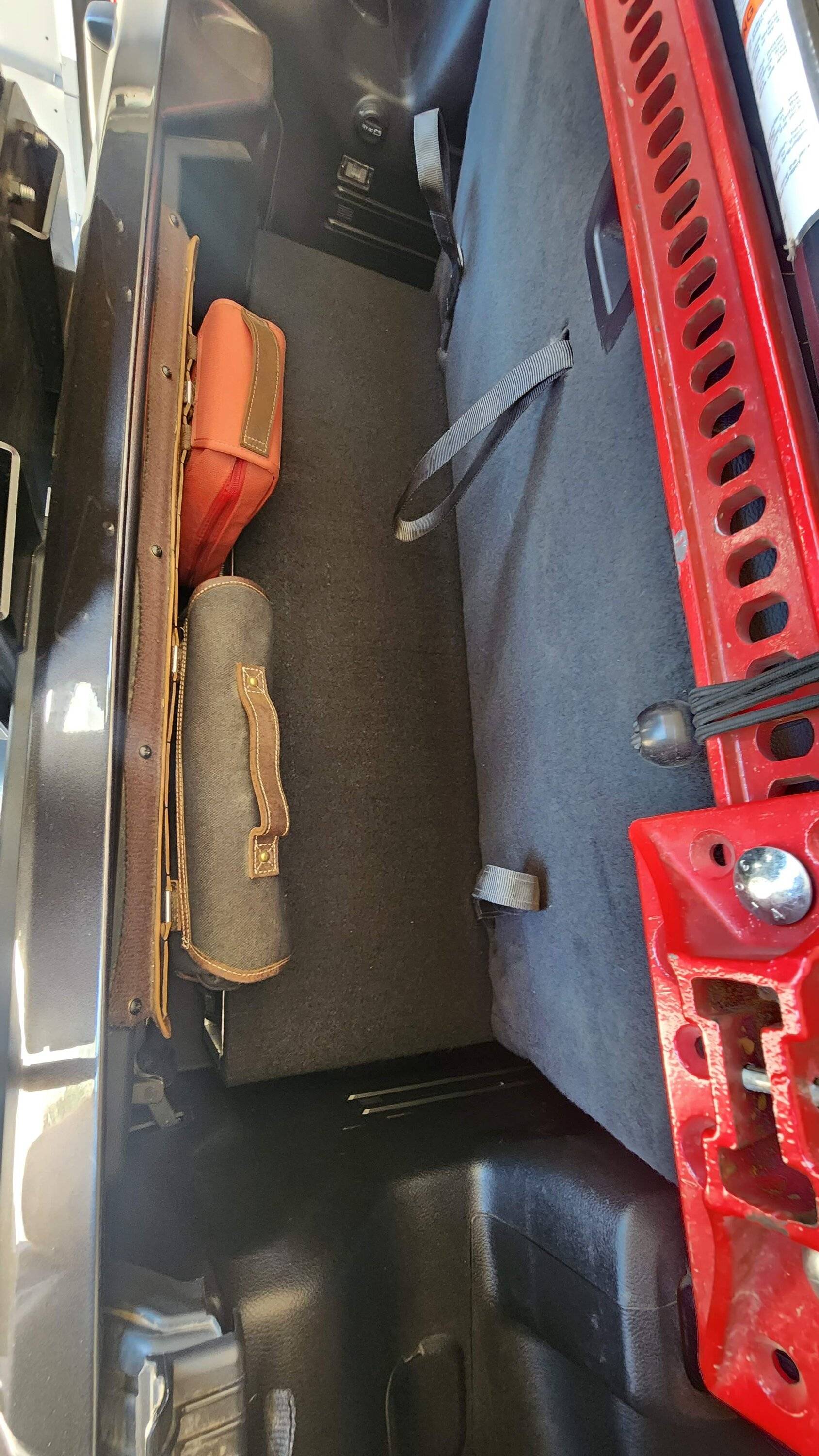

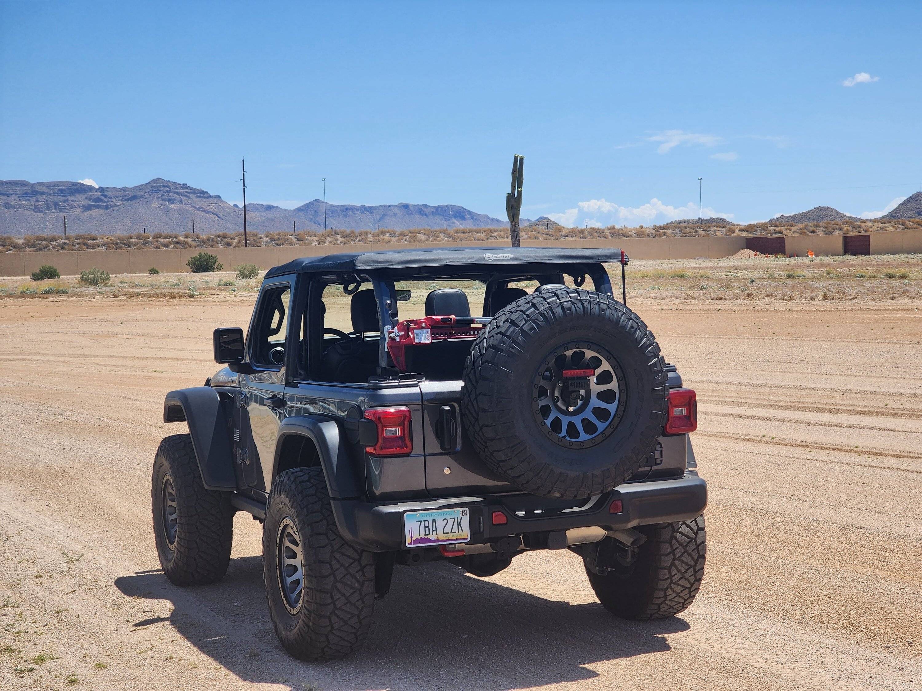

Very cool! Now, how are you mounting that farm jack? :)
I had leftover hi-lift rollbar mounts from my JK. I found they didn't fit over the JL roll bars, but I still liked the idea of using them, so I installed nutserts in the roll bar to bolt on the mounts. One of these days, I'll powder coat the mounts black or grey.

well done sir. did you bother to write down the dimensions so if I want to build a similar box you can save me a step?

The dimensions for the box are 39x11x6.5 (L"xW"xH"). You should match the length, but the width and height will vary. I have bags on the door that I had to factor in for the width and I made the box as short as possible since I want to utilize the little bit of cargo space on top of it. Good luck with the project!

@Jeepin_OLB what did you use to cover the box? Is it a felt or carpet? Would love to find a place to buy a small roll of carpet to match the interior carpet.
I used polymat, which is a fiber backed felt. It's high quality stuff and holds up well to use. You can get it from their website or Amazon.
