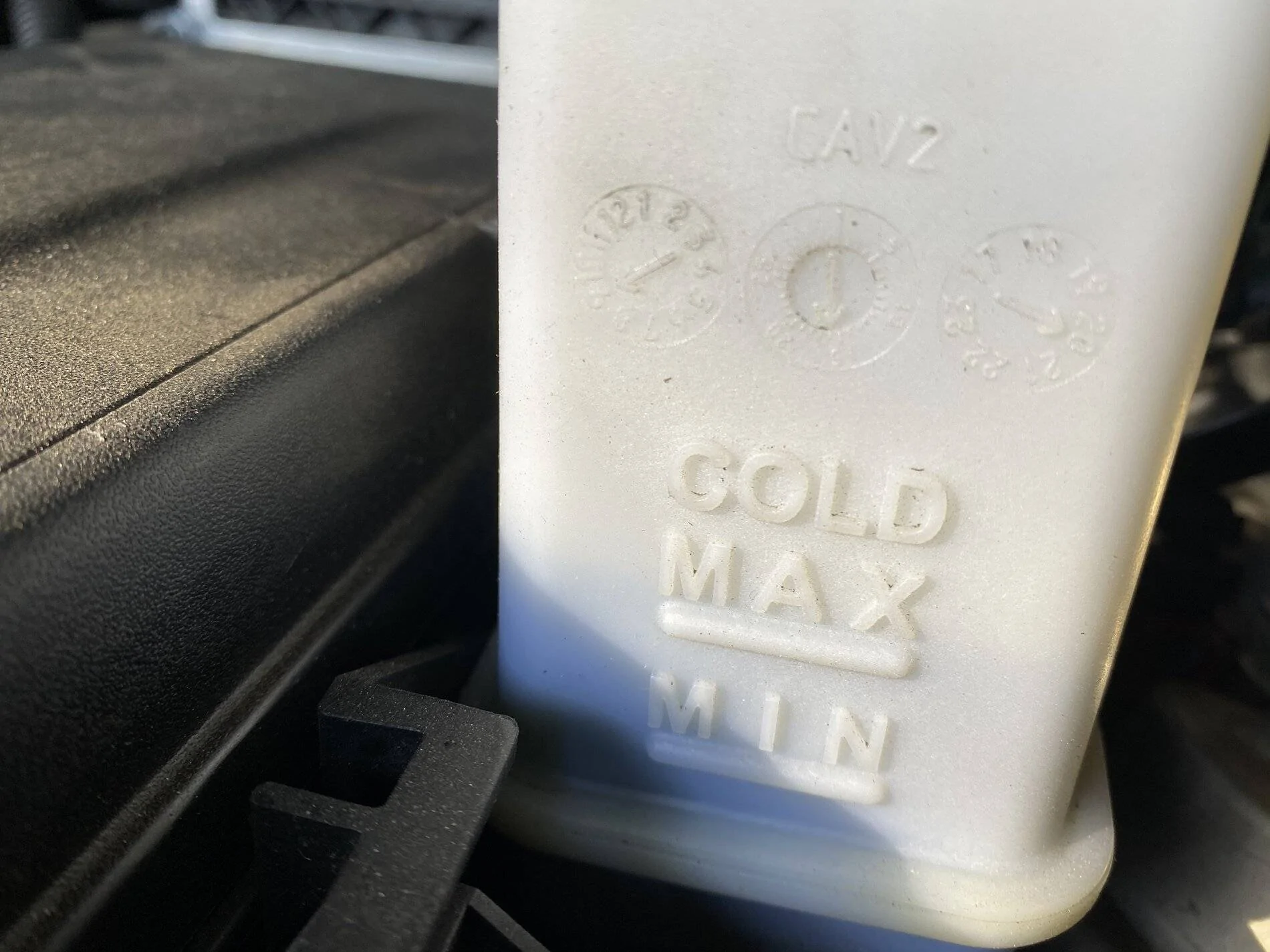

Yes , stock pump in the 3.0 diesel . 6-10 psi in my 40” tires on heavy Dana 60 /14 bolt Axles . Zero issues turning locked arbs . The best part is I still have pump speed control . Easy turning in the parking lot without and firms up on the highway.

11.00 for the tap I used on my JK and Toyota . I’ve had that since 1998 so I didn’t factor that . The pentosin 11S was 50.00 for 5 liters , 2 were added in the swap . My level stays dead on max when cold and rises maybe 3/4 after hours of rubicon trail .

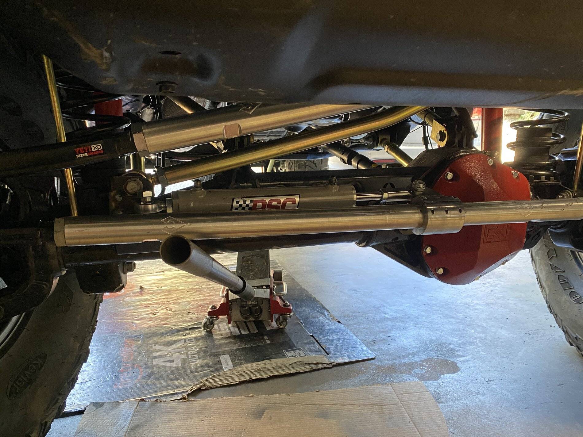

I just had PSC Adventure series installed on my 2020 JT Rubicon. It is the one without the hydro assist but is hydro assist capable down the road. I have no issues with dead spots whats so ever. Drives better than stalk. Occasionally when cold the steering might be a little choppy at 5mph or slower. So far my biggest gripe is as soon as I touch full lock while turning or reversing into a parking spot I get a loud whine. I noticed this same whine when turning at full lock into a U turn. My guy who installed installed it says it’s completely normal, so I’ll just have to get used to it. Kinda sux cause we spend 60k on a vehicle and 3k on this upgrade just to have a bothersome noise. But hey it is supposed to perform so I am very happy with it overall and I just hope it stands the test of time
