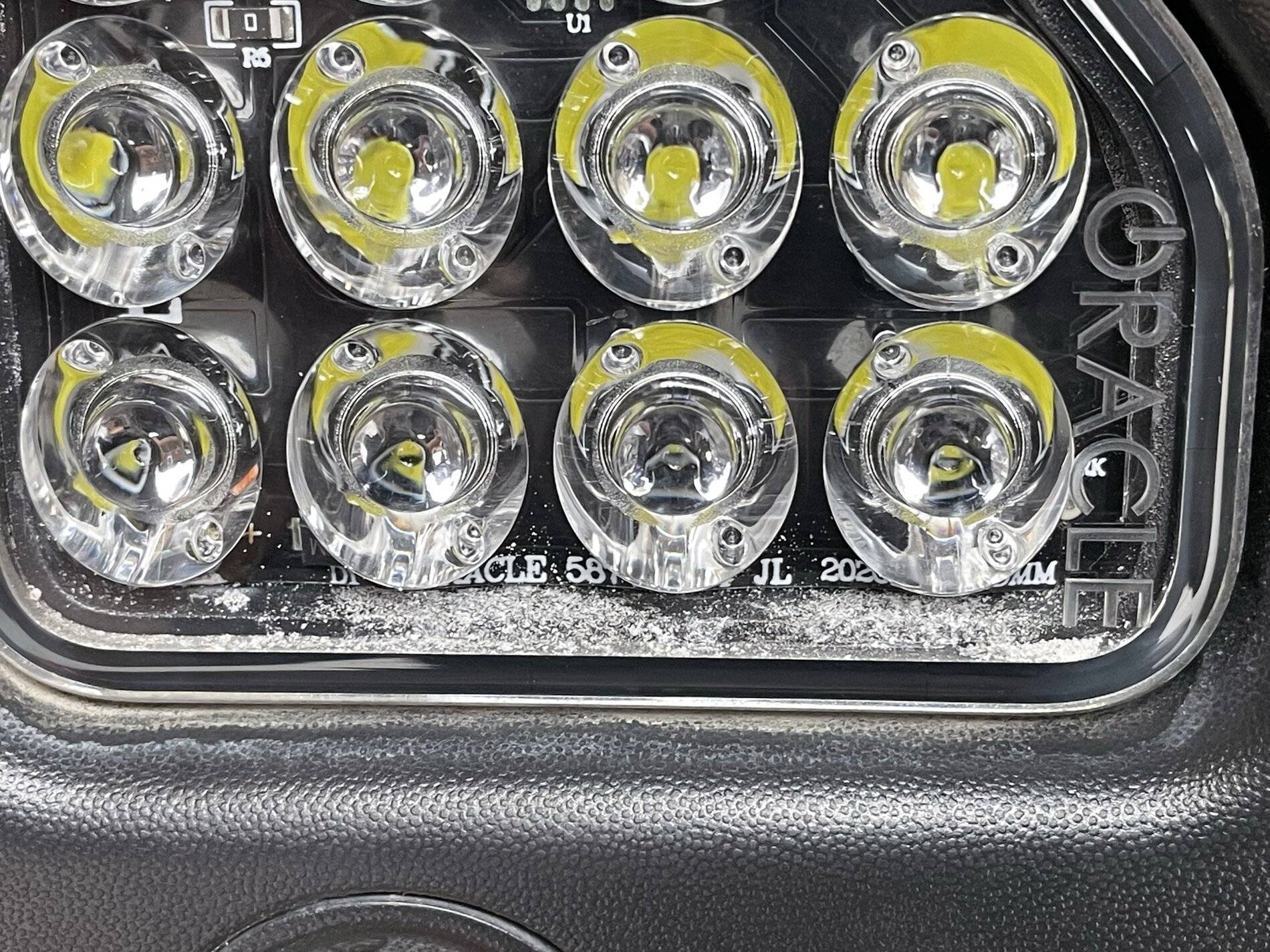

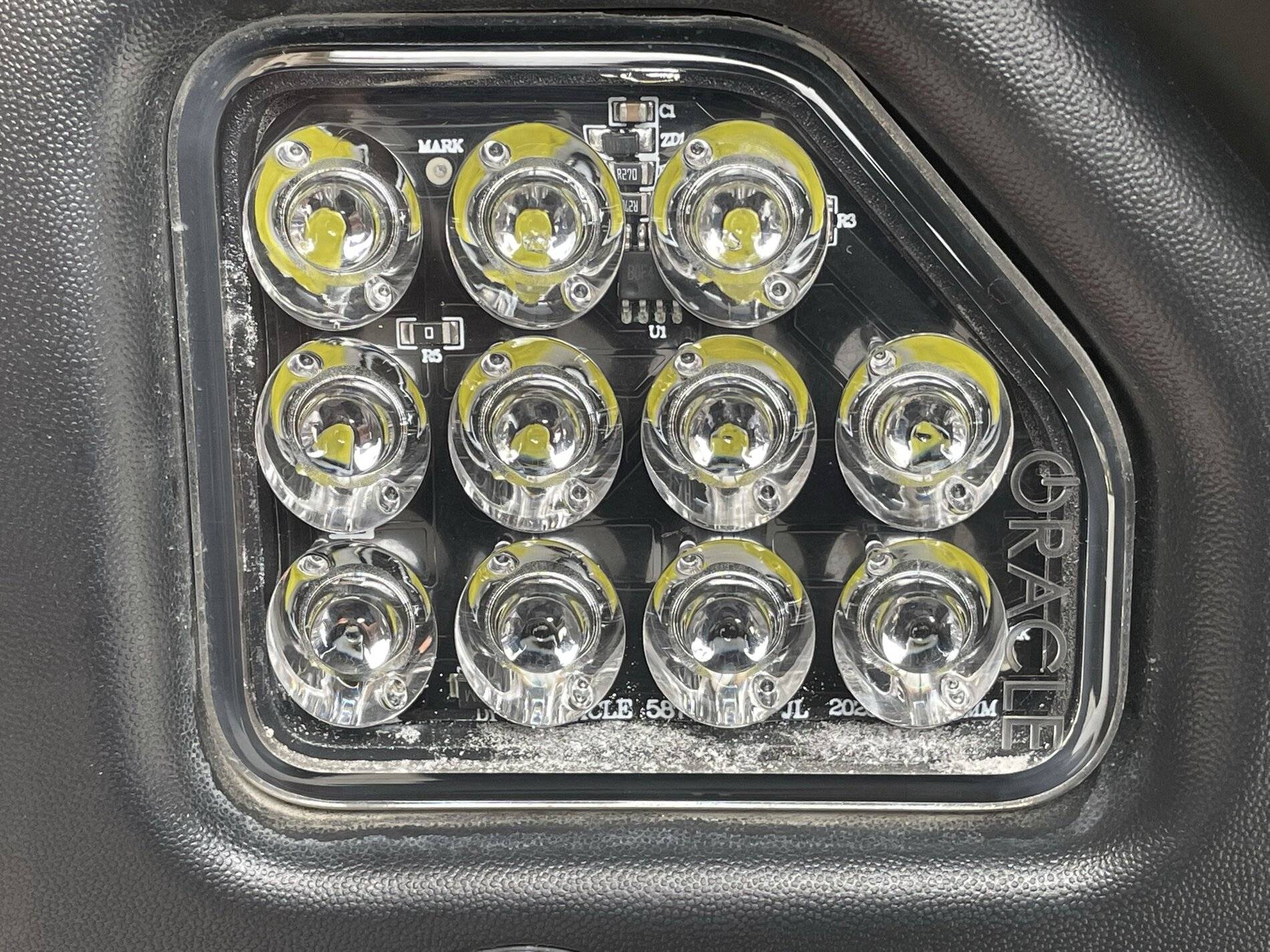

I determined that my left Oracle back-up light is fried. They’re still in warranty so they should replace it for no charge. I sent them a claim form and pictures today. Hopefully they’ll do the right thing. They both worked great for ten months and they’ve never been wet, leaked water or formed any condensation.

Expect to be paying that company a tad under $10 for shipping of your replacement of that problematic light to you.. Not right but that is what you will find. They should ship the replacement to you for free.... but no, no they will not.
