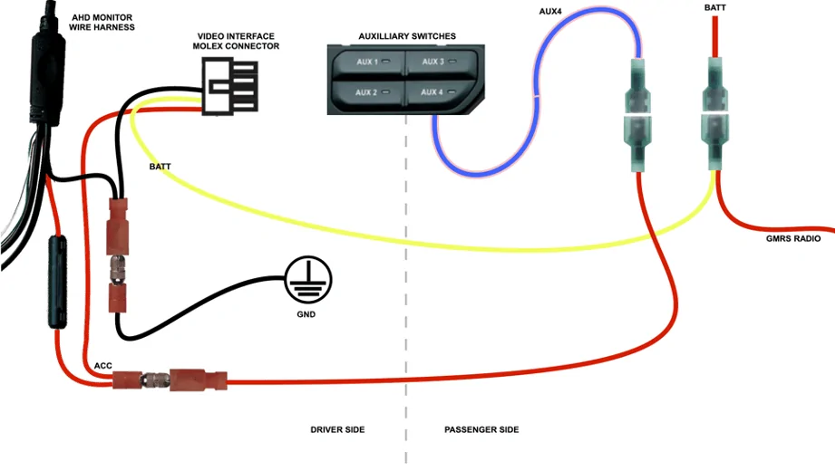

@RubiDukkie I was going over the PDF you made for installing the cameras. I noticed that you tapped into the aux 4 switch. Are you actually using the switch? I know there is also a fused battery and ignition wire in that same bundle and trying to figure out if those would work as well.

I'm using both the AUX and the BATTERY. I use the AUX4 to turn on/off the camera system & monitor. The battery wire just provides a trickle of power to retain the the video interface configuration settings (yellow wire), otherwise it would reset to the defaults every time you power off the camera system. I have my Midland GMRS radio pigtailed into the battery power as well, hence the reference in the diagram.

That makes sense. Thanks!

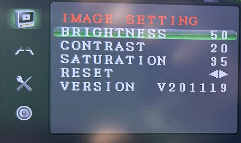

Curious what video settings you have been using for the Echomaster AHD monitor. So far I have found the following work best for me:

Right now it is....
Brightness: 30
Contrast: 65
Saturation: 67
But I am still playing with it.
