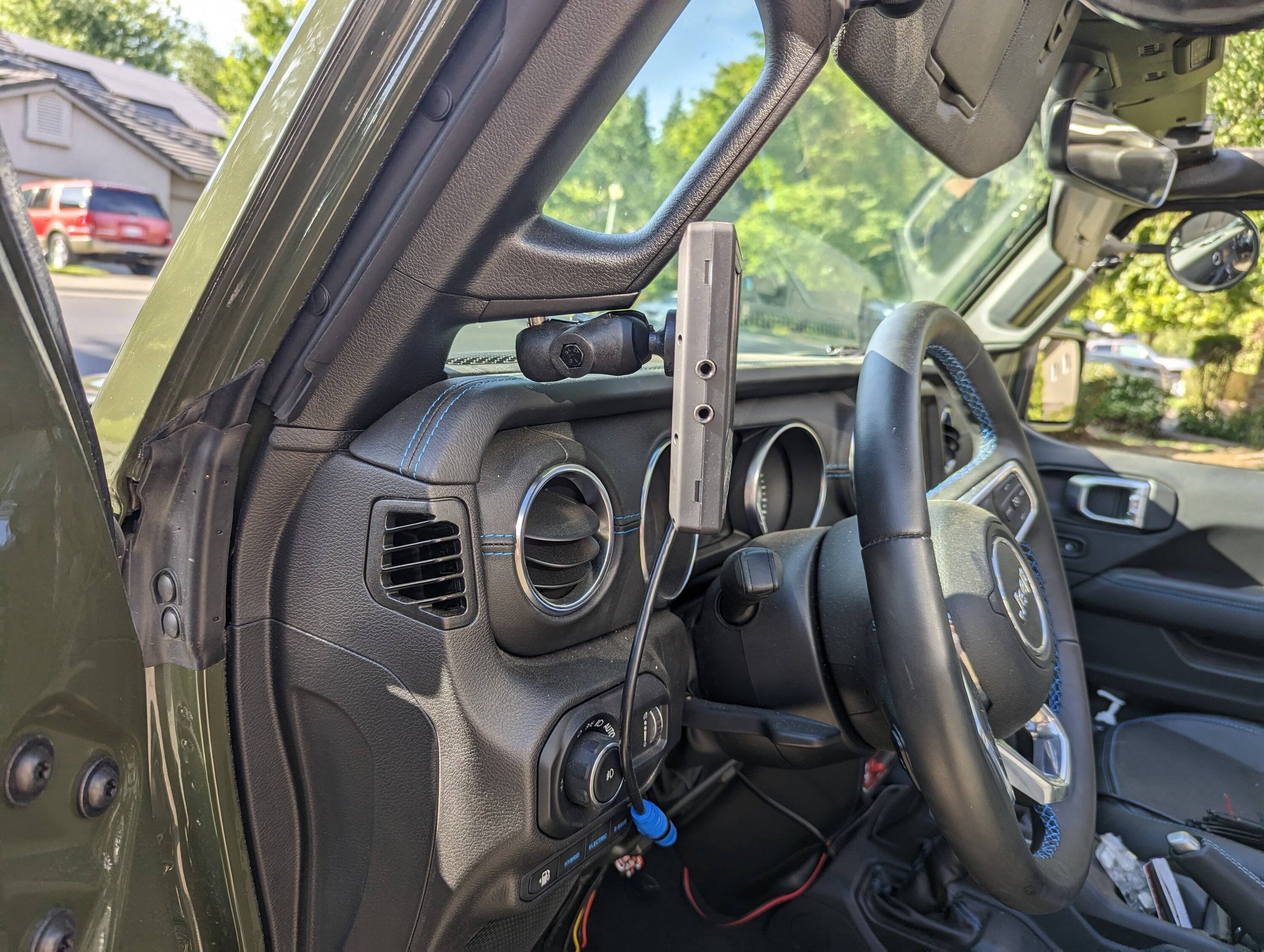

The first thing I did was figure out how and where to mount the monitor. Best place I could think of is to attach it to the bottom of the grab handle, which doesn't obstruct anything and is pretty well out of the way, though I have bumped it slightly a few times while using my turn signal. I may re-evaluate my bracket system to allow for more position options, but for now this works fine.
Jeep Wrangler JL How To: Install Stinger 4-camera DVR system & Echomaster 7" screen 2023-05-27 17.58.32
I disassembled the grab handle cell phone mount that I bought, and only used the main grab handle bracket itself. After removing the other junk from it, you're left with a 1/4-20 threaded hole in it. Thread the 1" ball mount into that.
Then, attach the T-bolt ball mount to the monitor. The monitor has a rail built in to accept a T-bolt, but you'll have to loosen the screws on the rail to get the T-bolt in. Then you can tighten the rail back down.
I routed the monitor cable through the steering wheel adjustment lever's slot.

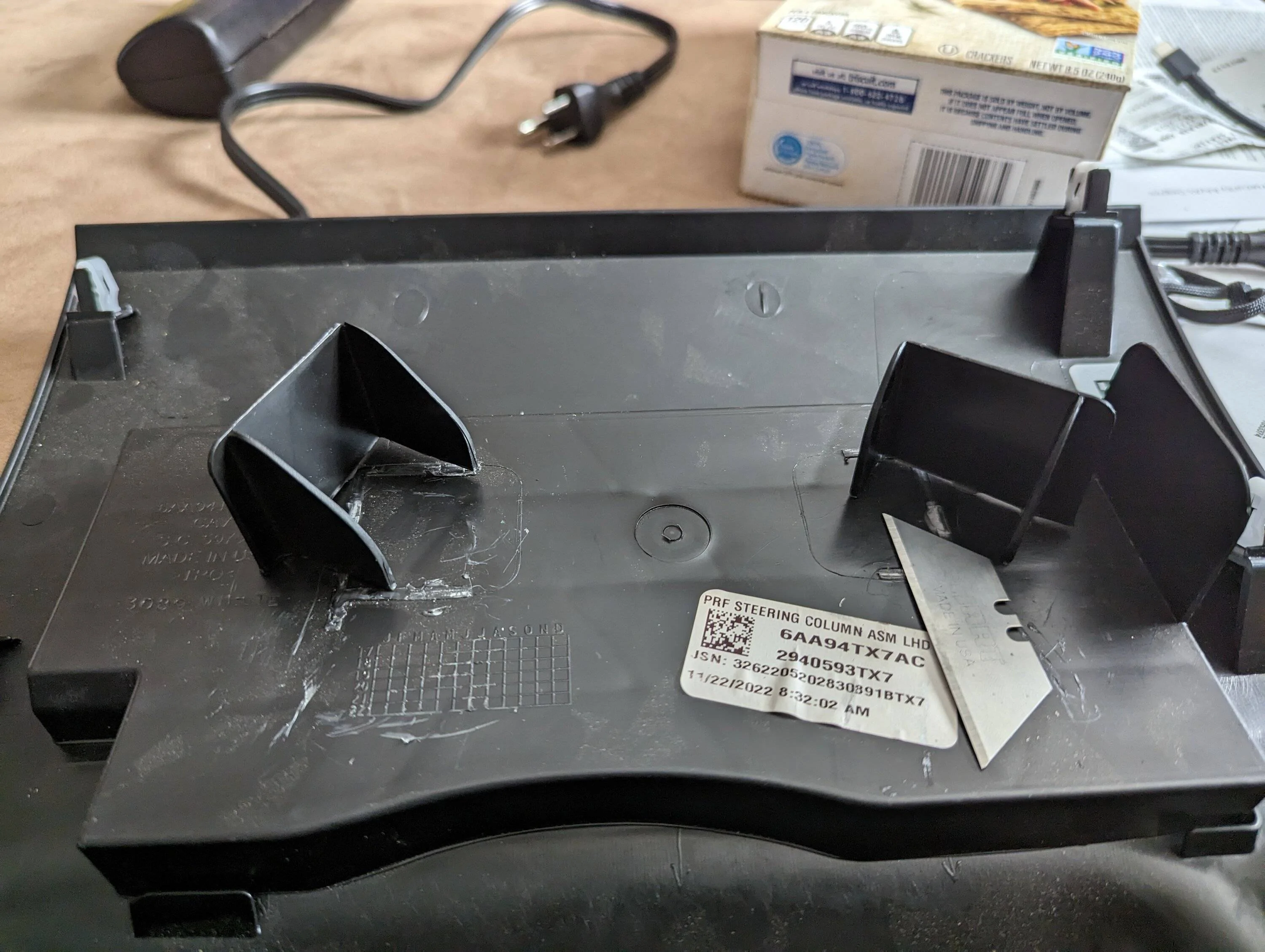

Your steering column cover will not fit back on until you cut off these two useless plastic tabs in the middle of the back of it; I just used some nippers and a razer blade. Once those tabs are removed, the steering column cover will be able to fit back in without any issue.
Jeep Wrangler JL How To: Install Stinger 4-camera DVR system & Echomaster 7" screen 2023-05-27 17.56.27

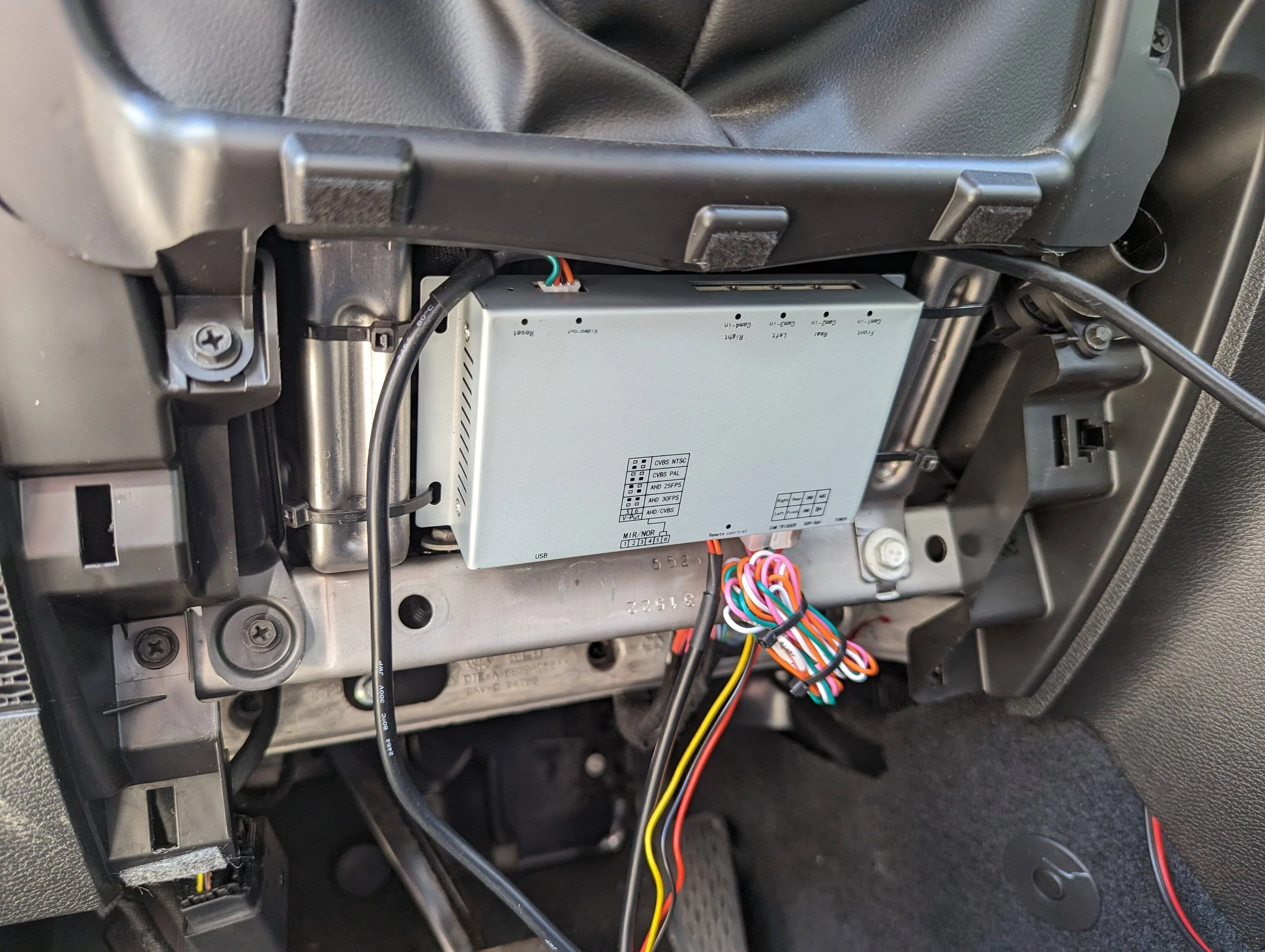

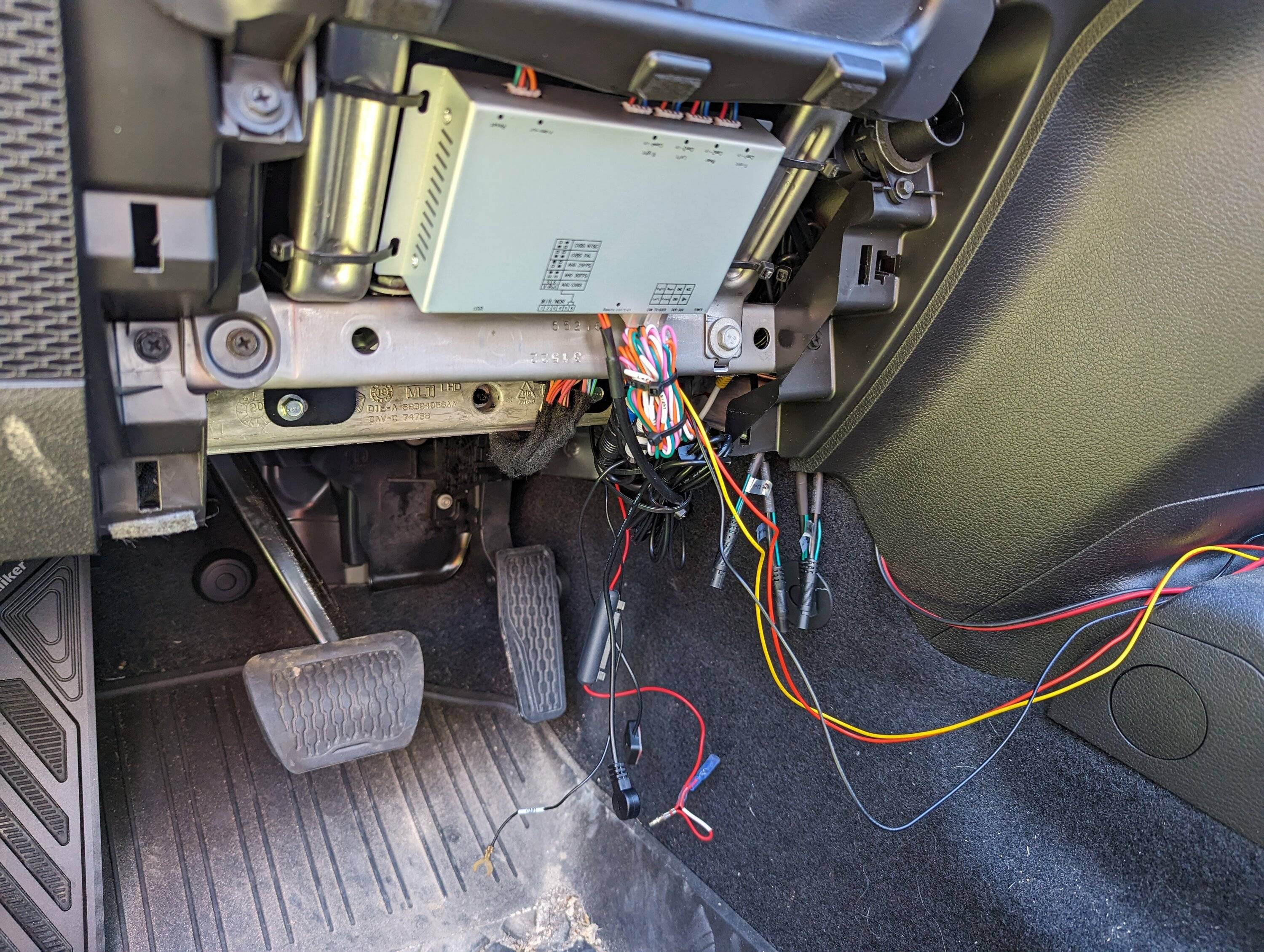

Wire management is going to be critical! All the wires for the camera system and the monitor are excessively long, and many cannot be shortened. Plus there are some wires that we're not using at all. You'll need to spend some time getting the rats nest of wires cleaned up and under control.
Jeep Wrangler JL How To: Install Stinger 4-camera DVR system & Echomaster 7" screen 2023-05-29 10.38.32

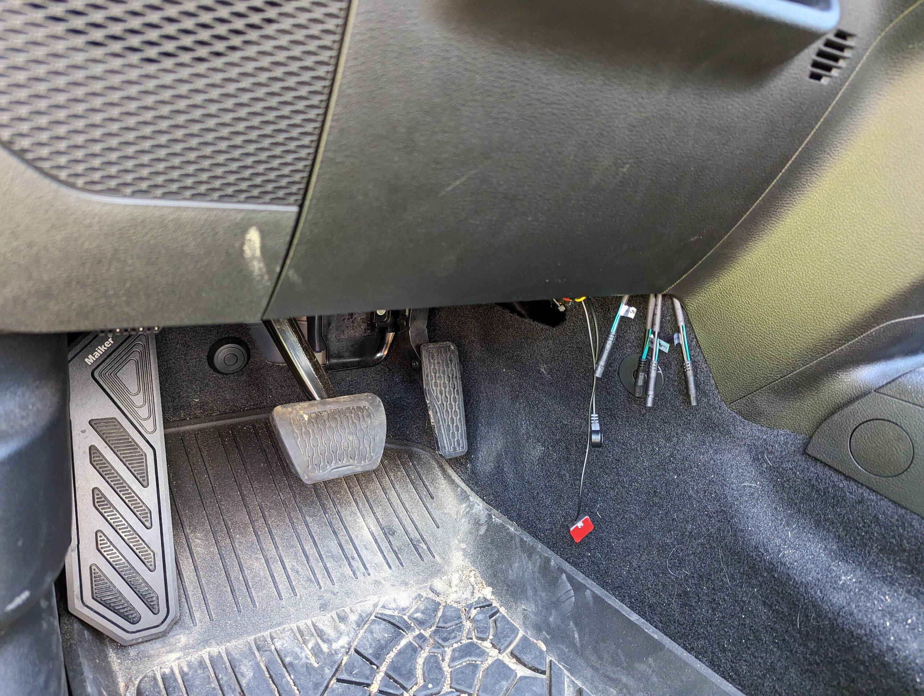

Plug in the camera adapter wire pigtails, and bring them down to an easy to reach spot (see black/green wires and plugs dangling in photo below). It helps to label the wires as you plug them in, so you know which channel is which when you plug the cameras into these pigtails later.
Jeep Wrangler JL How To: Install Stinger 4-camera DVR system & Echomaster 7" screen 2023-05-29 10.50.50
At this point, EVERYTHING should be connected except power/ground for the camera system and monitor, and the cameras themselves. Make sure all the wire rats nest is clean up and tucked out of the way, and go ahead and reinstall the steering column cover:
Jeep Wrangler JL How To: Install Stinger 4-camera DVR system & Echomaster 7" screen 2023-05-29 10.55.49

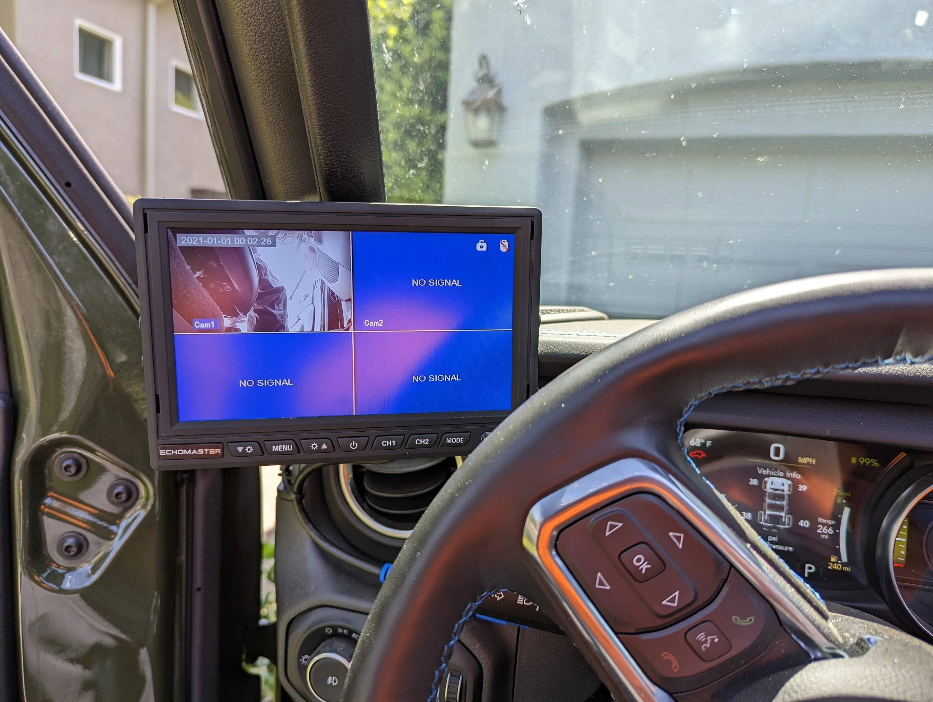

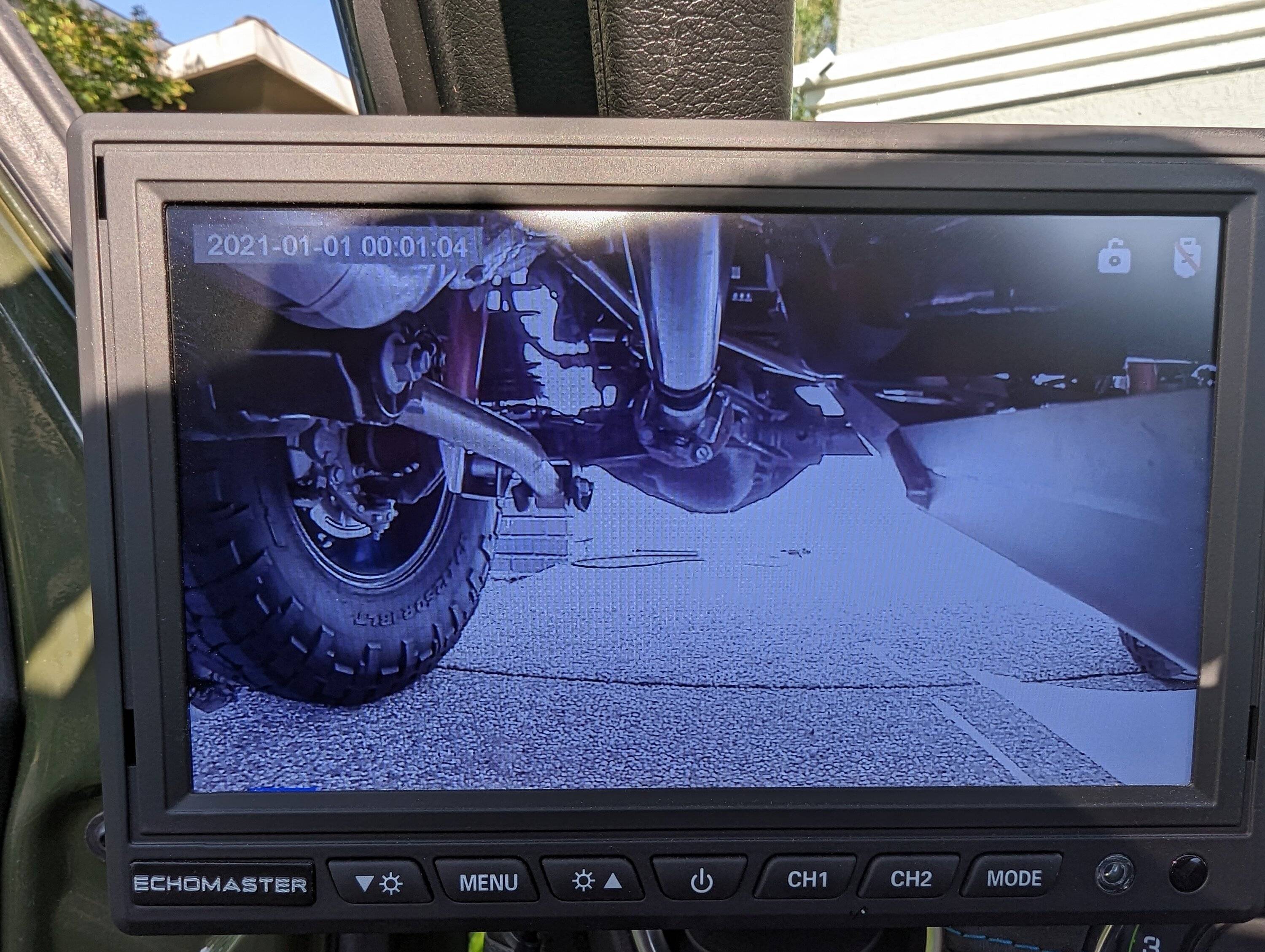

Now that everything should have power, go ahead and temporarily plug in a camera and turn the car on to give it a try! You should see something like below:
Jeep Wrangler JL How To: Install Stinger 4-camera DVR system & Echomaster 7" screen 2023-05-29 11.29.55

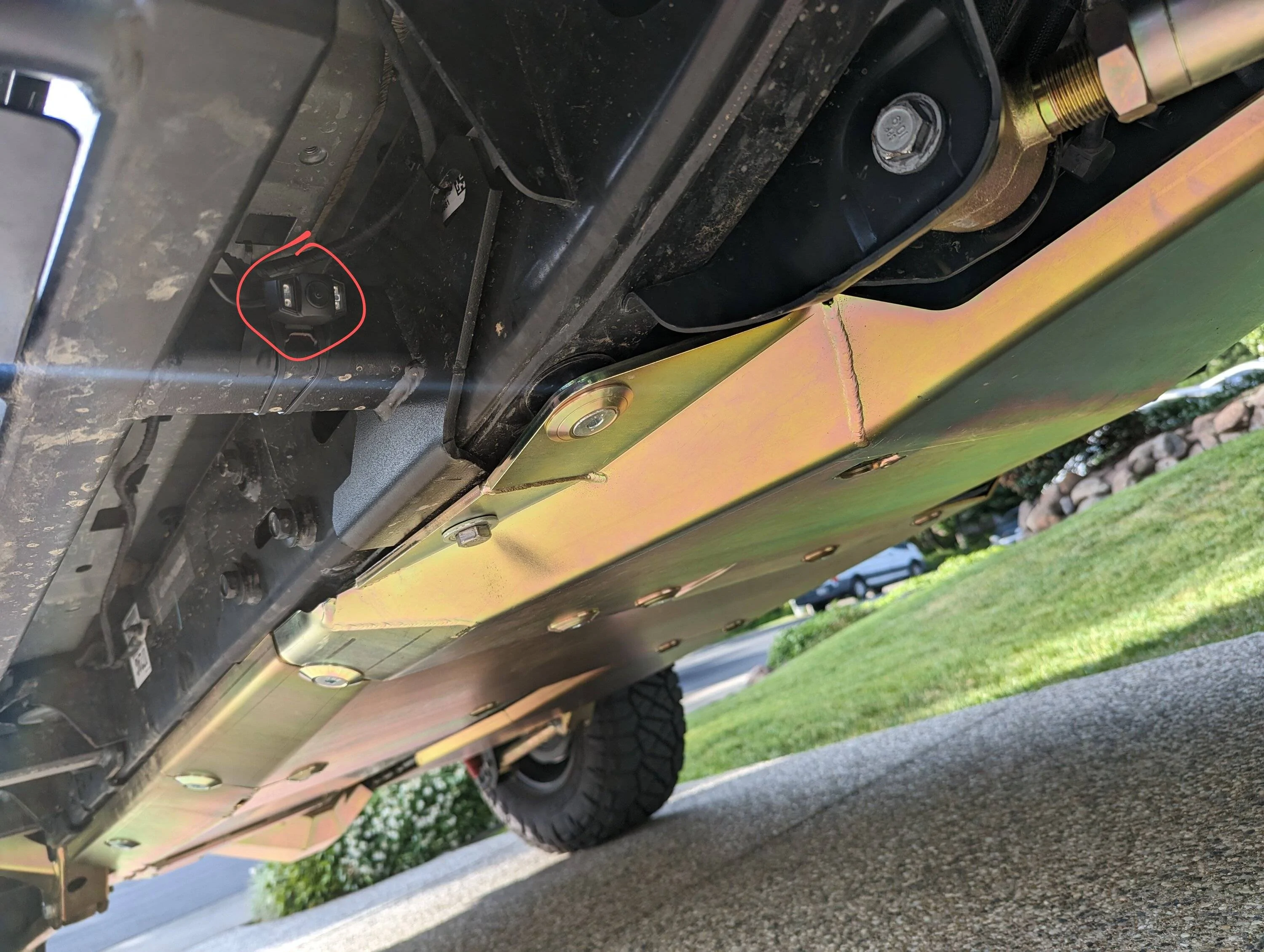

Camera #1, forward facing, viewing front left tire / front diff, mounted to the frame crossmember:
Jeep Wrangler JL How To: Install Stinger 4-camera DVR system & Echomaster 7" screen PXL_20230531_010011015~2

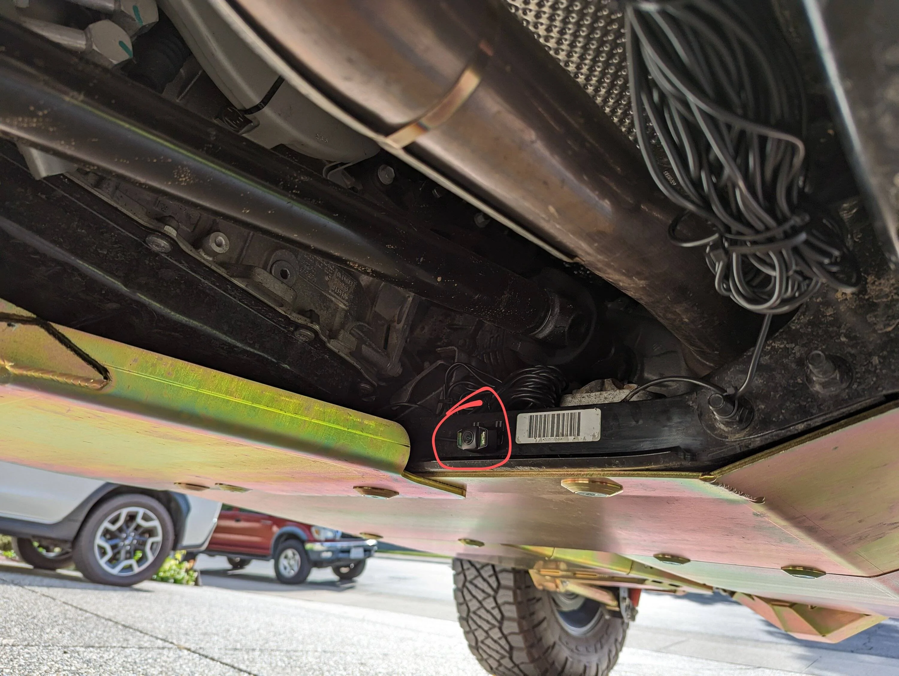

Camera #4, rear facing (and mirrored), viewing both rear tires and rear diff, mounted on the back of the FAD skid plate:
Jeep Wrangler JL How To: Install Stinger 4-camera DVR system & Echomaster 7" screen PXL_20230531_005957607~2
