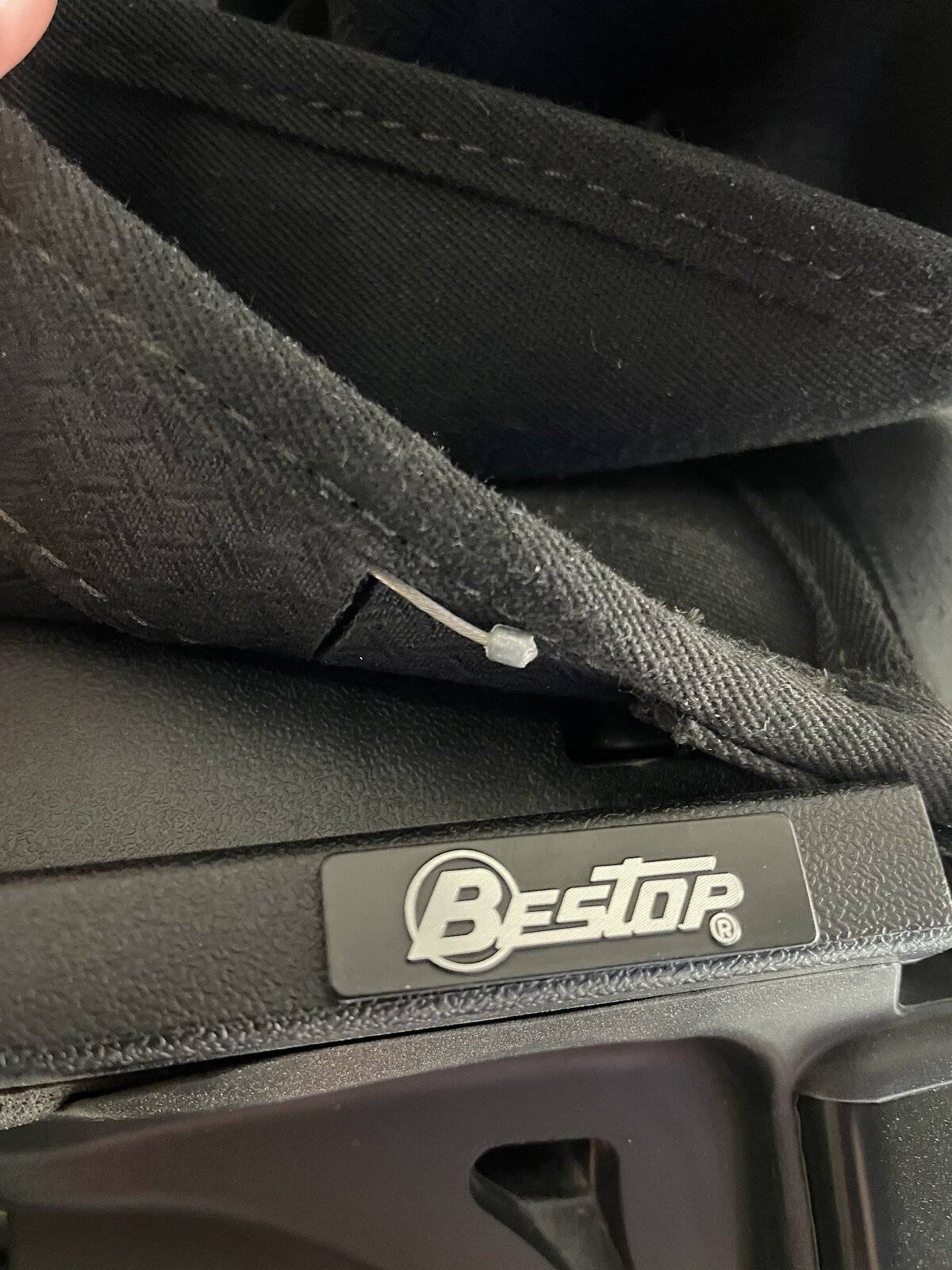

Well.....add me to the list of broken z-clips. Driver's side. Just sent an email to Bestop customer service.
@Bestop please let your CS people know they have an email from me. Thanks!
Wondering now about these tops long-term.
Mine broke about 2 months ago. I sent an email and it took a good month before I got a reply. They apologise for the delay and ask you to call. What a waste of time...
