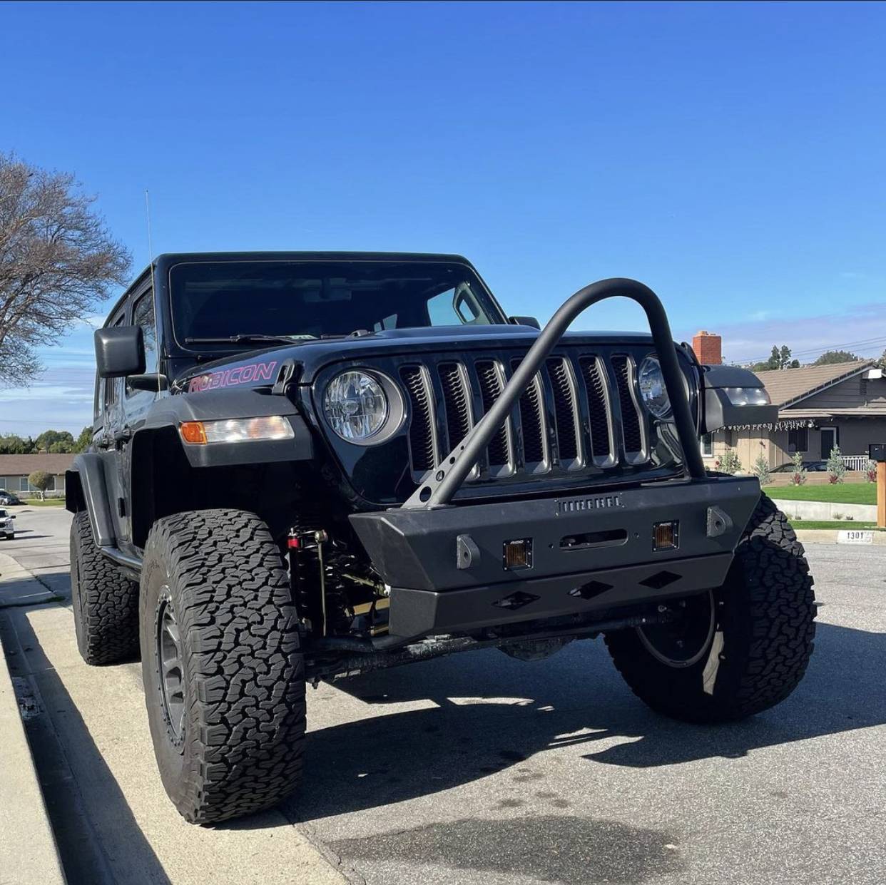

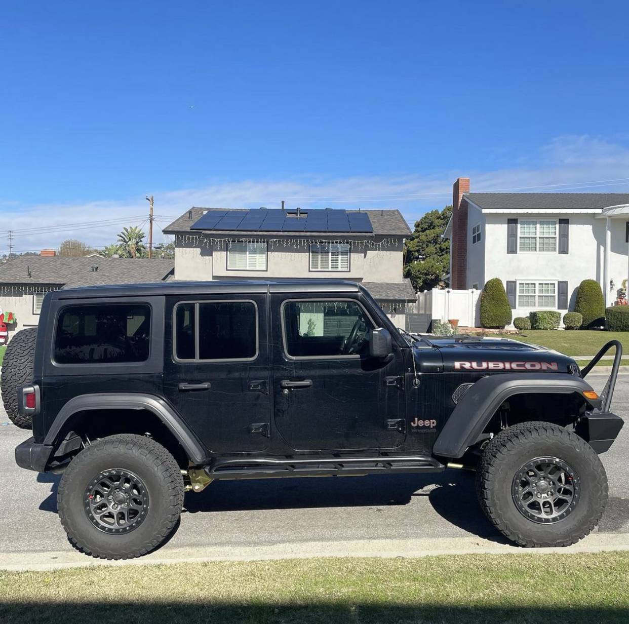

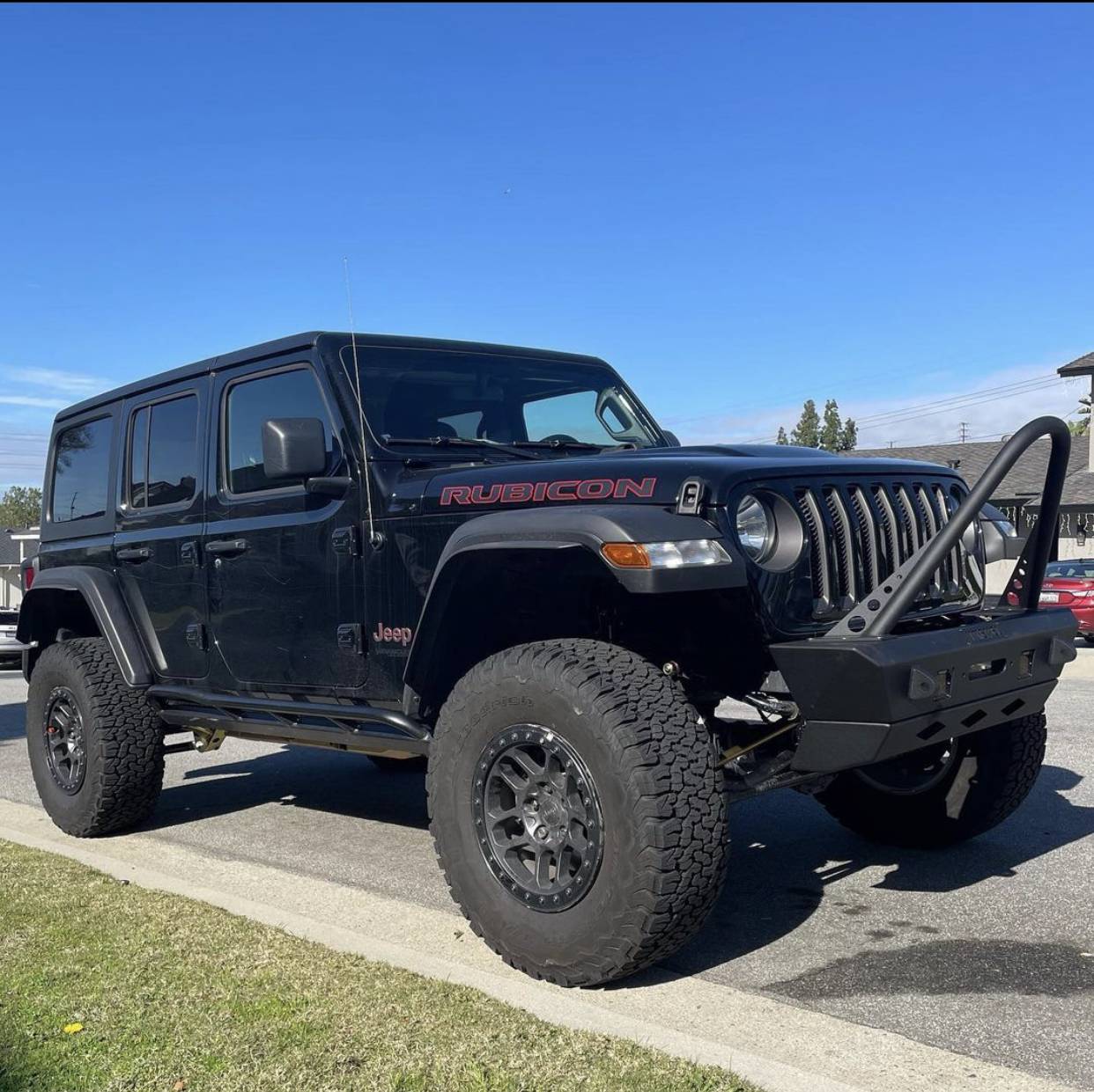

I have mc 3.5” lift on 35” tires. I plan to go 37 maybe in 6 months to a year. How much bump stop do i need in the font and back?

This is really the best way. I would be careful if someone recommends a certain set up. Lots of variables. It looks like you have 6 pak shocks?
