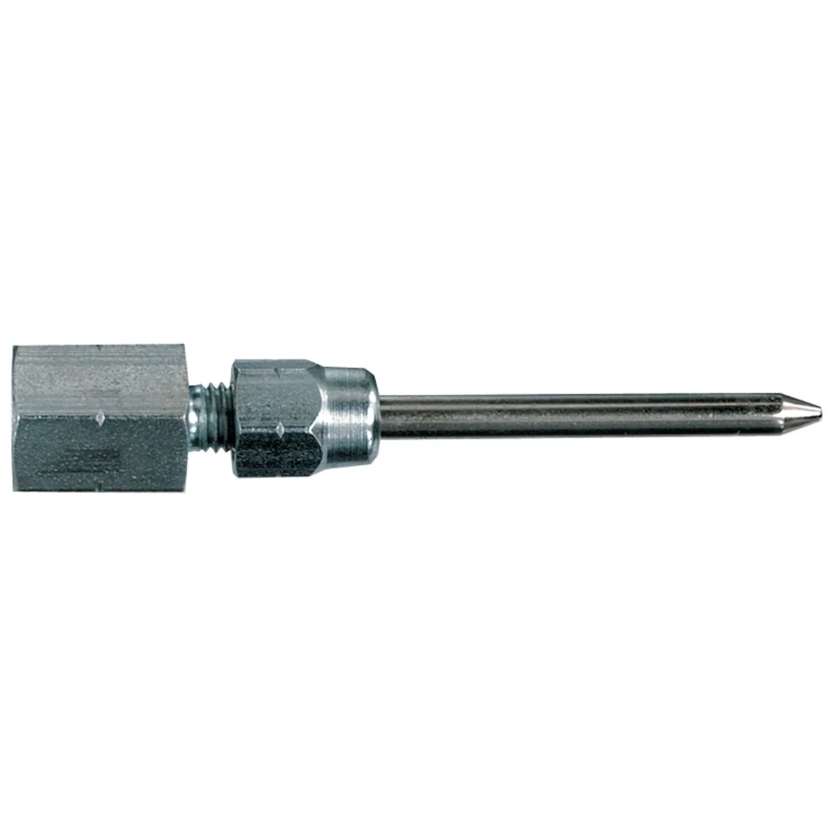

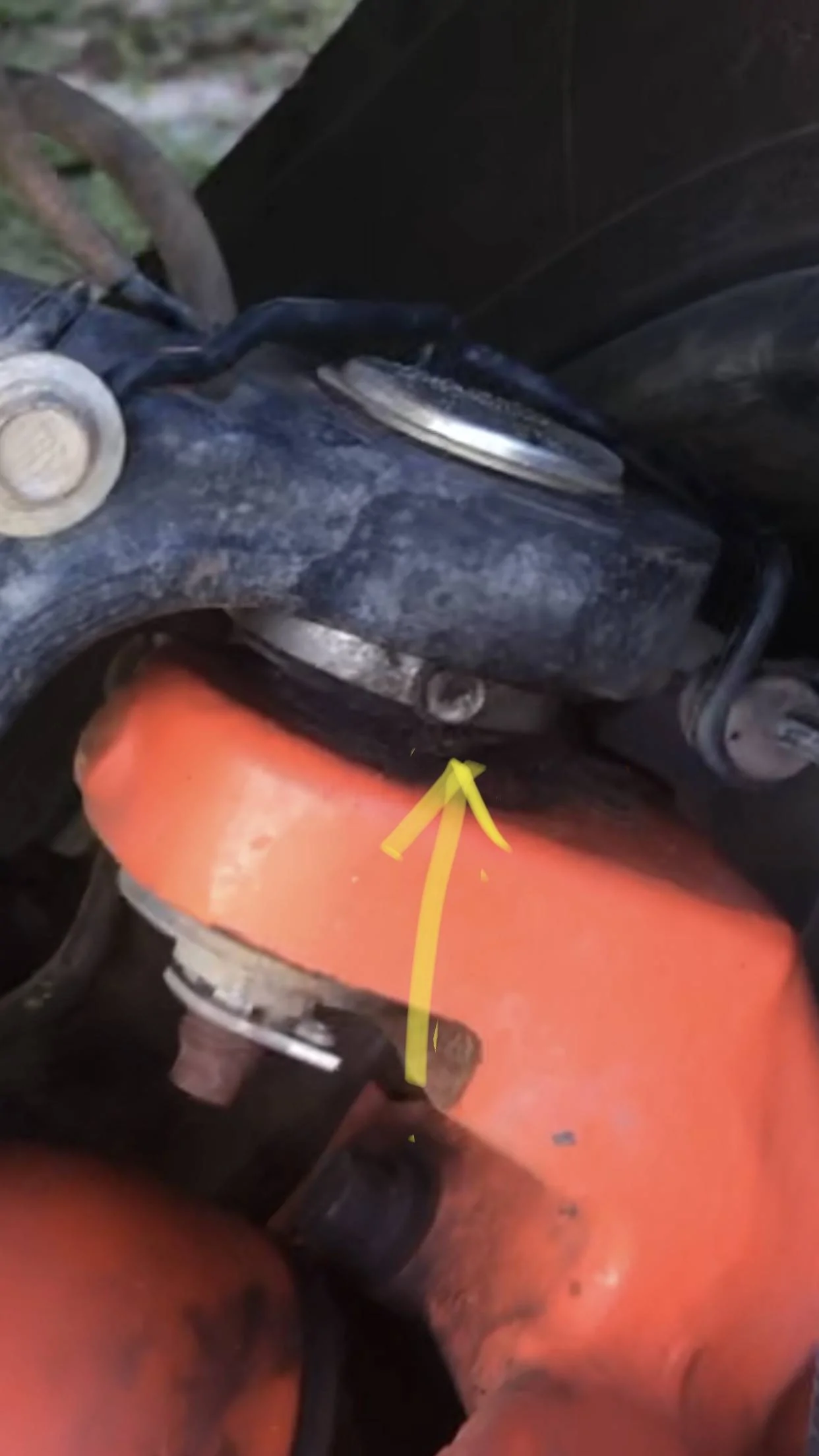

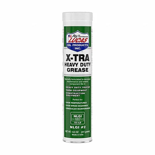

No, I usually hit all my grease fittings about 3 times a year ish…… not really as regimented as oil changes…….
What kind of grease and how do you grease it exactly? I’ve got 52k miles and ko2 34.4s, jacked it up and didn’t get any movement - kind of shocked because I do beat on the car a bit

I have the dynotracs….…I use green grease and a needle fitting…..
