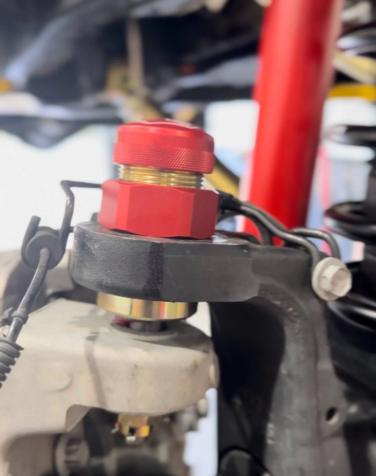

I’d say it’s time. I replaced mine at 21k with the MetalCloak baller joints and felt a positive difference. ??

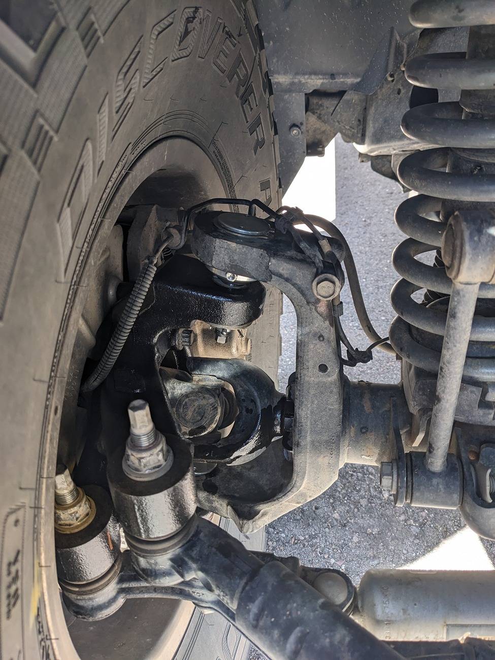

I've been lifted on 37's for 37k miles on stock ball joints. They still felt tight when trying to get any movement out of the wheels. We have a busy summer so I went ahead and installed dynatrac ball joints and steel knuckles. Steering improved and the stock ball joints once they where out were easily moved by hand. I feel much better knowing I have steel knuckles and dynatrac ball joints.
