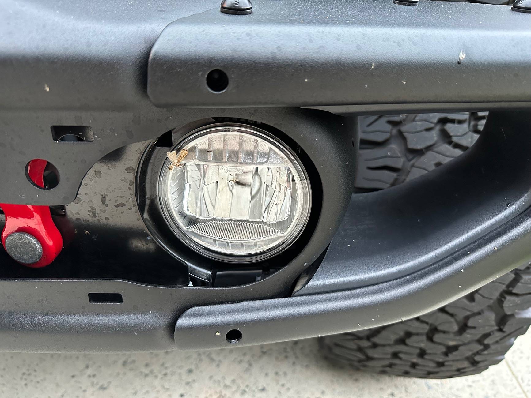

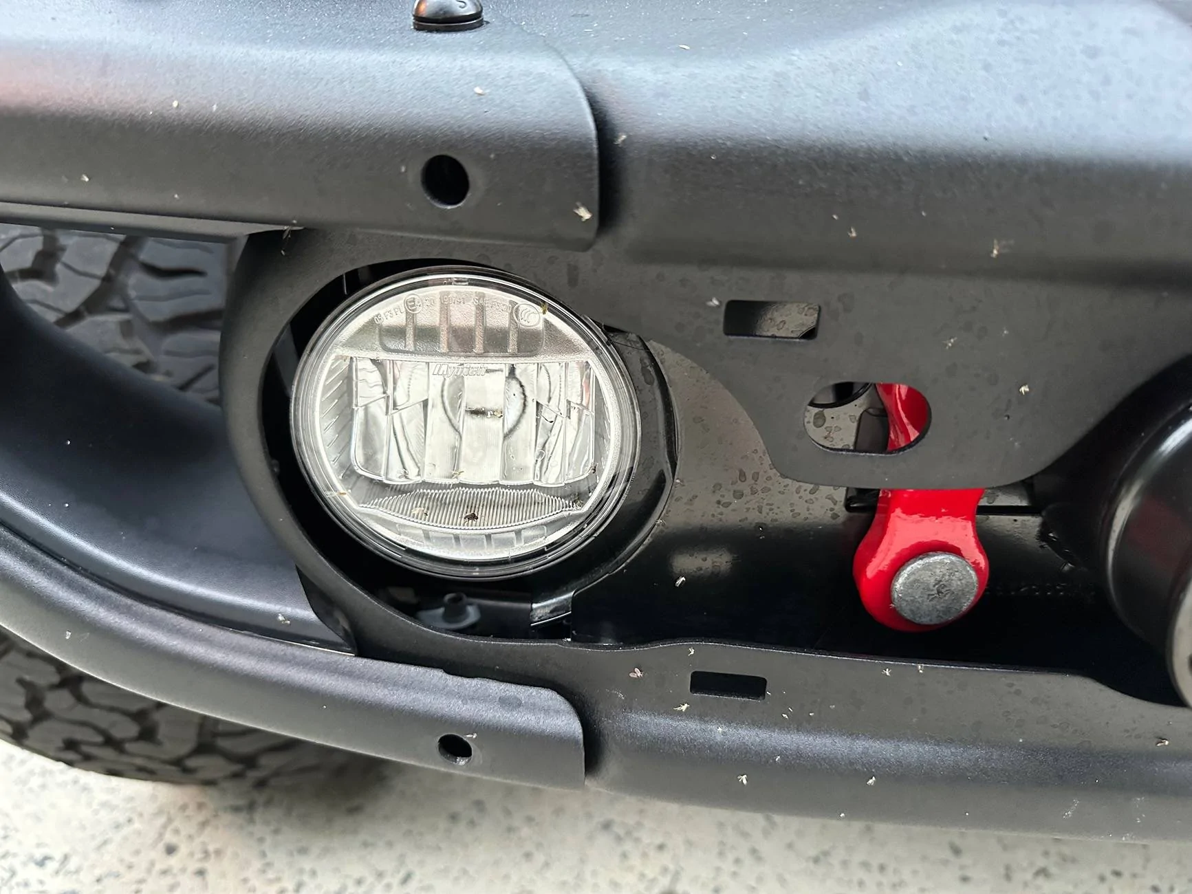

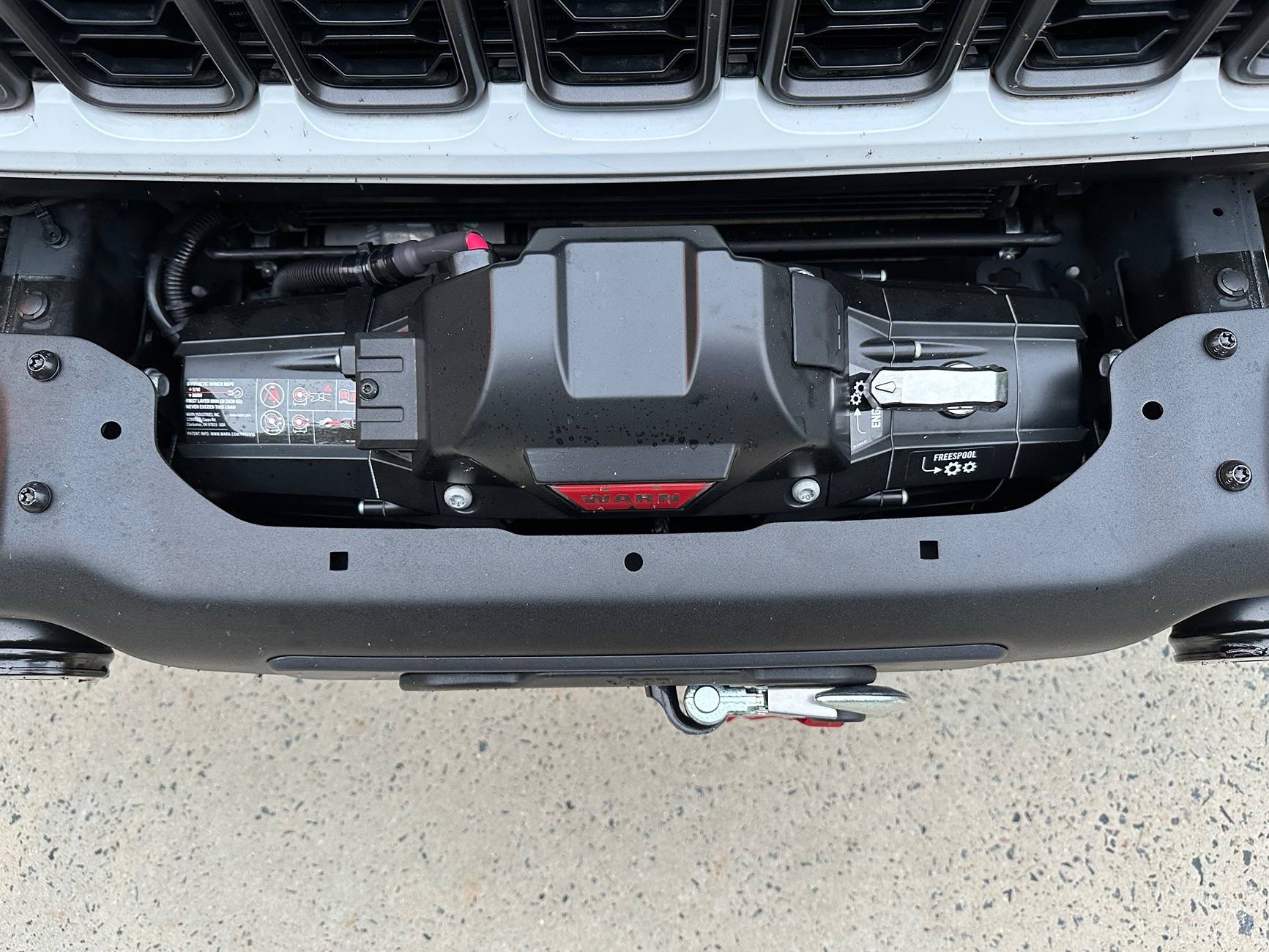

Hey Benny,
The dealership I bought a jeep from lost a few of the bolts. I'm trying figure out what the part number is for the 5 bolts that fill in the holes around the winch, along with the two bolts on each side that go above and below the fog lights. Its hard to tell what they are from the diagrams but hoping you have links to the parts.

Hi Andy,
The top 5 holes get plugs
https://parts.allmoparparts.com/oem-parts/mopar-push-pin-68582107aa
The front holes use these bolts
https://parts.allmoparparts.com/oem-parts/mopar-screw-68355472aa
And it looks like youll need these nuts as well
https://parts.allmoparparts.com/oem-parts/mopar-u-type-multi-thread-nut-6105244aa
All hardware is sold individually so please order accordingly. I will send you a code to use

Thank you! Where are the U type nuts needed?

My parts diagram shows for the front bolts above and below the fog lamp. Looking at the bumper center section images itself its hard to tell if these holes are threaded, If you find that they are then no U-nuts needed.
