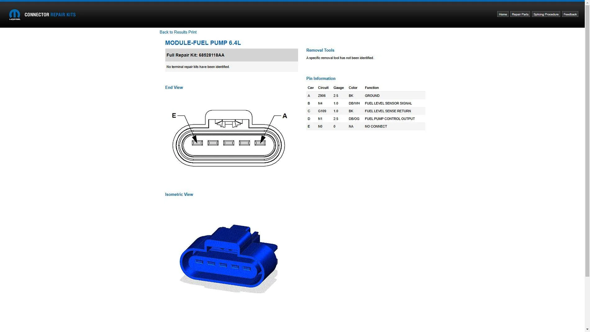

Im looking for the electrical connection that attaches to the top of the fuel pump in a 22 Rubicon 392. Also if there is a matching mate to that plug, I’m looking to extend the fuel pump wire harness and not cut the factory wires. Even if I have to buy the plugs and terminals separately, it would be great just to get part numbers. My dealer says they can only get a full harness not individual parts. Appreciate any help.
The only side thats available is the harness pigtail which is https://parts.allmoparparts.com/oem-parts/mopar-wiring-68528118aa
If you can find a used pump on ebay you may be able to build something but that connector is part of the top of the module so its not as easy as cutting the connector end off.
Here are the connector details to the pigtail I linked
