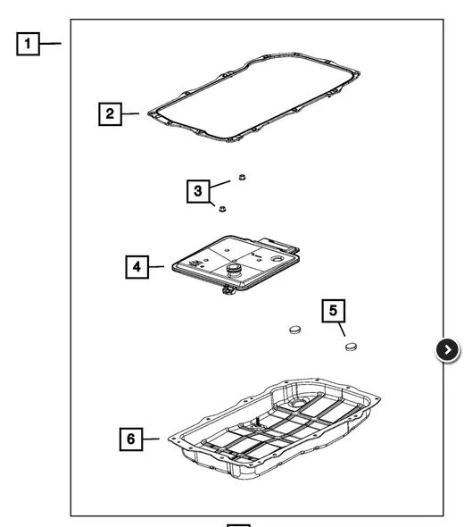

I'm preparing to change transmission fluid on my '21 Rubicon 392 with the ZF 8HP75 transmission. I've seen some comments saying that the entire pan and filter assembly needs to be replaced and others saying just the filter. The 68362041AC parts diagram on the AllMoparParts site shows the below diagram (if I've got the correct PN selected): Can you confirm what part number(s) to order?
Thanks!

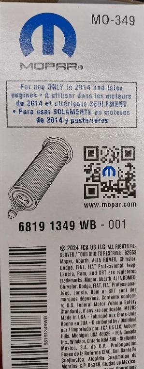

I posted this question in the 3.6 forum but thought you might be able to help. I picked up an oil filter and now realize the part number doesn't match even though the callout on the box is the the same "MO-349".
Would you happen to know the difference between the 6819-1349WB and the 6819-1349AC oil filter? I saw it on your website but couldn't locate any fitment info. Also I wanted to make sure this is OK for the '24 3.6. Thanks for your help!

The filter is superseded by the pan & filter assembly. The part # 68362041AC is correct for your application.

The current part number is 68191349AC which is the same for all 3.6 JL's. When I search 68191349WB in mopar's system it is recognized but is not a serviceable item.
Can you post pics of what you have

That is strange but I believe the filter is identical and the part number/box may have been for global distribution rather than just for the U.S market. Here is another similar thread
Thanks again for checking! Makes me feel better at least, lol. I didnt realize until afterwards that the last 2 letters were different, just saw the MO-349 callout and thought I was good to go!

Order placed - Thanks Benny!
