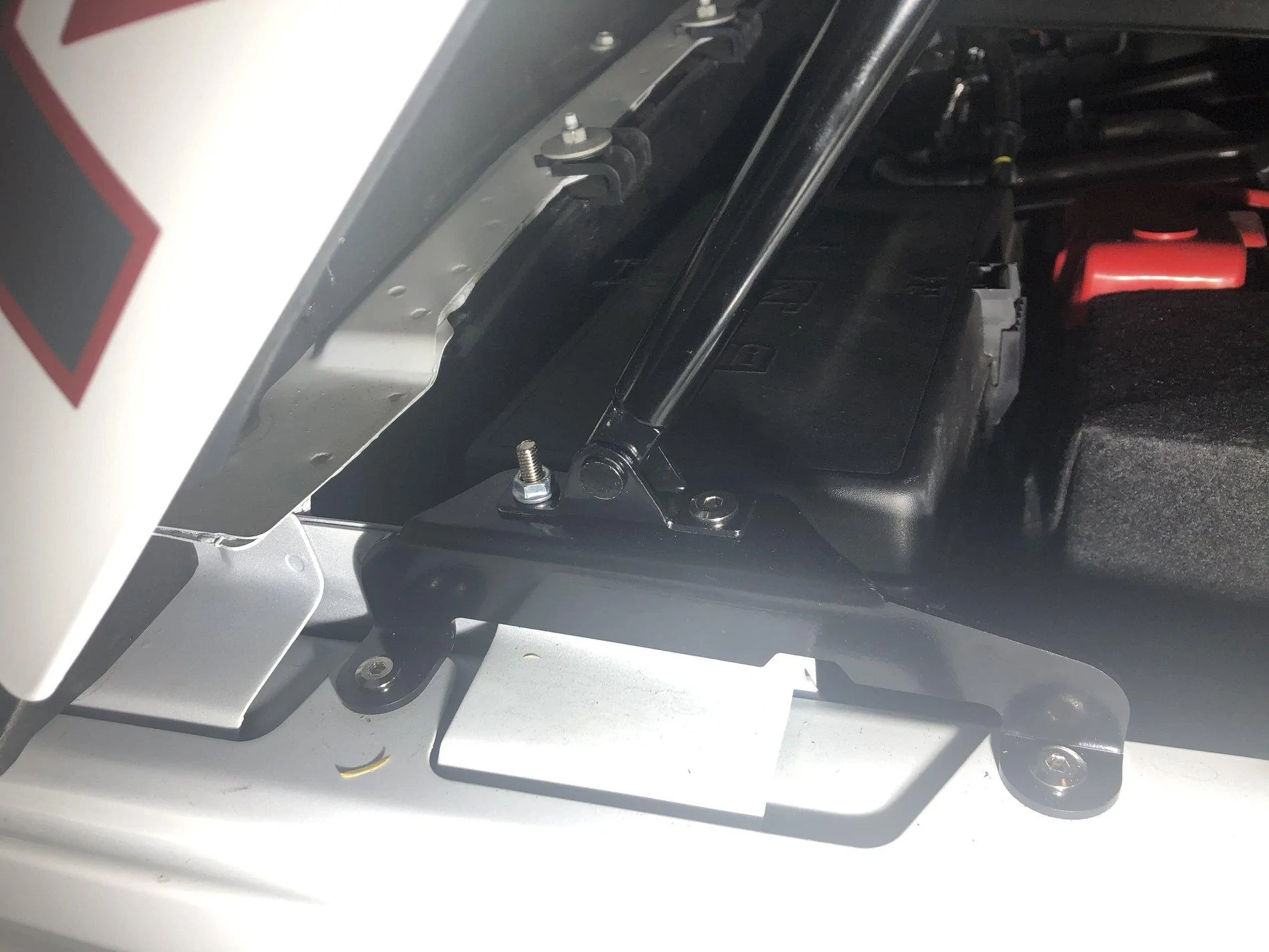

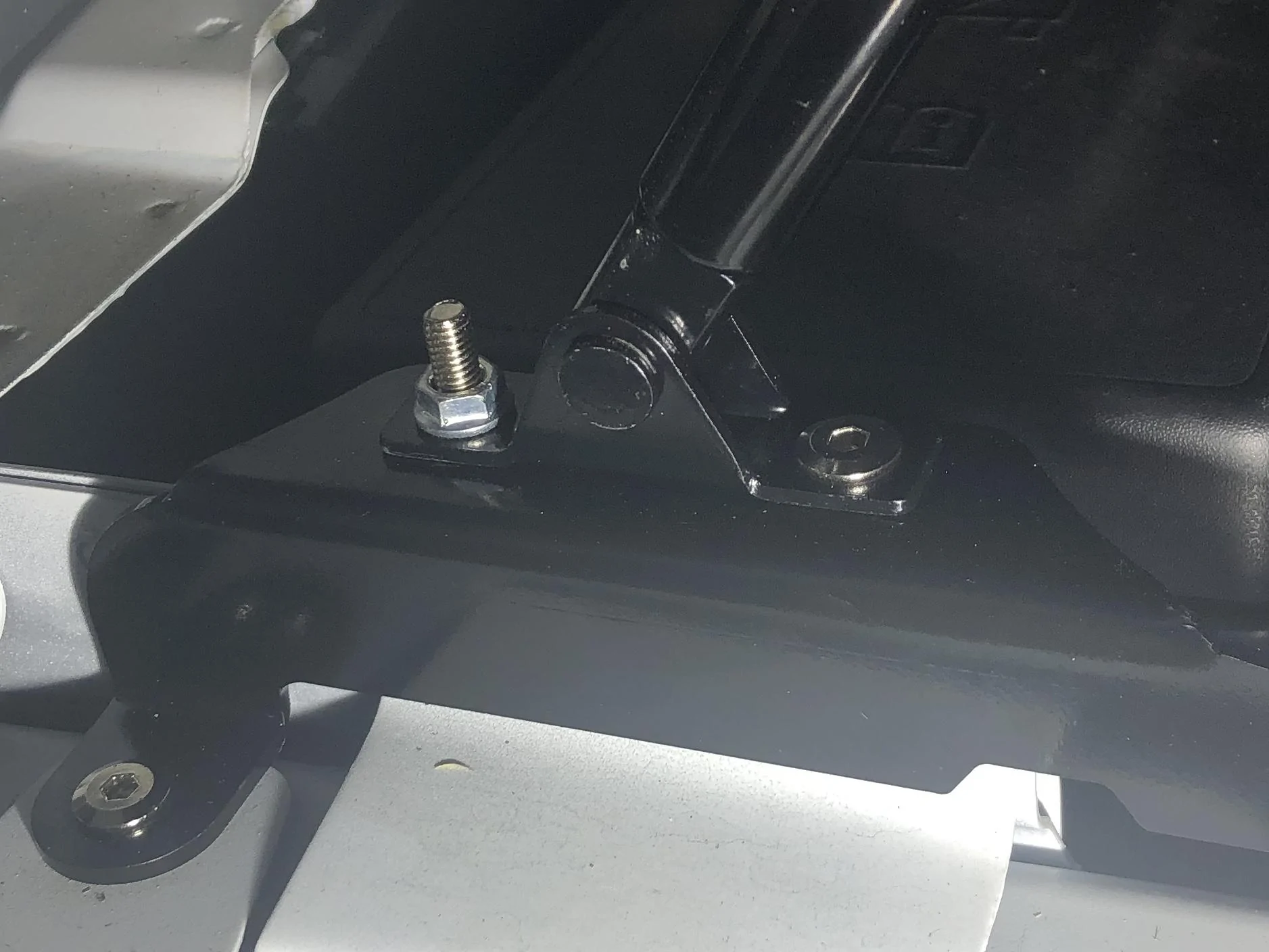

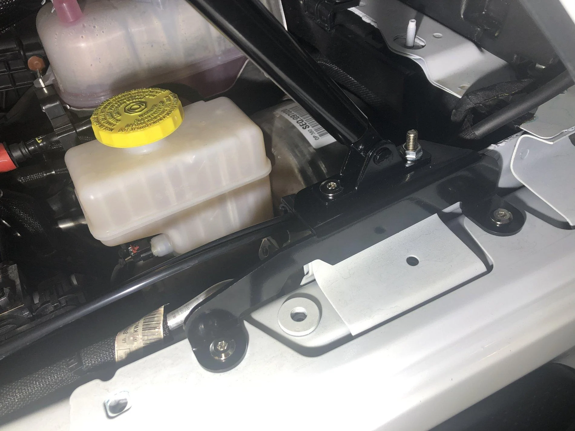

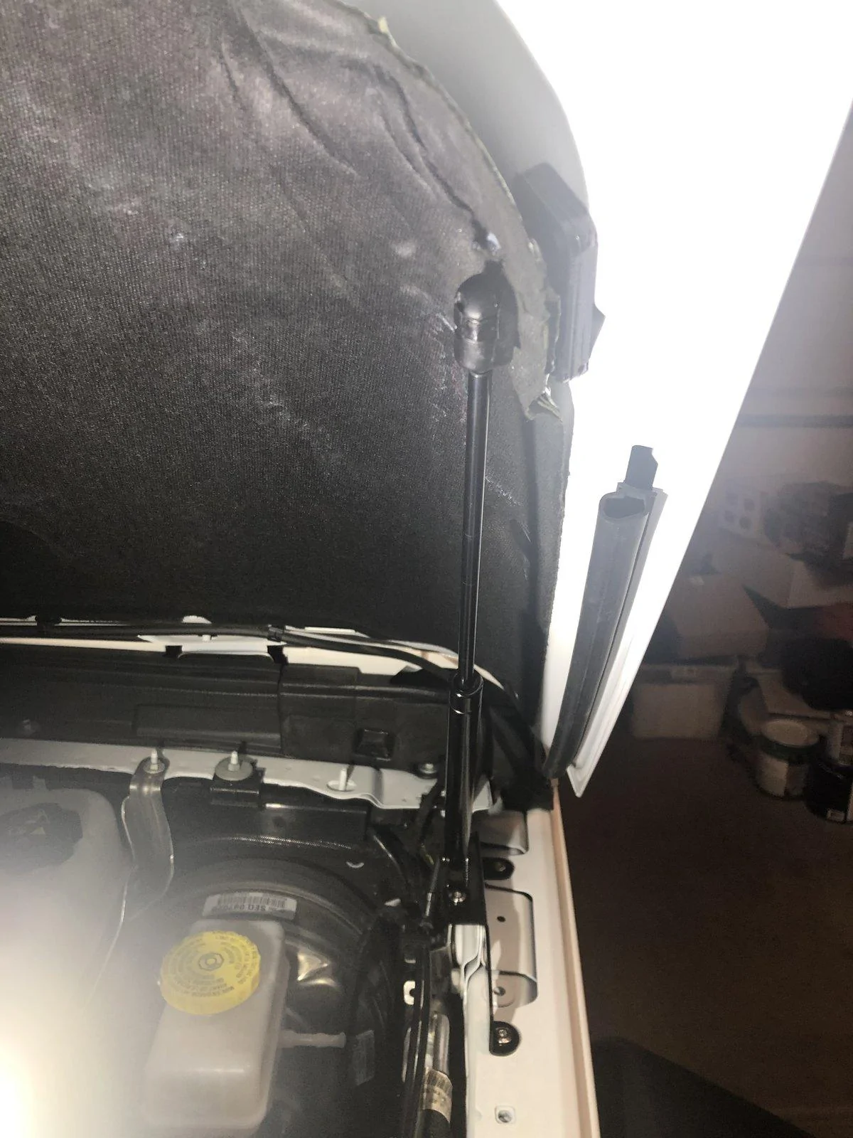

Thumbs up to @Redline Tuning. This is a well-designed hood strut system. It has a great "no drill" design and took me less than 15 minutes to install. 5-star customer service also! Highly recommended!
Caution... Don't overtighten the hood bracket bolts because the silver back plate will bend. Suggest using a dab of blue threadlocker.
