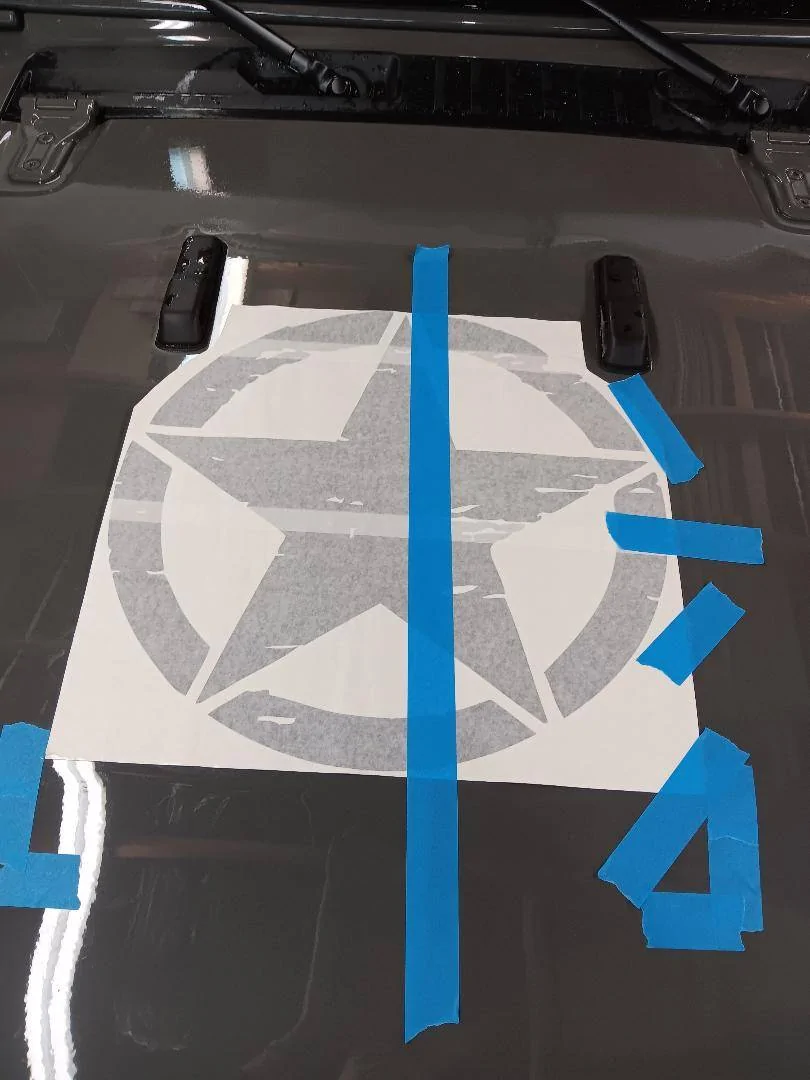

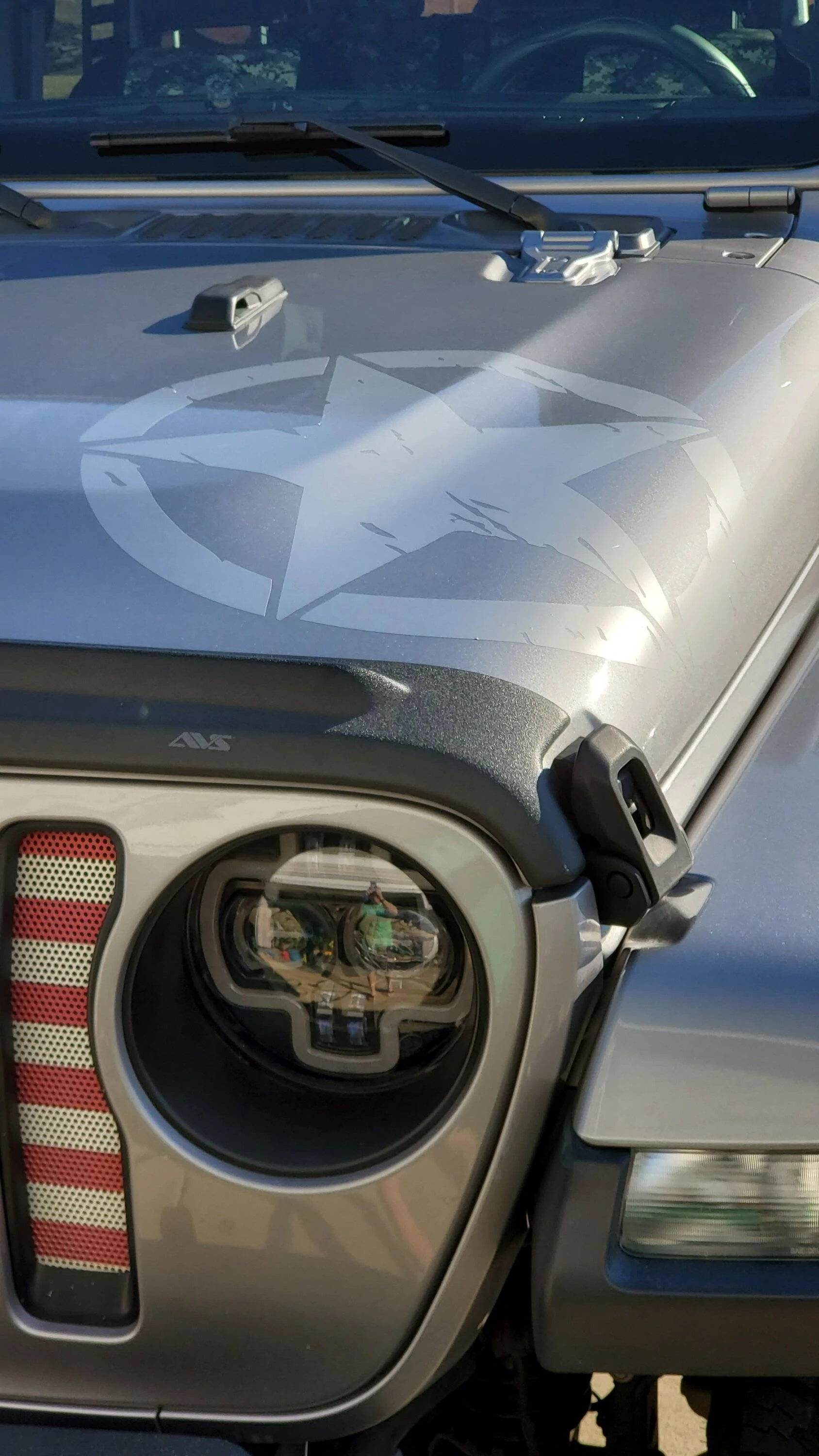

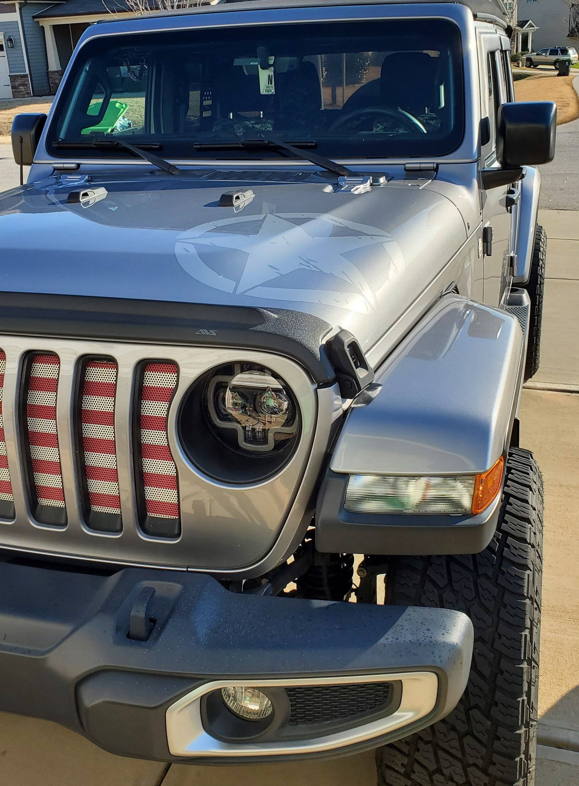

Ok... got the hood stars applied.
I did the TJ first, then did the JLU. It came out nice.
I did the "wet" method. Don't know if that made a difference or not, but when removing the top layer sometimes the decal wanted to lift off too. Hopefully baking in the sun will make sure the decal sticks onto the hood good.

The process is normally to leave the tape on until it has a chance to dry for 30 mins or so, then wet the tp of the tape a little and peel. You didn't hurt anything by peeling early and as soon as it is dry it will have full adhesive power.

I let it dry plenty, but I didn't wet the top of the tape before peeling.
Oh well; like most of my projects, once I've done it once, I know how to do it right the next time. As long as it will stick I'm good. It looks nice!
