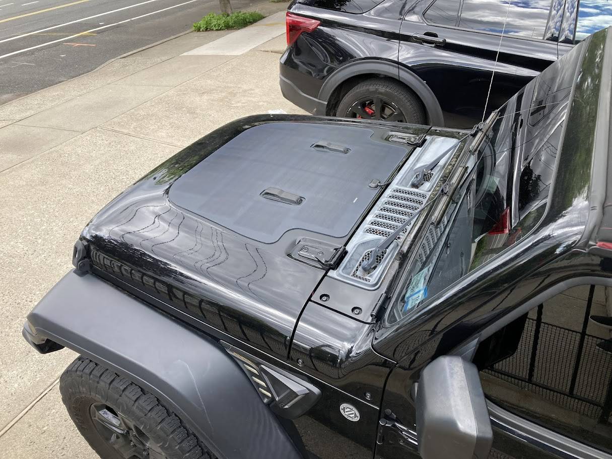

2 hours later, solar hood panel installed. Why? Because I don’t drive my jeep enough to keep the battery charged. Been having to jump start more and more every month. It’ll also keep my dash cams on longer during parking mode. My electronics use around 100 amp hours during the week while parked and the solar panel with a conservative 5 hours of sun per day should generate a little over 200 amp hours leaving me with 100Ah to spare
The brand I used is Lensun's 90w kit: https://amzn.to/43x6UTl
Jeep Wrangler JL Hood Solar Panel Installed IMG_0461 Jeep Wrangler JL Hood Solar Panel Installed IMG_0460 Jeep Wrangler JL Hood Solar Panel Installed IMG_0397
My only tip for those who don't have a heat gun is to leave the engine running when installing the vinyl layer. The heat will help get the hard to adhere spots.

Isn't it generating about 7.5 amps per hour, so about 37.5 amp hours when at 100% for five hours, right? Assuming it's all 12v.
Maybe you meant per week?
More like 6Ah/hr around 30Ah/day (conservatively) 7.5Ah would be tough to achieve, would need perfect angle and conditions.
Yes, the numbers are weekly estimates.

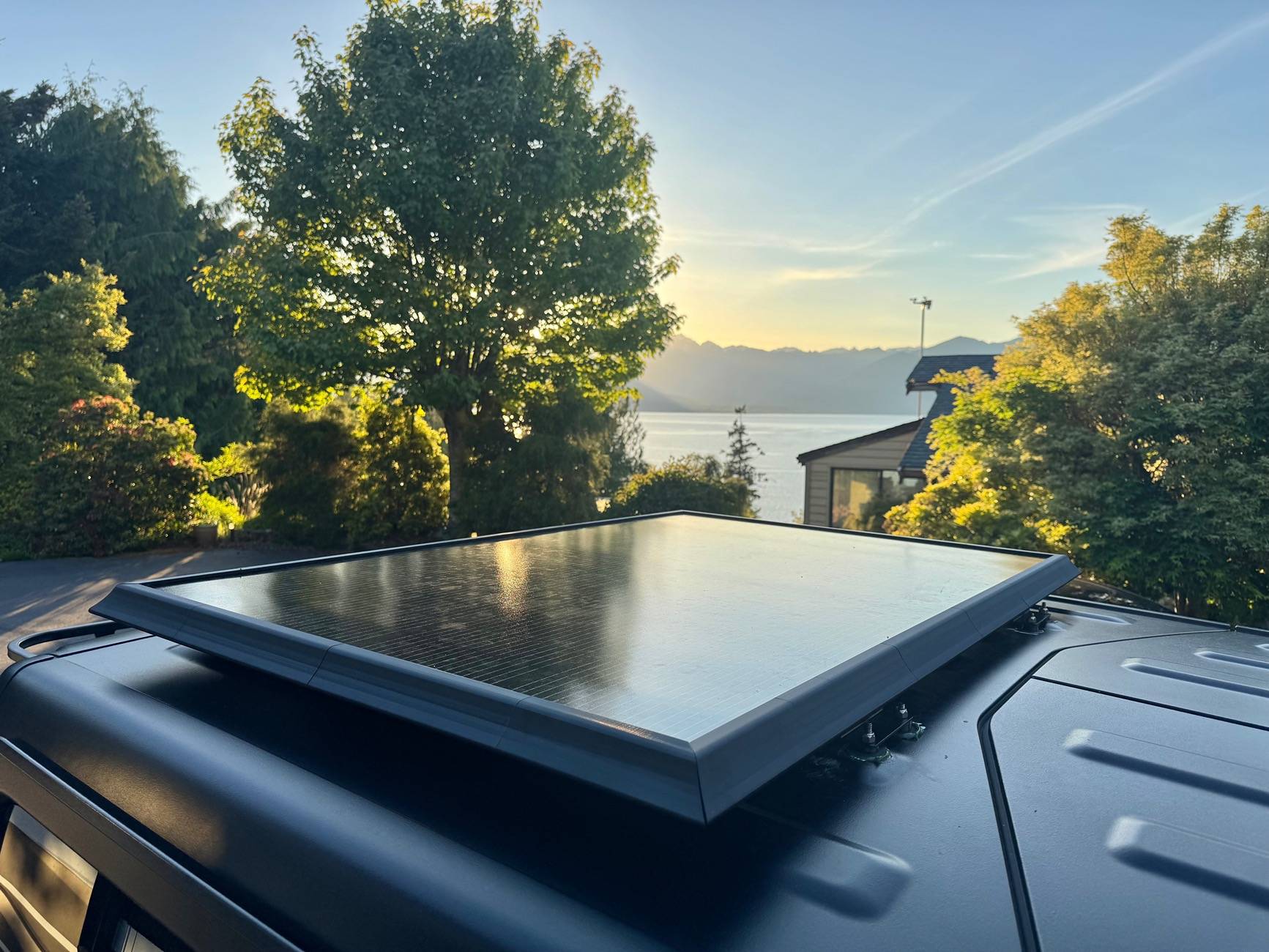

He's what I did a year ago for the same reason; don't drive the Jeep very often.
https://lensunsolar.com/collections...angler-jl-rubicon-lensun-50w-hood-solar-panel
Jeep Wrangler JL Hood Solar Panel Installed 033-
https://www.jlwranglerforums.com/forum/attachments/033-jpg.896612/
I'm not sure I would do the same thing again. The 50W panels put out only 18W under optimum conditions, but the main issue is that their voltage (17.5V maximum) is not that much over 12V charging voltage of 14.5. The controller is PWM, so you need the panels in the sun before the battery will charge. A MPPT controller would help a little but the real problem is the type of solar cell used. The 55W panel from the same company has a higher voltage (19V) so would work better.
CIGS panels are better but they only seem to come in oddball sizes and they are low efficiency so need to be large.
Probably I just need to swap out the PWM controller for a MPPT but they don't usually start until the PV voltage is 5V over the battery voltage, so again the low PV voltage is a problem.

First off OP, that looks nice.
Using an MPPT controller versus a PWM gives you a little more efficiency as well. Whilst solar panels love the light, they hate heat and lose efficiency as they get hotter. Not a big concern while driving but the heat off the hood will shorten their life versus elevated roof mounted panels.
