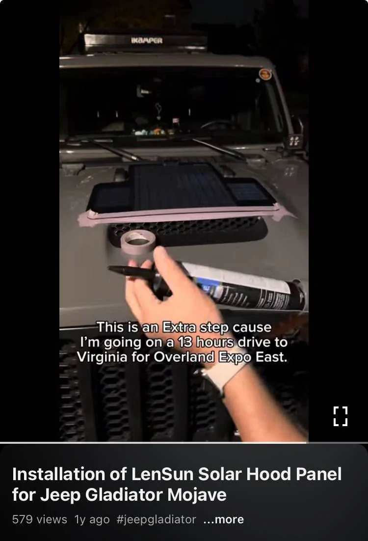

I like the concept and you did a really clean install. My concern would be at highway speeds, getting a corner lifted and it ripping off the whole panel. But I'm over cautious.
Best,
-Tim
Thanks! I had the same concern initially but it went away when I had to lift the vinyl back up after only letting it settle for 5 seconds and it was tough. The double sided tape is even stickier. Just make sure you run the tape along the entire edge. At least the front and they also recommend putting a bead of silicone down which will definitely remove that possibility.
this guy silicones his at 1:14

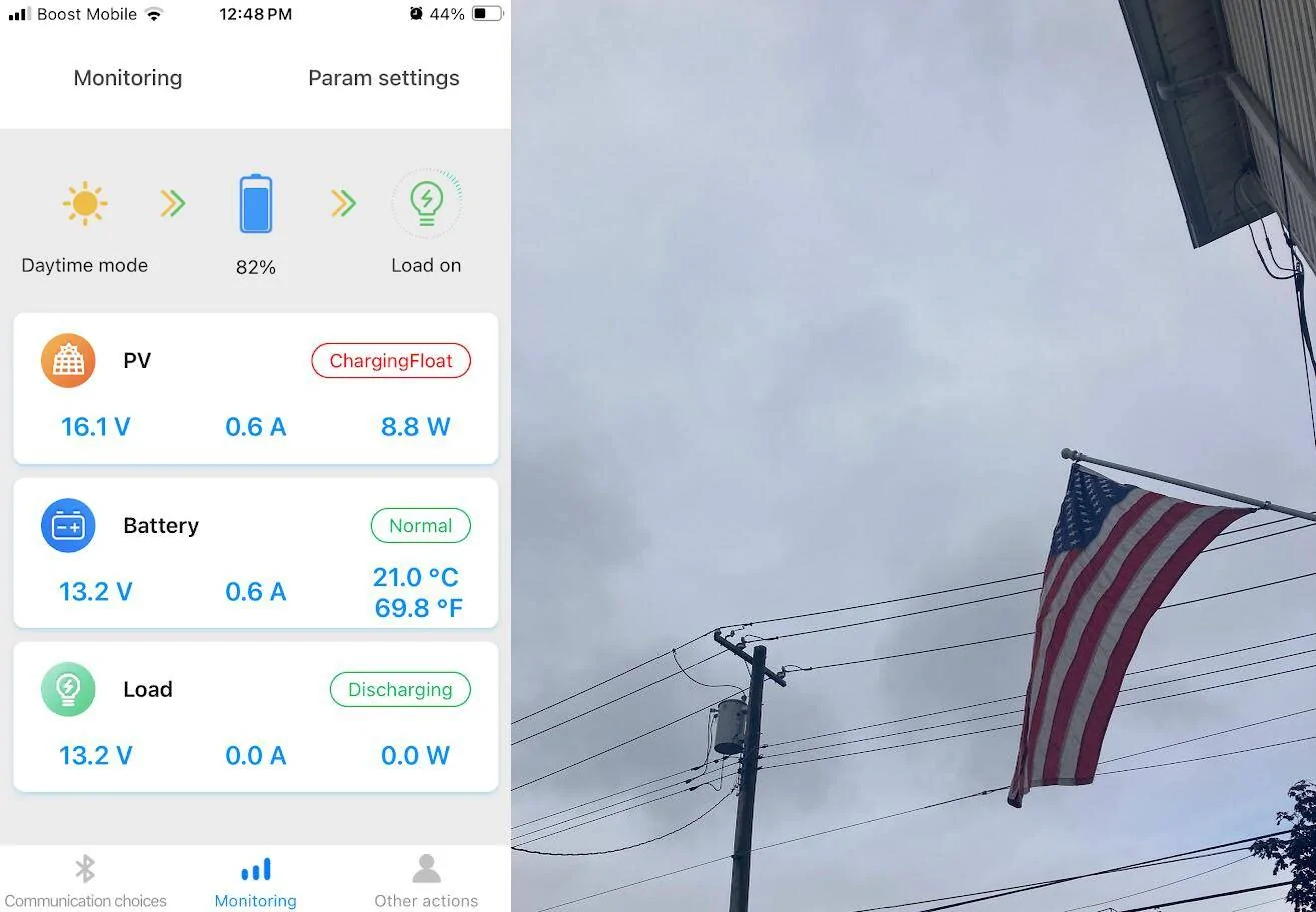

the past few days have been mostly cloudy and rainy, but even with such weak sunlight my battery is still staying topped off and my dash cams haven't turned off yet. It's been 5 days already!
Jeep Wrangler JL Hood Solar Panel Installed IMG_0543
starting to think the 90w kit was overkill 🤣
