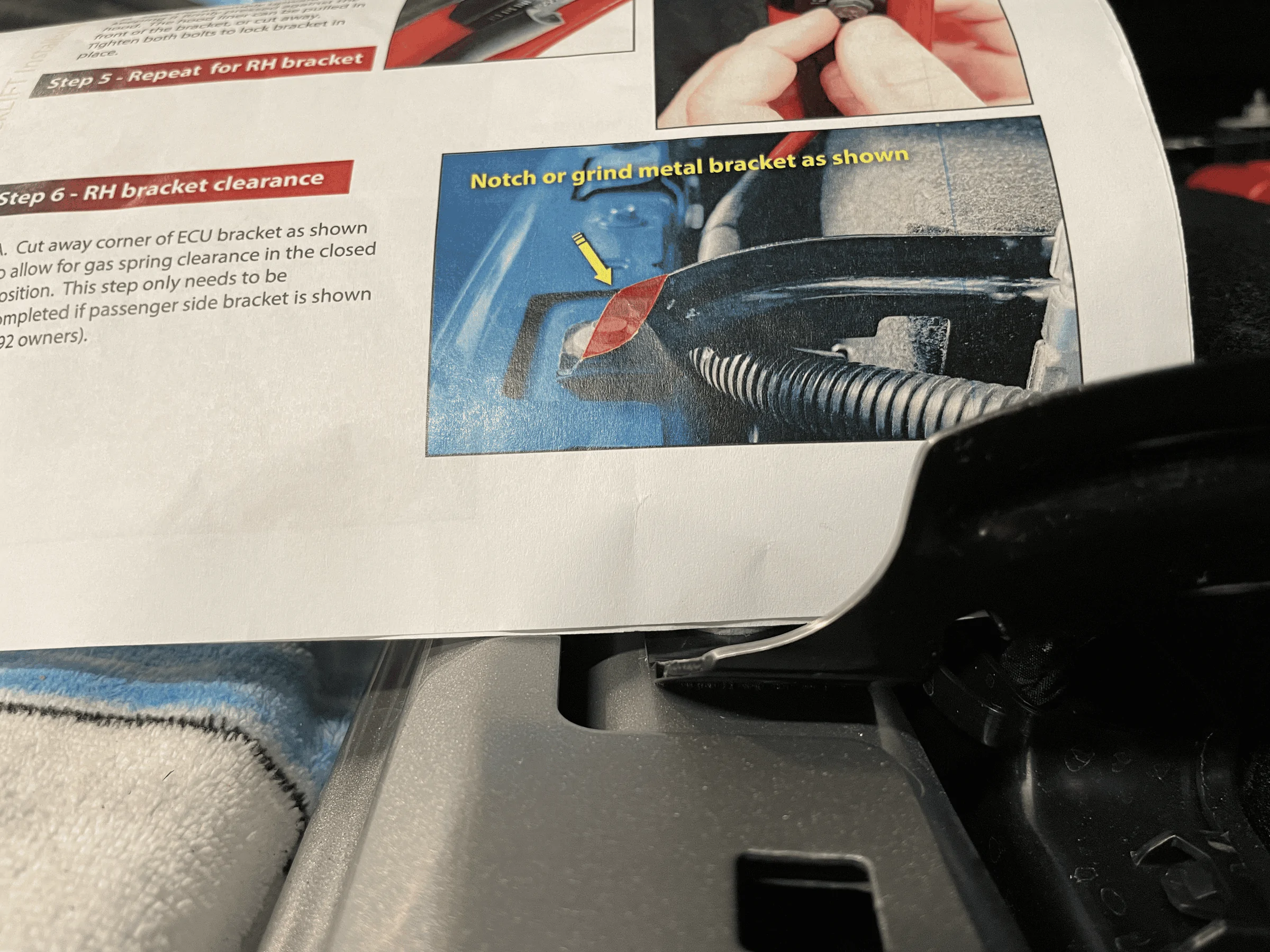

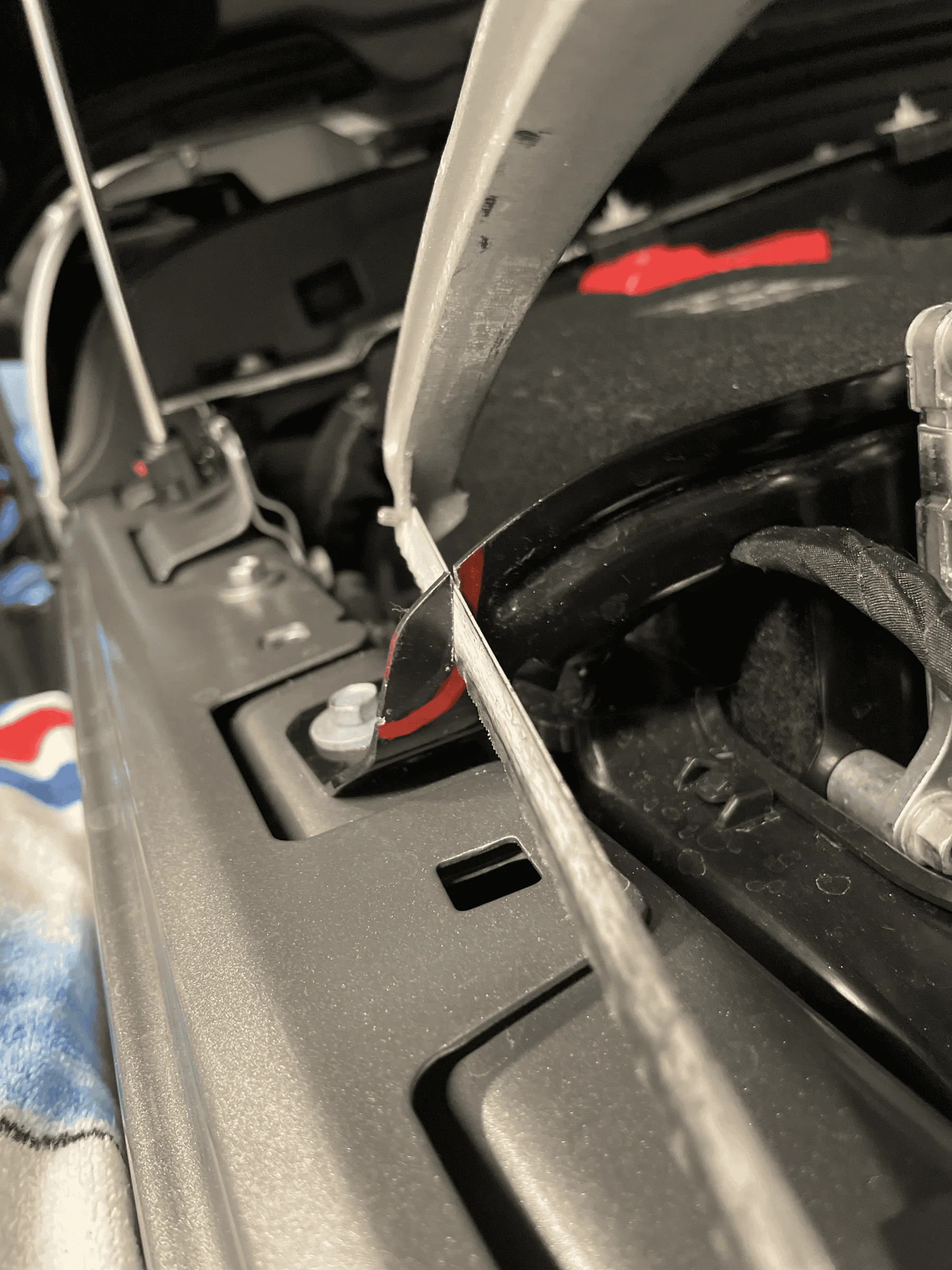

I got the Redline tuning hood struts. So glad I did. Super easy install but you do have to make a small cut on the right side for it to clear. But easily done with a dremel

Yep! And grab yourself a little bottle of black touch up paint or sealant of some sort for the small edge of exposed metal on the bracket for a cleaner look, and to prevent any future corrosion.

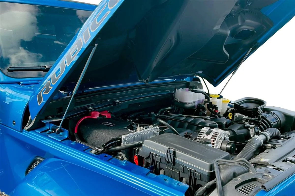

@Redline Tuning a Forum Sponsor has a hood lift system for the 392 and other JL's and the JT.
Well worth the $. Install is easy and geeeez, what a pleasure to have,,
https://www.jlwranglerforums.com/fo...able-specifically-for-the-wrangler-392.72500/
Absolutely a “Must Mod” for the Rubicon 392 owner! Before I installed the Redline Hood Struts, I was lifting the 26 lb. hood high above my head with one hand while reaching for the Prop Rod with the other hand -- it was a “stretch”. Just two hacksaw cuts and some filing with a half round file was all it took. Finish with some black touch up paint and you’re done.
