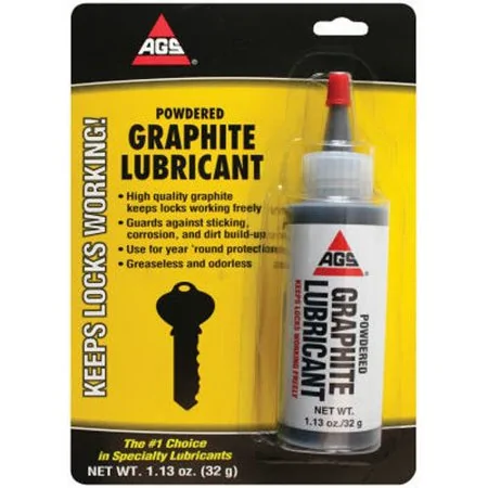

One should take care what lube they use, dust and dirt can stick to oil based lube. I've had trouble with locks in the past with this. As
@Ma$$iveDebtAche posted above the dry graphite lube is what I've learned works best though I doubt it will help with a seized lock. YMMV
