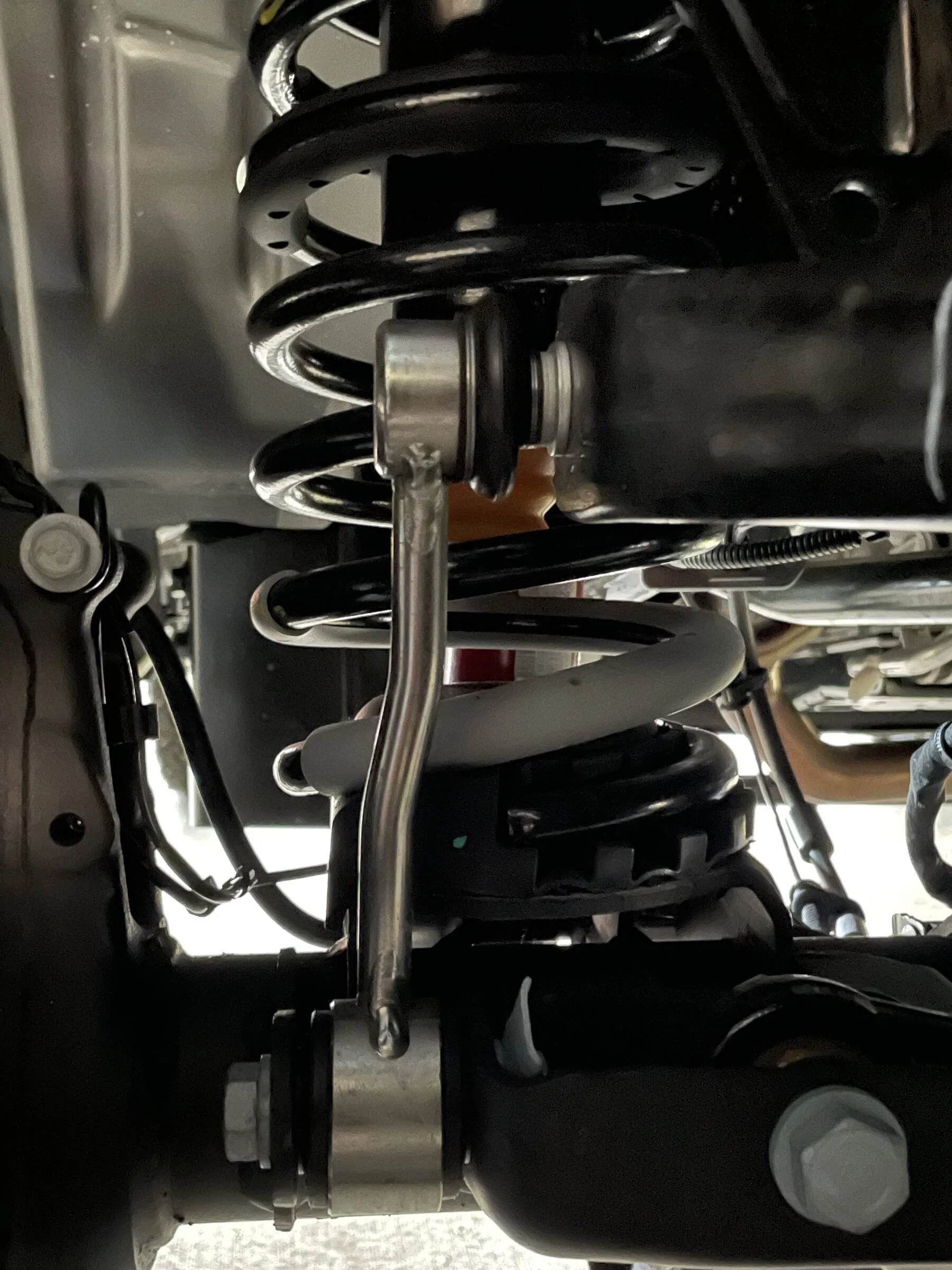

Jeep Wrangler JL High tide XR IMG_2427
found this picture it’s somewhat hard to see. I’ll take a different picture when I’ll get off work. But that bump stop is pretty long.

Yeah, it’s hard to tell how much space there is between them, but your rough ride on the trail is probably because you’re in your bump stops to much….. until you create a little more space there, new shocks aren’t going to help…..
