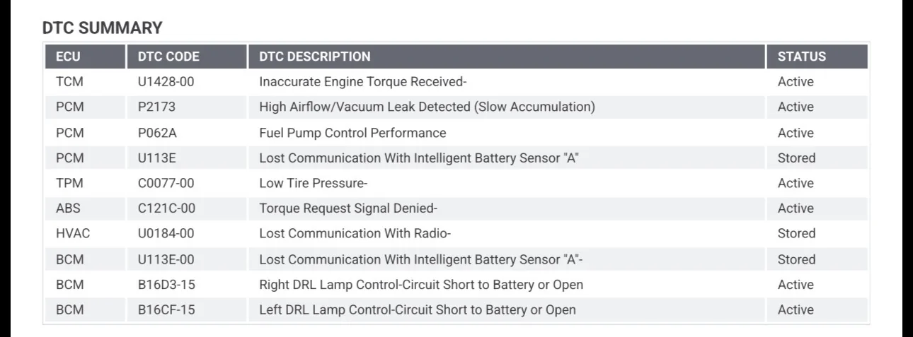

What should be checked for these error codes?
The ETC light comes on occasionally, and the battery voltage fluctuates between 13.2V and 14.0V.
Jeep Wrangler JL Help with error codes IMG_1886

It looks like communication errors caused by a low/bad battery. Battery voltages between 13.2V and 14.0V indicate your alternator is charging the battery. If you have ESS, check both batteries. Communication errors caused by a bad battery or electrical connection yield a large variety of phantom error codes.
For a Jeep JLU, a normal battery voltage reading while driving is typically between 12.5V and 14.5V. When the engine is running, voltages around 13.7V to 14.7V are considered normal, while a fully charged battery at rest should measure about 12.6V to 12.8V.

Have you done any other work to the vehicle recently?
Do you have any reason to belief that the codes all came up at the same time?

I replaced:
  • New alternator
  • New auxiliary battery
  • New main battery
  • New throttle body
  • New low-pressure fuel pump
All other fault codes have been cleared. Now only P062A remains.
