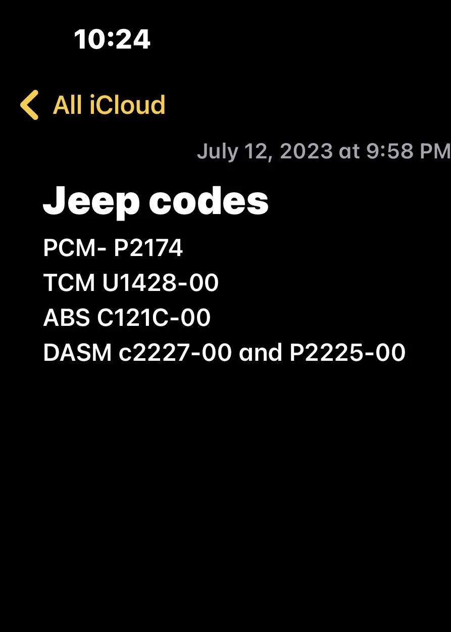

Hey y’all, was driving my rig back from the store and when it was building boost in 2nd gear it lit up like a Christmas tree and went into limp home mode. I pulled in to an empty lot and tried to shut it off and turn it on again but that didn’t fix it so I used the error code viewing feature and wrote down all the codes. My brief search on the forum was inconclusive so I decided to not tow it and just clear the codes for the moment with the tazer. What should I do?
Forgot to add that it drove home fine after clearing the codes but I know this is by no means a long term fix.

not much help with the problem sorry but this is what those codes are for/causes
P2174
Faulty Manifold Absolute Pressure (MAP) Sensor
Manifold Absolute Pressure Sensor harness is open or shorted
Manifold Absolute Pressure Sensor circuit poor electrical connection
Faulty Throttle Position (TP) Sensor
Restricted air inlet
U1428
Faulty Transmission Control Module
Transmission Control Module harness is open or shorted
Transmission Control Module circuit poor electrical connection Faulty Powertrain Control Module
C121C
Faulty Anti-Lock Brake System (ABS)
Module Faulty Powertrain Control Module
C2227
Faulty Antilock Brake System (ABS) Module
Antilock Brake System (ABS) Module harness is open or shorted
Antilock Brake System (ABS) Module circuit poor electrical connection
p2225
NOx sensor failure
Powertrain Control Module (PCM) failure
Wiring issue

Thanks for the advice- I’ll try that asap. I just remembered that I was manually shifting with the auto and that stopped working for a second if that adds to it.

Throwing all those codes at one time means you can’t look at each one and try to diag each code. The odds of multiple systems and modules, failing at the exact same time or pretty much zero instead, you need to look for what can cause your jeep to throw a bunch of nonsense codes at the same time this is always usually something electrical possibly your battery a bad connection, or a loose ground or bad ground somewhere however, in the future, I would highly recommend not clearing the codes unless you can rule out nothing is wrong with the code that you’re clearing. Also, your jeep went into limp mode to protect itself by you clearing the codes and telling the jeep all is good. You could do some serious damage by forcing it to operate in normal parameters when something is wrong , but just to give you somewhere to start it’s gotta be something electrical. And going off of all the codes that itdid throw you will notice a common theme to them all is open circuit or shorted ground. You could try pulling up a wiring diagram to see at what point do all those systems come together as in I wouldn’t be a bit surprised if they all share the same ground or the same fuse, so that is where I would start figure out what do those systems have in common and where do they come together then you will find your issue. I am going with a bad ground or shorted wire coming from a fuse that they all share.

Without understanding what these codes even mean, the only advice that can be given is misdirection. Several of these faults relate to engine torque request failures, the primary fault is the low air flow. Has your air filter collapsed?
