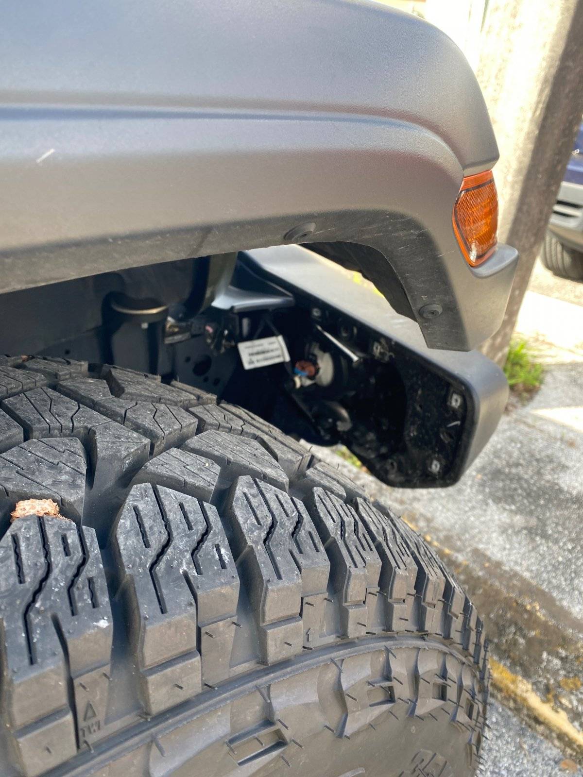

I recently put wheels and tires on my wife's jl and I had to remove a piece from behind the fog light assembly because of rubbing. Now that I have done that, the back of the fog light and the wires are all exposed. Is there a flush piece that I can buy to cover up the area that is exposed? Thank you for any help.
Jeep Wrangler JL Help please IMG_0304

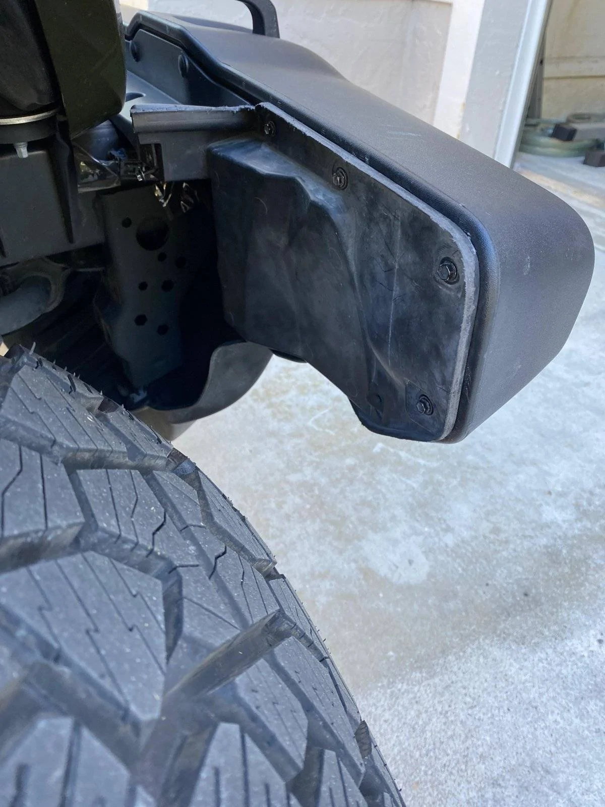

Trim the pieces you removed and replace to cover the rear of the fog lights. Here is what I did.
Jeep Wrangler JL Help please bumper

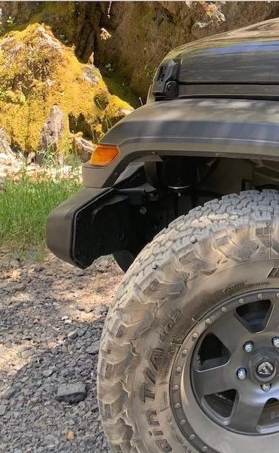

When I had my stock bumper on, I decided to trim the close out panels. Used a bright marker to follow the lines/ outline so that it would sit nice and flush with the bumper. Used a Dremel to trim them and then sanded it gently to smooth out the lines.
You should be fine either way.....I'm running the steel bumper now and it does not have a close-out panel option. Been just fine.

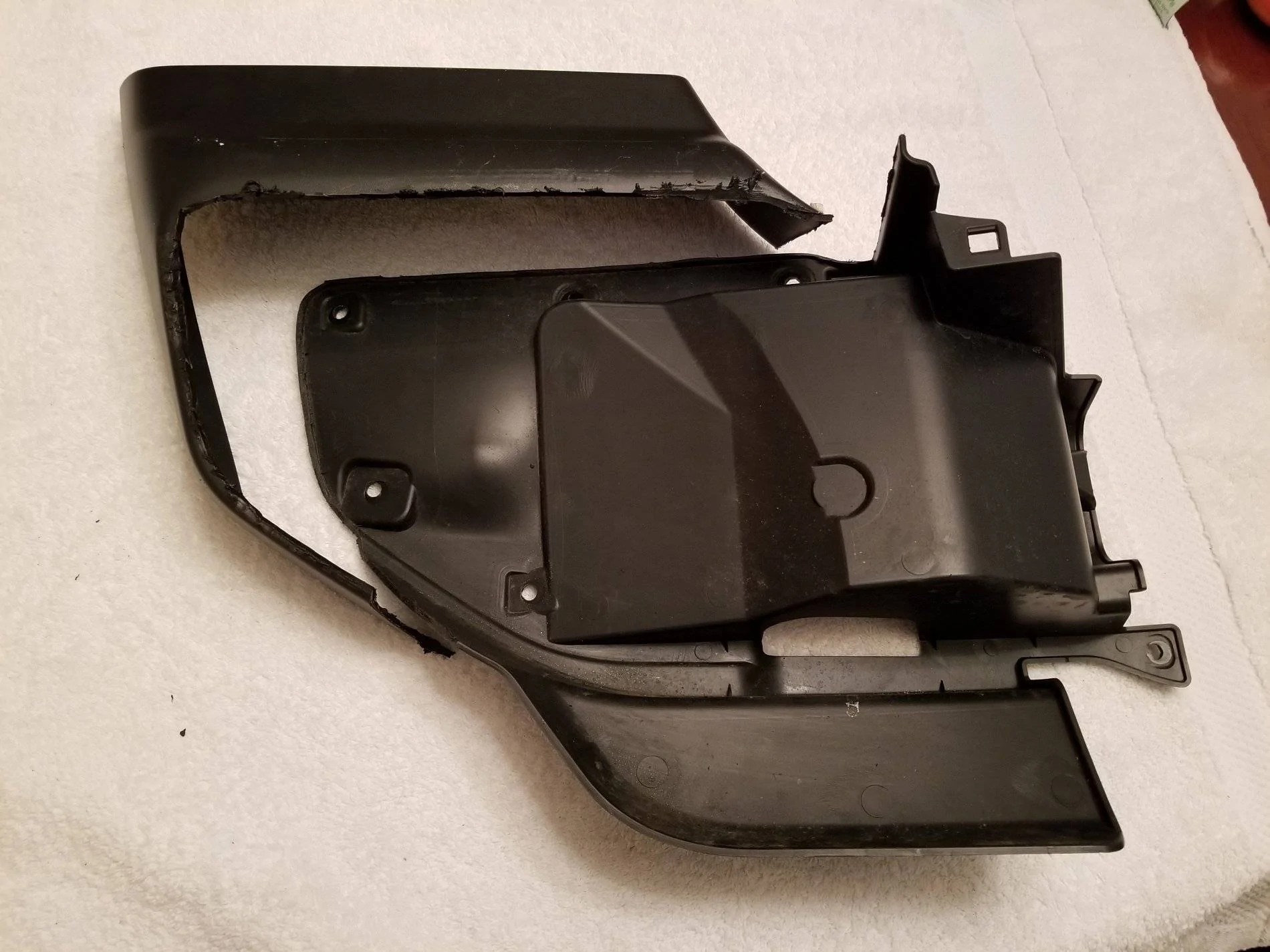

Trim off the offending bumper extensions with a dremel to create your new "covers." Smooth any rough edges with sandpaper.
Jeep Wrangler JL Help please 20190218_174737
