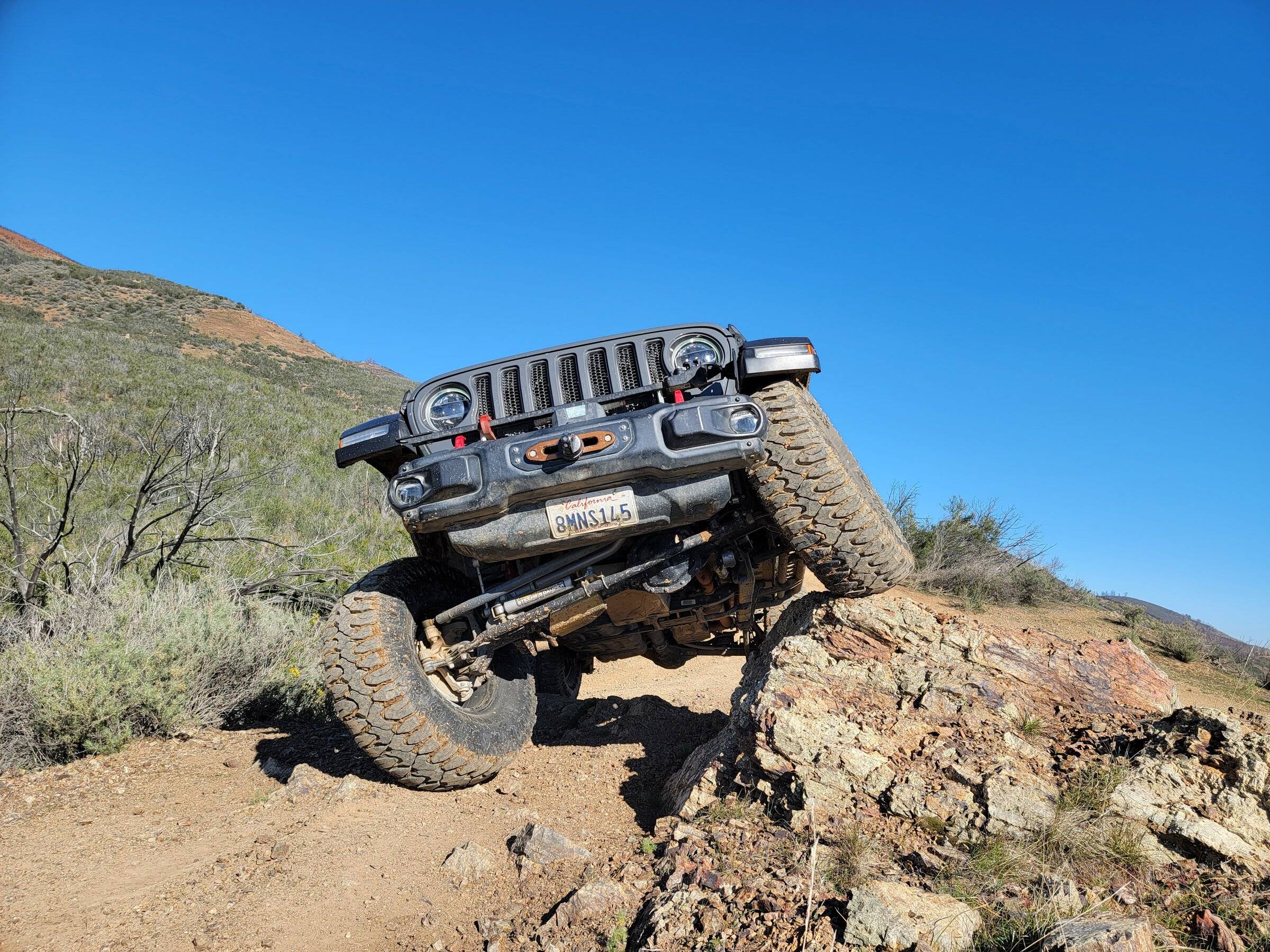

Some guys hate the hi lift, I wouldn't wheel without one. Mainly used for recovery, but also beneficial for jacking the jeep high enough to get a tire up out of a hole it's wedged in, moving the jeep laterally when need be and it's pinned between big rocks, or even using the handle to sleeve a bent track bar or drag link. The hi lift has bailed me out of every one of those situations where a bottle jack is useless. Ours is mounted on the front bumper above the winch.
