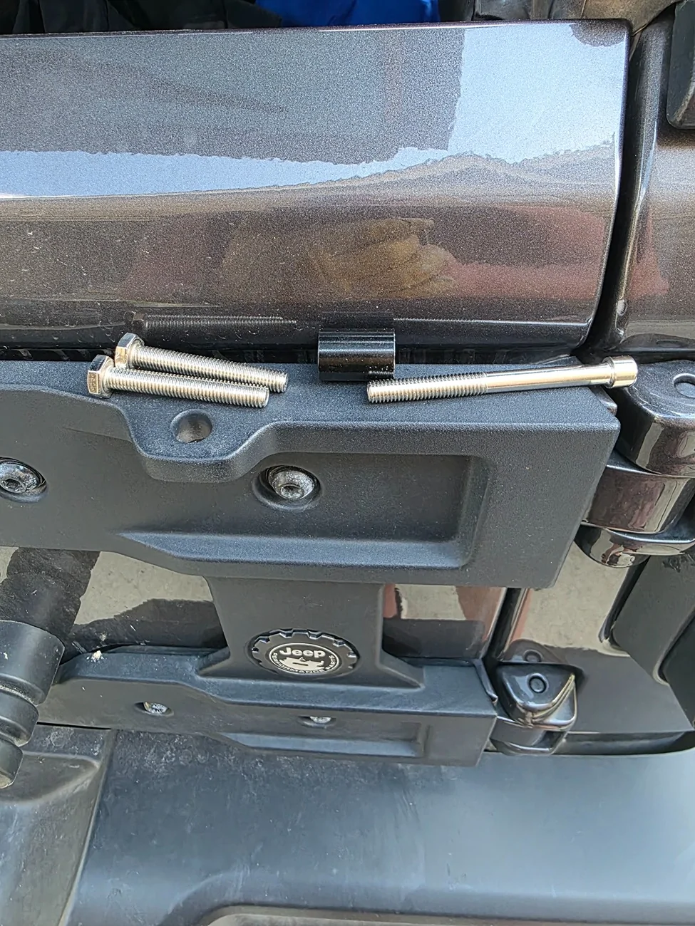

I'm trying to find the best tailgate Hi-Lift jack mount that is compatible with my 2025 Wrangler JL Willys. This is what the back looks like. I have Rubicon style wheels and tires (I think the tires are 33). I know they are bigger than the stock tires. I just need to know which one would fit this set up. Any help and advice would be greatly appreciated.

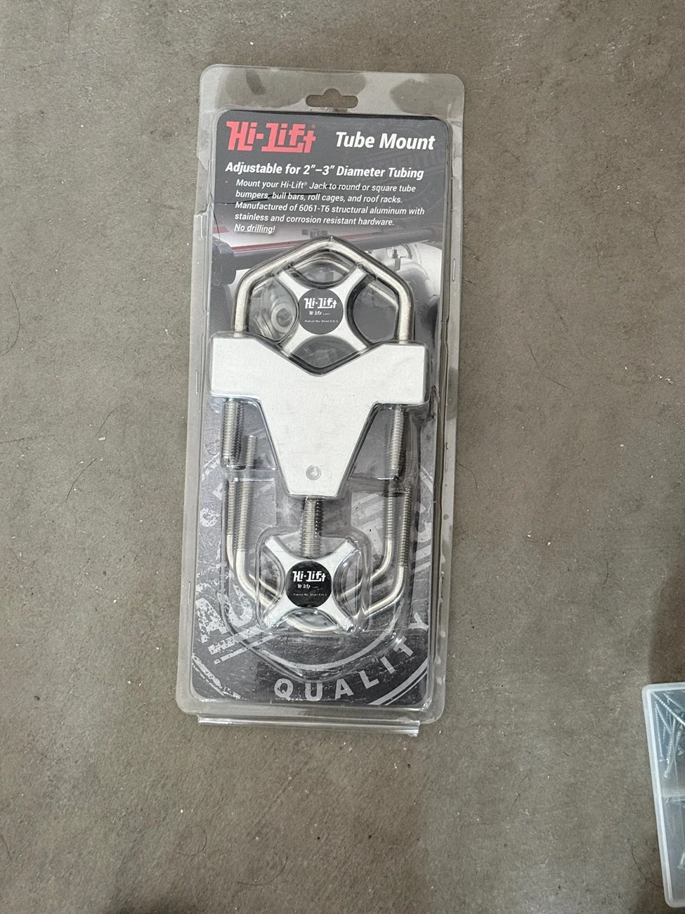

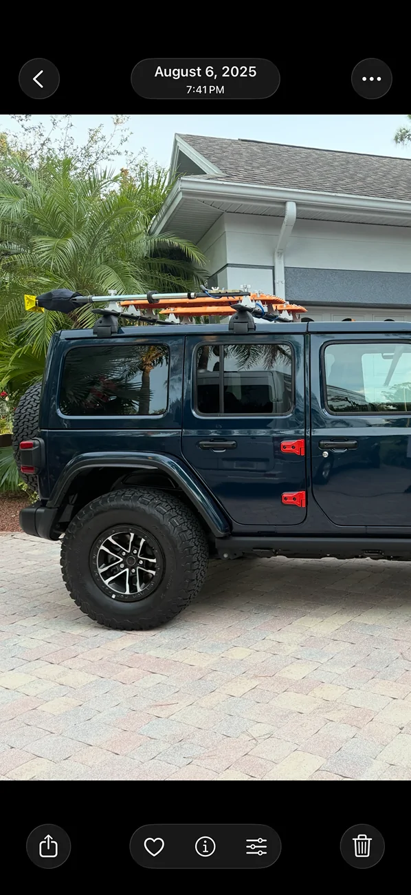

I use this top mount set up which is rock solid for the longest H lift

Have you considered how you would use that jack? It looks like you have factory front/rear bumpers and rails. None of those are good for using with a Hi Lift.
The Terry is worth repeating...
I see a lot of Jeeps adorned with Hilift jacks with no points on the vehicle capable of safely accepting a Hilift for jacking.

I originally purchased it as a backpack to the winch and I have an accessory that lifts the tire in addition to an accessory that makes it compatible
