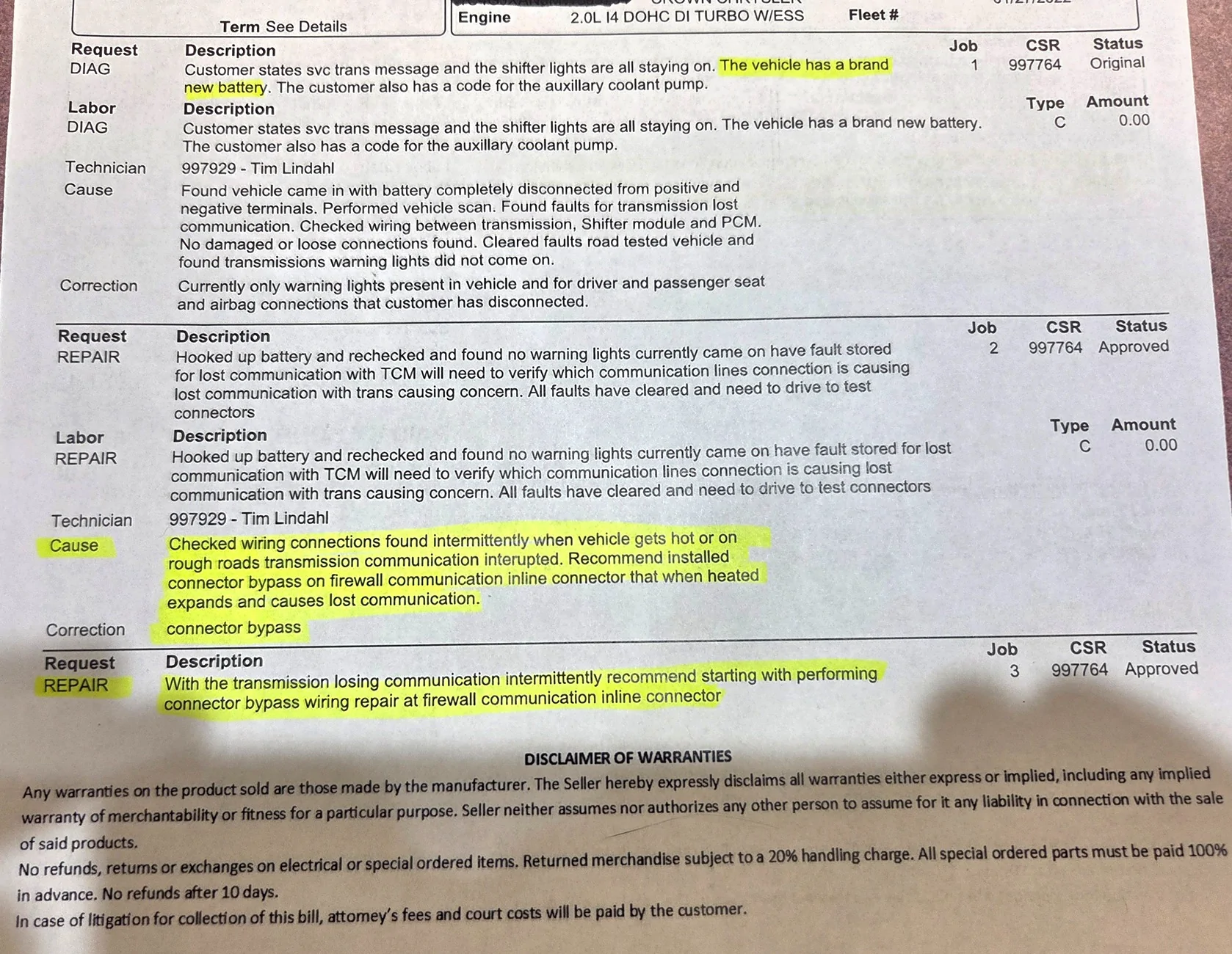

I have a 2021 2.0 Turbo model sport s that has been the absolute bane of my existence since I purchased it new in 2021 I have had so far to replace the fuse array had to take it to the dealership two different times for electrical issues the first issue was service transmission wouldn't come out of park couldn't turn on or off and all the lights were lit up on the shifter. The dealership fixed that problem in May of this year I can't remember what they said the issue was but it was something to do with a wire being loose or something. Fast forward to December I am now having a service shifter error with every single light on my Dash flashing gauges going crazy etc. All out of nowhere someone mentioned the can bus plug in but I'm not sure if that's what I'm dealing with any help would be great I have about 160,000 Miles on it.

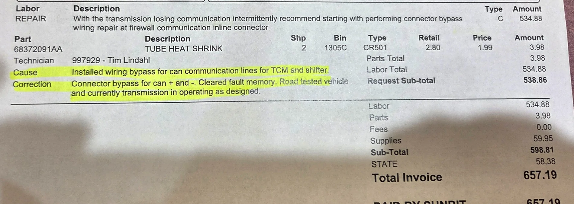

Here is the notes from the dealer from may.
Jeep Wrangler JL HELP! Electrical issues. :( 20251204_140354
Jeep Wrangler JL HELP! Electrical issues. :( 20251204_140444

Here's the notes from the dealer I still dont know exactly what they did but it fixed it from may. I am not getting a service transmission code anymore like when they fixed it before. Only service shifter and all gauges losing it.

The repair they did is not uncommon. There is a connector behind the front passenger wheel well that can become problematic with open circuits. The two canbus lines go through that connector and can become intermittent, causing havoc to the module communications.
But you now have another similar problem, or possibly the same problem. Seems they fixed it once, why not take it back there? They seem competent.
