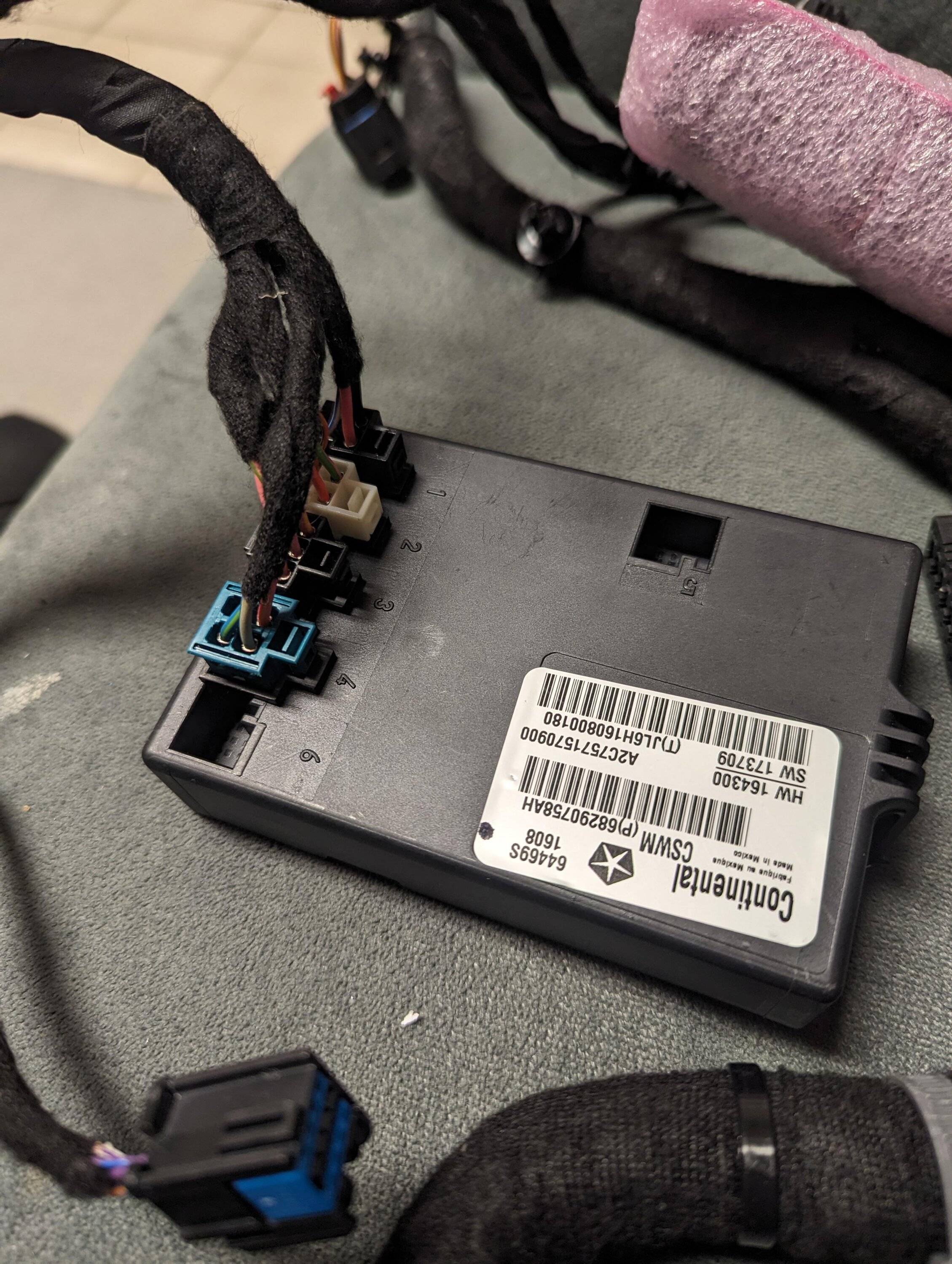

If I understand correctly, if you have a the HVAC control Unit, a set of OEM Heated Leather Seats, get the correct harnesses from Mopar, it should be play and play?

Well, not exactly. With the parts you have listed you still need the heated seat control module and the wires to connect it. Your dash harness won’t have the wires and connectors for the module. Rick, @RAMSTEEL bought a dash harness and dug out the wires needed, I built the harness needed and posted pictures of it above. I used the spreadsheet posted by Rick to build it.
Getting seats with the heaters in them already saves the work of stripping seats to add the pads.

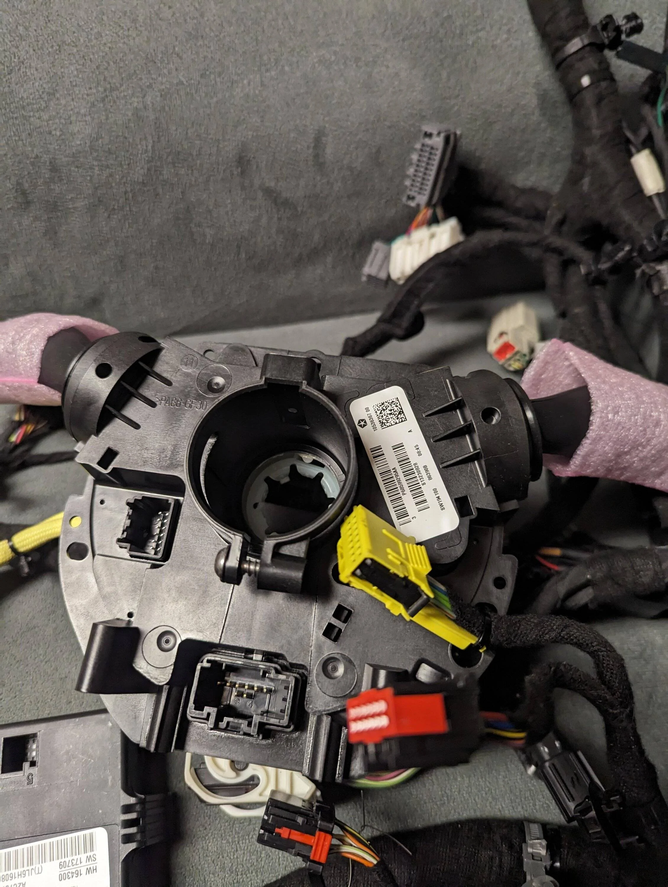

Ok found a used heated wheel from a 2020 Sahara.... the connector for the heated steering is only those two pins.
I found a steering column switch (matching my options + added heated wheel) with the heated steering wheel option
i found a donor dash harness with heated seats and steering wheel to include all of the connectors going to the seat and steering wheel module and the can bus. Unwrapping the connectors i need to extract the wires i need to add to mine.

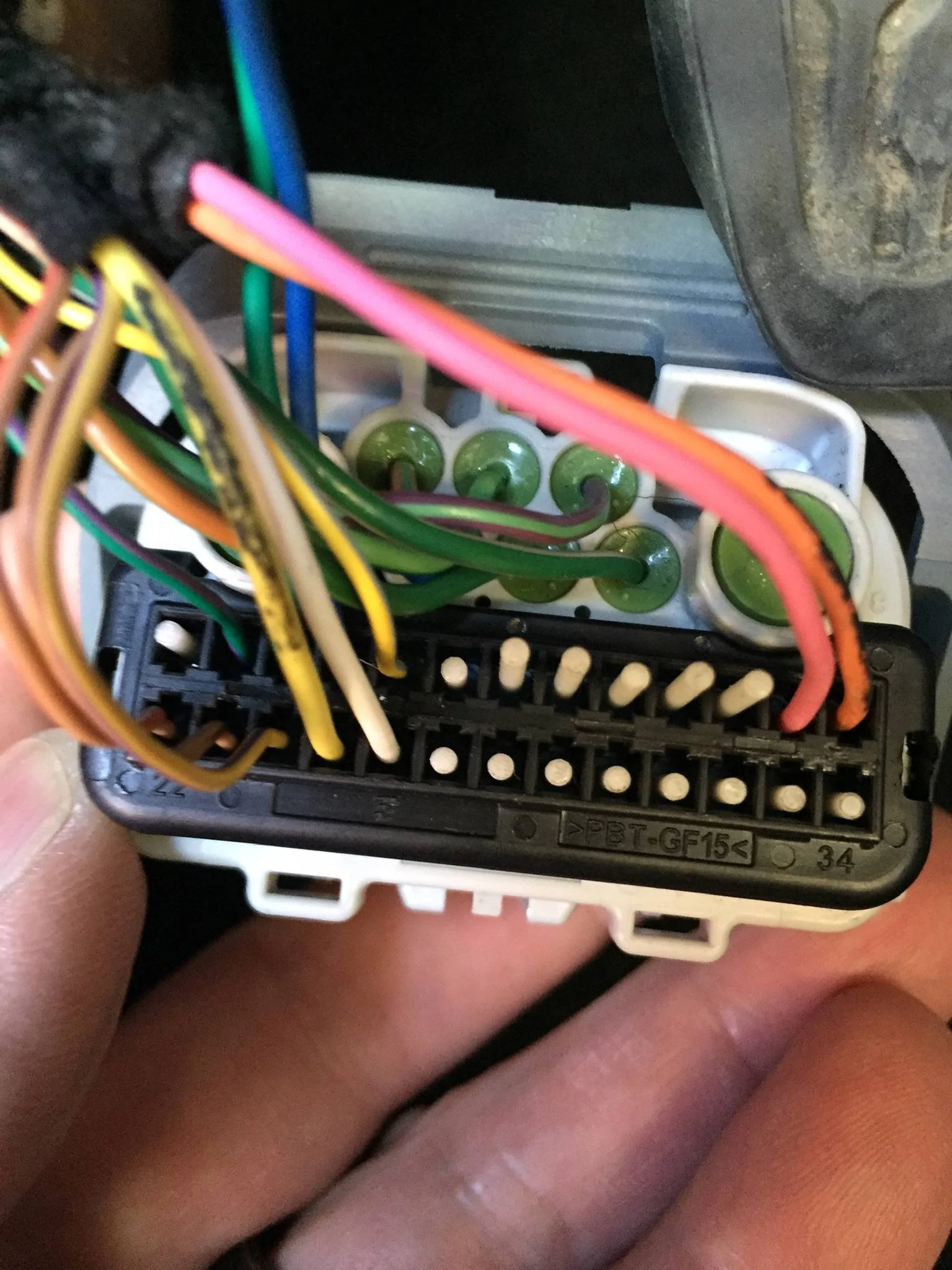

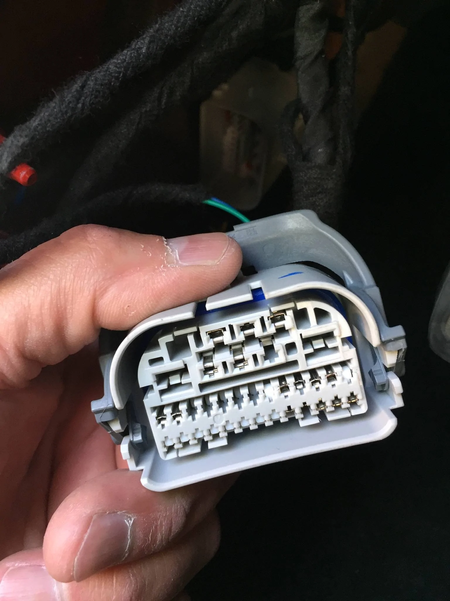

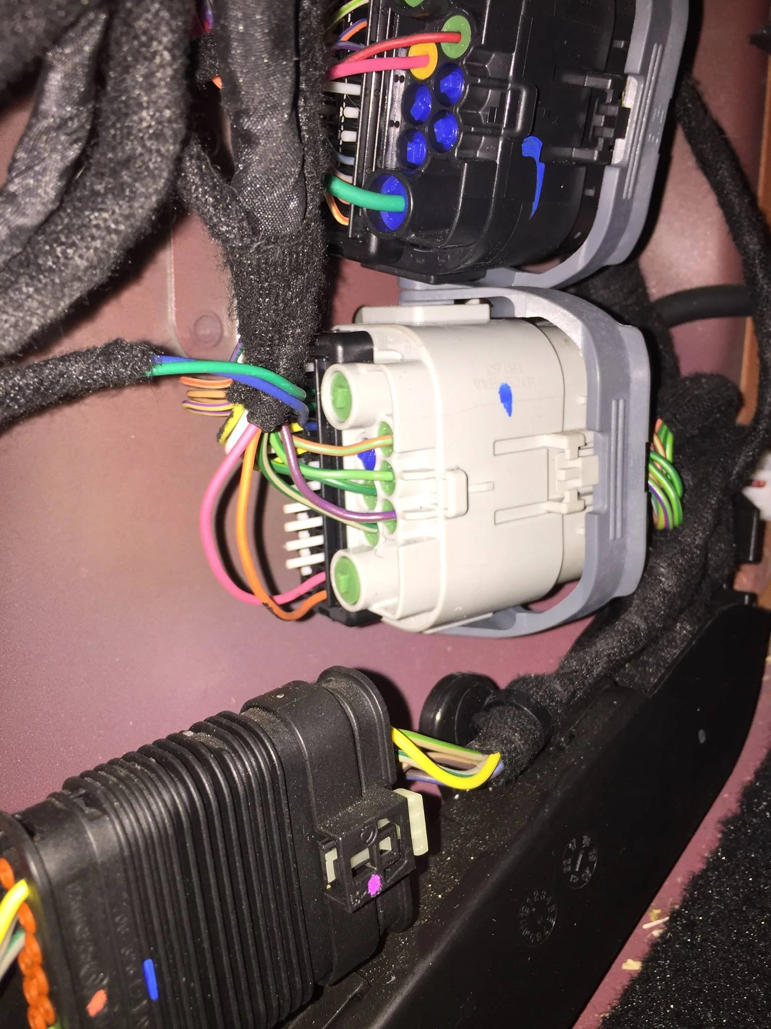

The seat heat wires are going to go to these connectors in the drivers side kick panel, the power for the system will come from the same connector in the passenger side kick panel.
Jeep Wrangler JL Heated Steering Wheel - It can be done. E89AAD2D-4FD5-4603-95E6-66381026BD47
most of the wires are in the white connector, that is XY315A. The black one above it is XY301A
Jeep Wrangler JL Heated Steering Wheel - It can be done. 8628F7E2-F6BA-4C55-B038-0BAF88BBF813
Most of the wires go in the top row of small wires, the orange wire is in 21, the pink wire is in 20, the wires you will add are IIRC 15 to 19
Jeep Wrangler JL Heated Steering Wheel - It can be done. EA214F36-C45F-4799-B97F-260525F0155B
Jeep Wrangler JL Heated Steering Wheel - It can be done. 01EC6D20-DC93-4333-BD8B-5D5C612B1B26

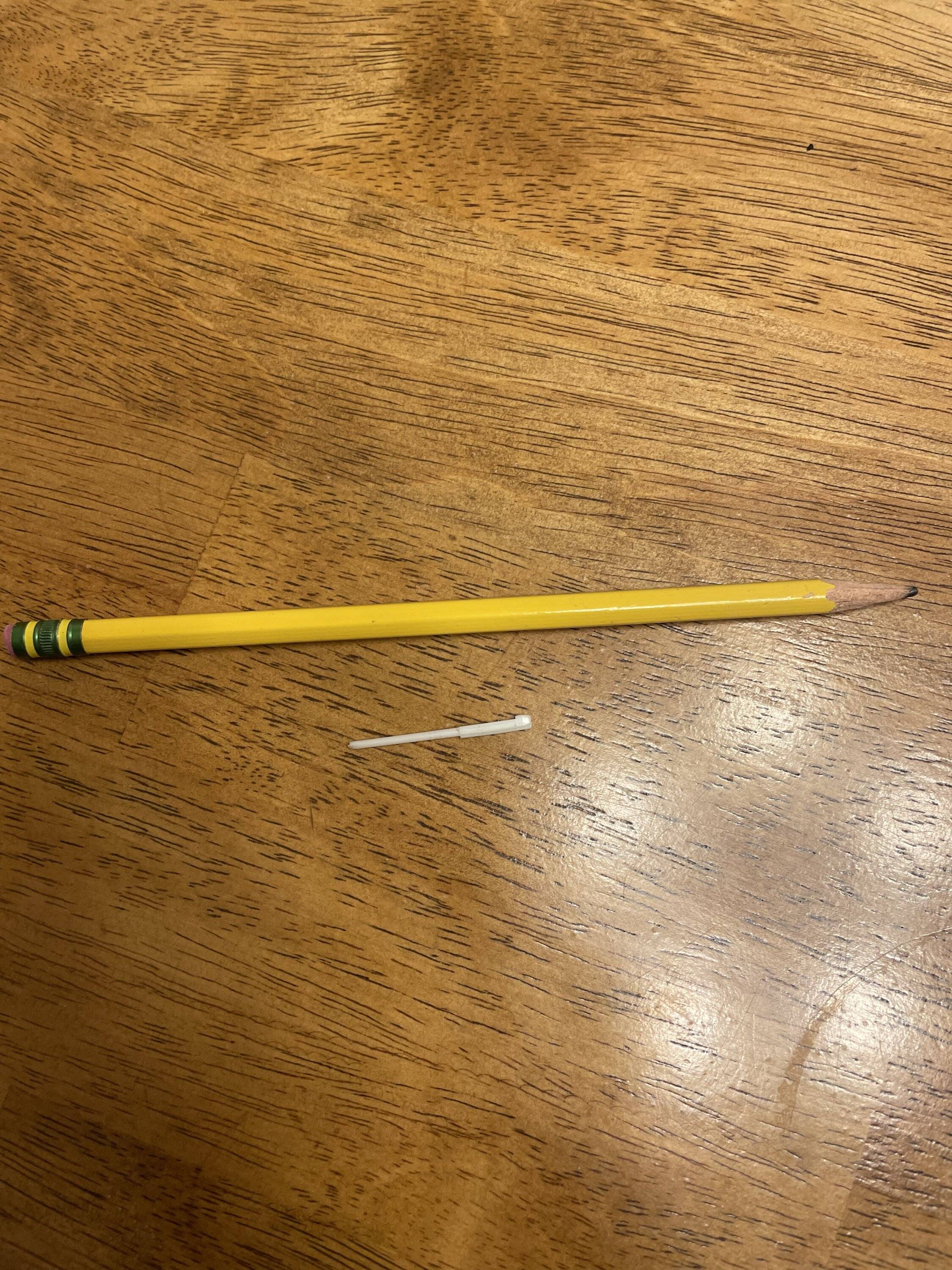

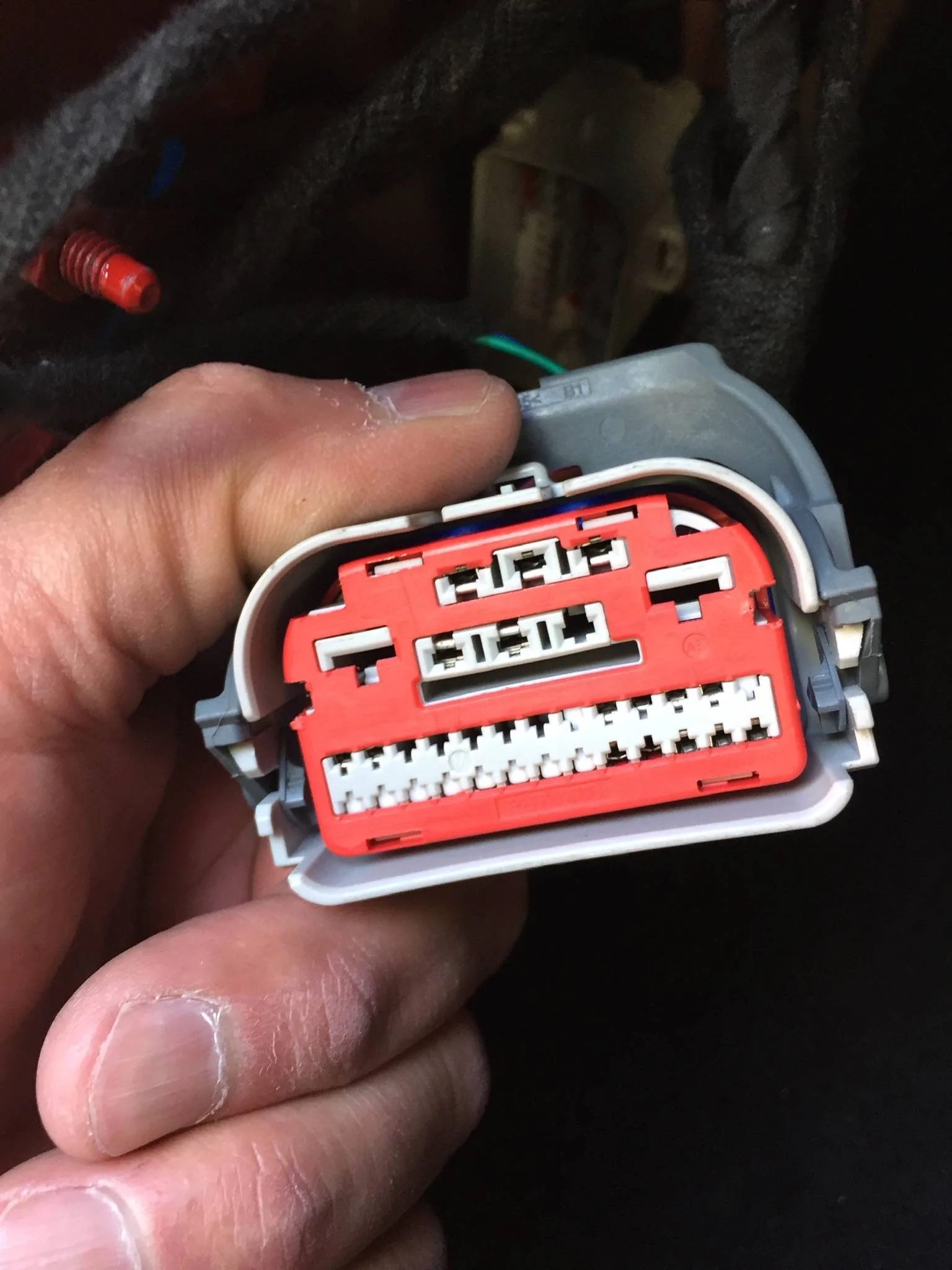

Pry out that red terminal lock and use a straight pin or sewing needle to lift the lock and pull the little white cavity plug out the backside and insert the wire till it seats
Jeep Wrangler JL Heated Steering Wheel - It can be done. 45535A21-8895-4D85-91CC-1BA4C6710451
that is the little plug that is in the connector (sometimes it is a brown wire that is a couple inches long that goes nowhere)

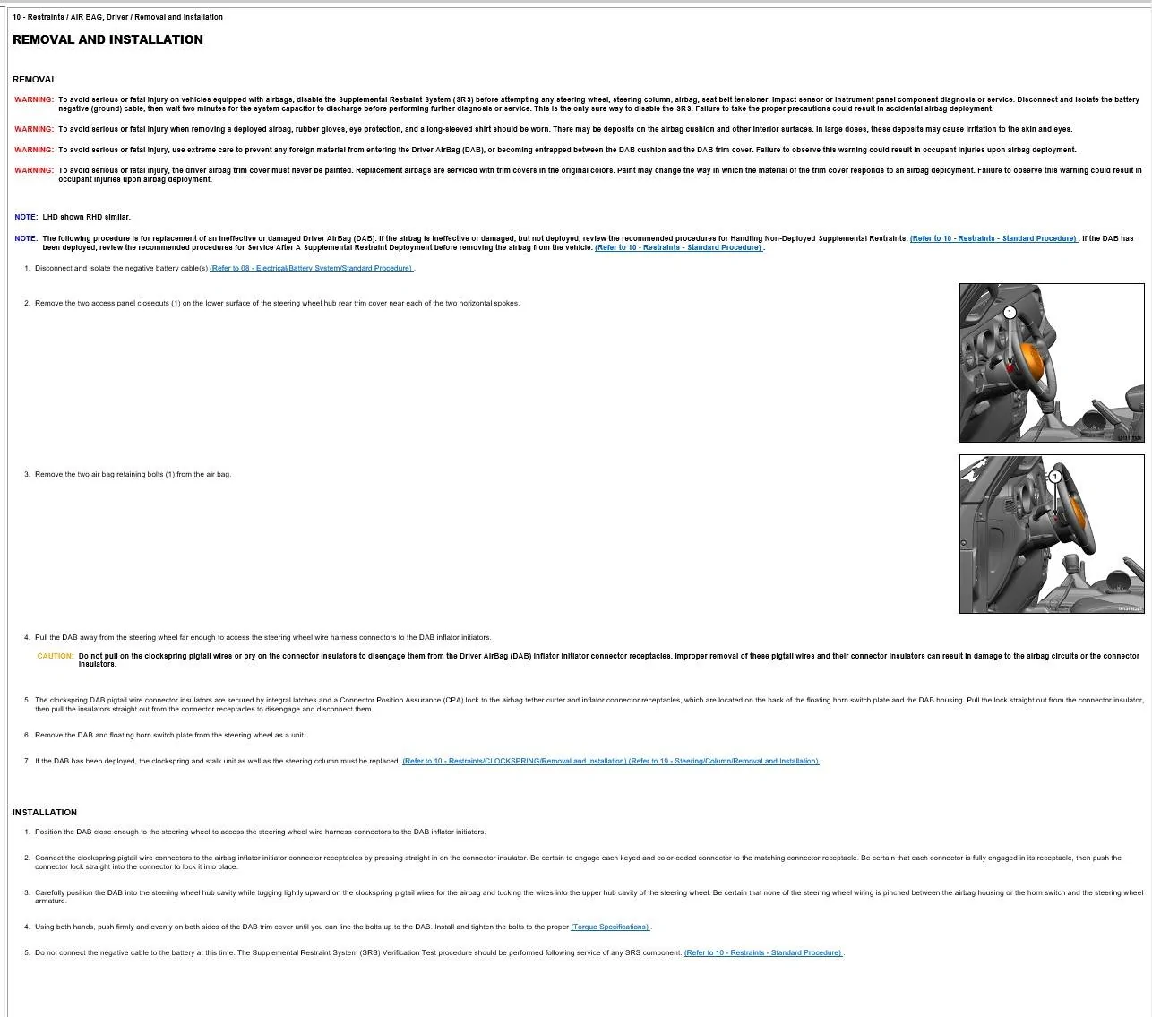

For others interested in doing this i found the remove and install instructions for the JL/JT steering wheel Airbag.... almost the same as JK but different enough you don't wanna mess it up lol.
Jeep Wrangler JL Heated Steering Wheel - It can be done. SRS Removal and Installation

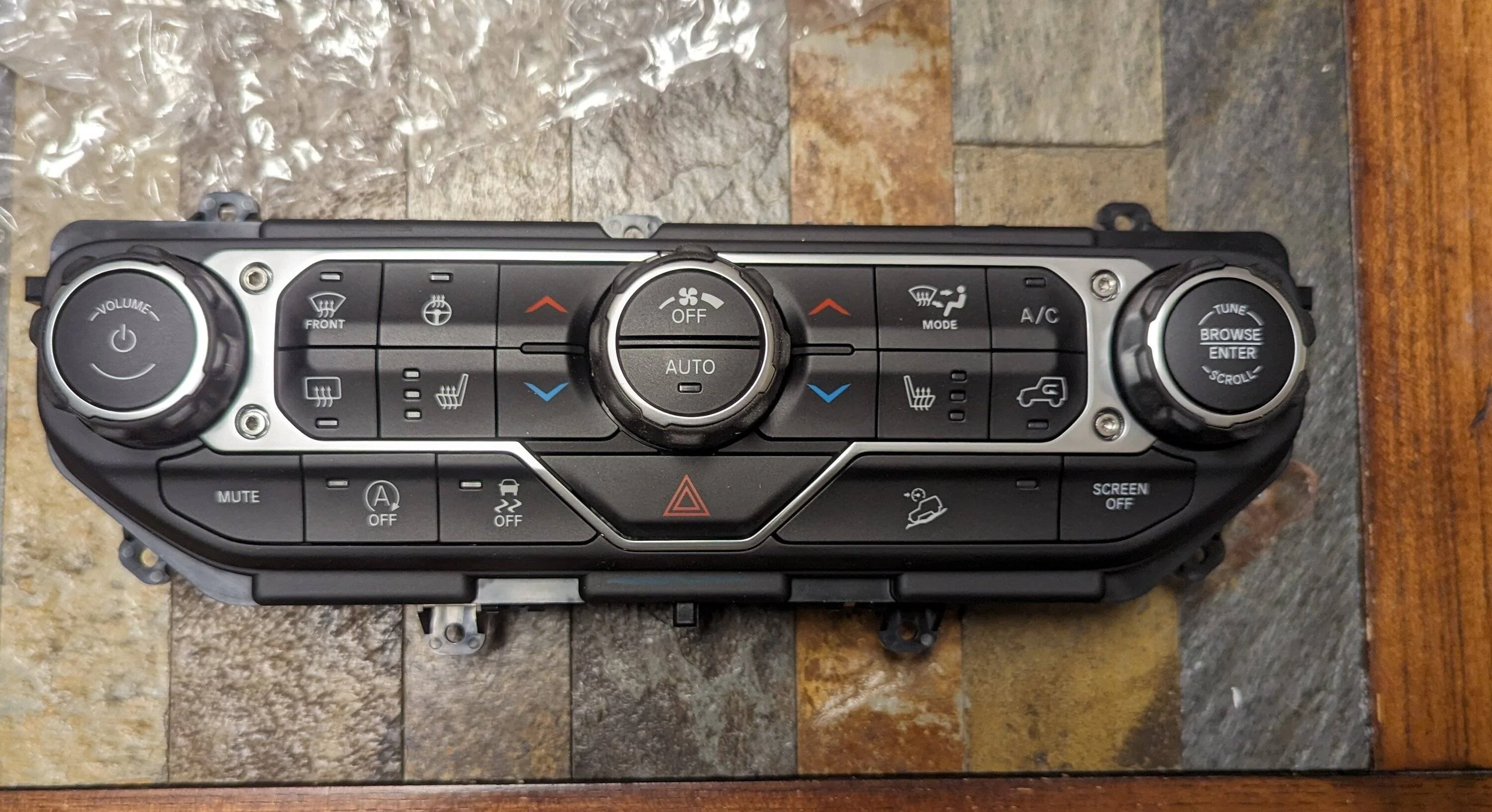

For the 2018 there are two PN that might be the one you are looking for. I think X81 is the factory base code that all jeeps have added.
Codes related to center stack( I think this captures the earlier years..... Hill Descent was swapped out for something else later)
BNH Hill Descent
BNB Electronic Stability control
GFA Rear Defrost
GTB Defrost mirrors
HAA HVAC Manual
HAB HVAC Auto
JPM Heated Seats
NHS Heated Steering wheel
RTF Radio volume/mute and tuning
XAA Parking Assist
for the 2018s these were the 2 # that had similar codes to what you have.
6BE26DX9AC Center Stack
Part Description
Control
  • [X81], [HAB], [RTF], [JPM], [NHS], [BNH], [GFA] AND/OR [GTB]
6BE30DX9AC Center Stack
Part Description
Control
  • [X81], [HAB], [RTF], [JPM], [NHS], [GFA] AND/OR [GTB]
For my 2020 this was the one i needed/purchased
Jeep Wrangler JL Heated Steering Wheel - It can be done. 6SX71DX9AB  Center Stack 2020 JLU
Part Description
Control

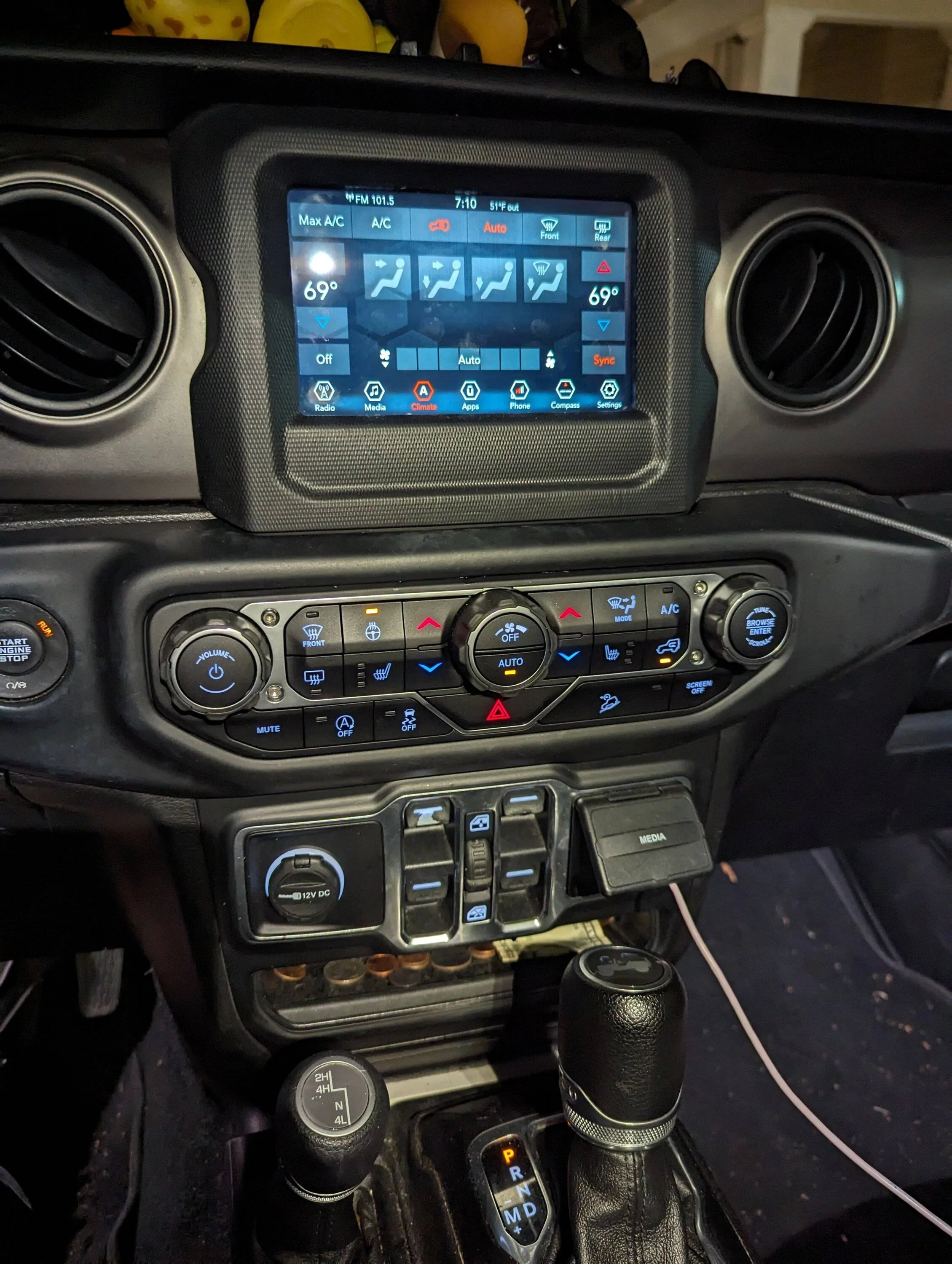

ok update .
1. Sensors installed and HVAC mod sensors installed. harness was there so pop out and replace correct sun sensor, install temp sensor to existing harness.
2. piggy back harness Installed in dash. hardest part was wiggling harness from left to right side of dash behind center stack and going around glovebox. since I labeled all the wires was easy to put them into connectors one at a time
3. installed new clock spring and heated wheel and added the wires to the steering heat.
4. put the new center stack in .
5. reconnected batteries.
6. JScanned everything to turn it on.
7. drove it around to confirm no problems , no extra lights.

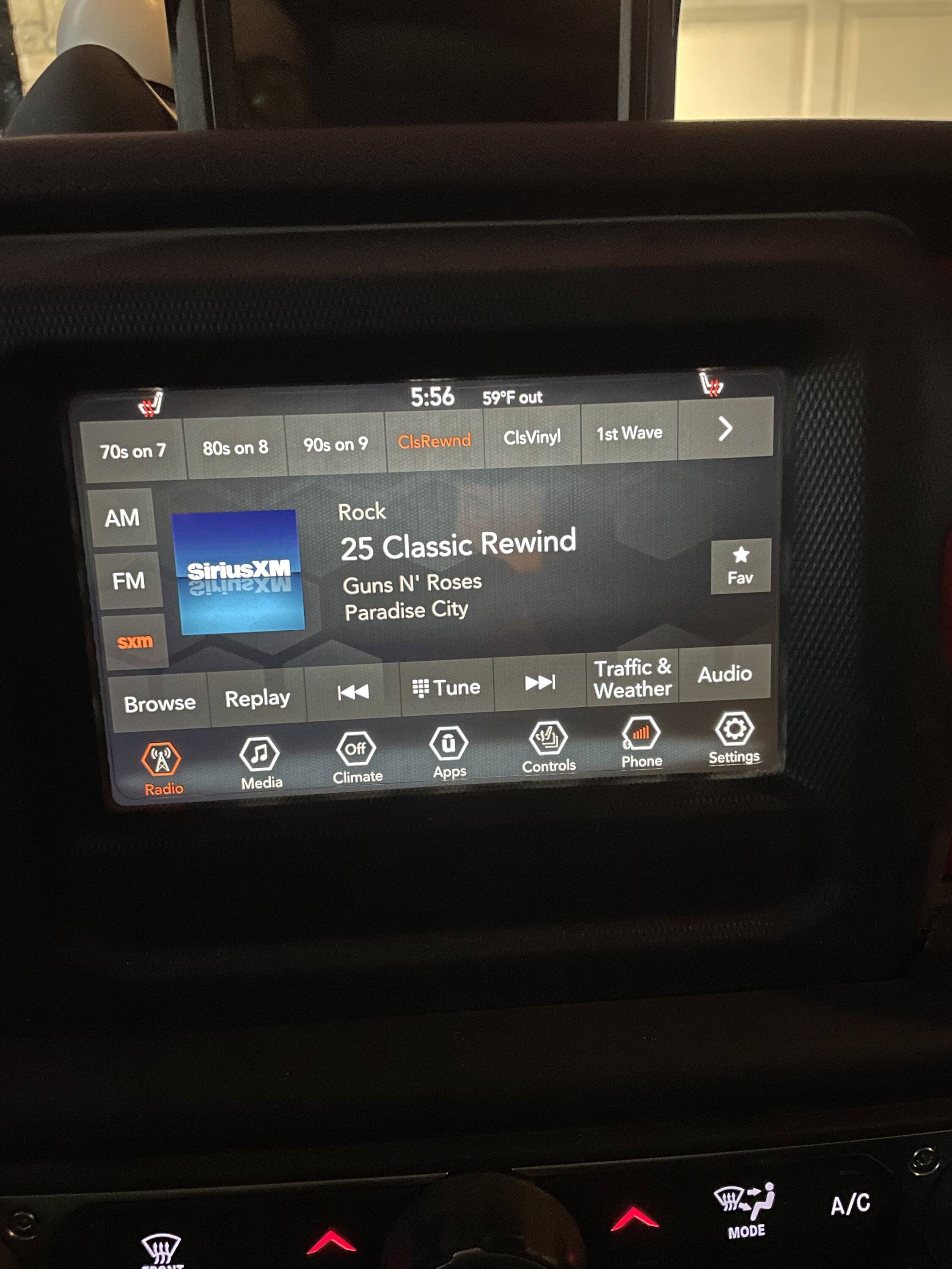

8. HVAC showed up on 7 inch u connect after 3-4 cycles.
no heated seats yet waiting on more parts... but everything is there . heated Steering wheel is a big hit .
did heated seats and steering icons eventually show up on Uconnect for others? now just to wait for the last parts for the seats and to install them later ?

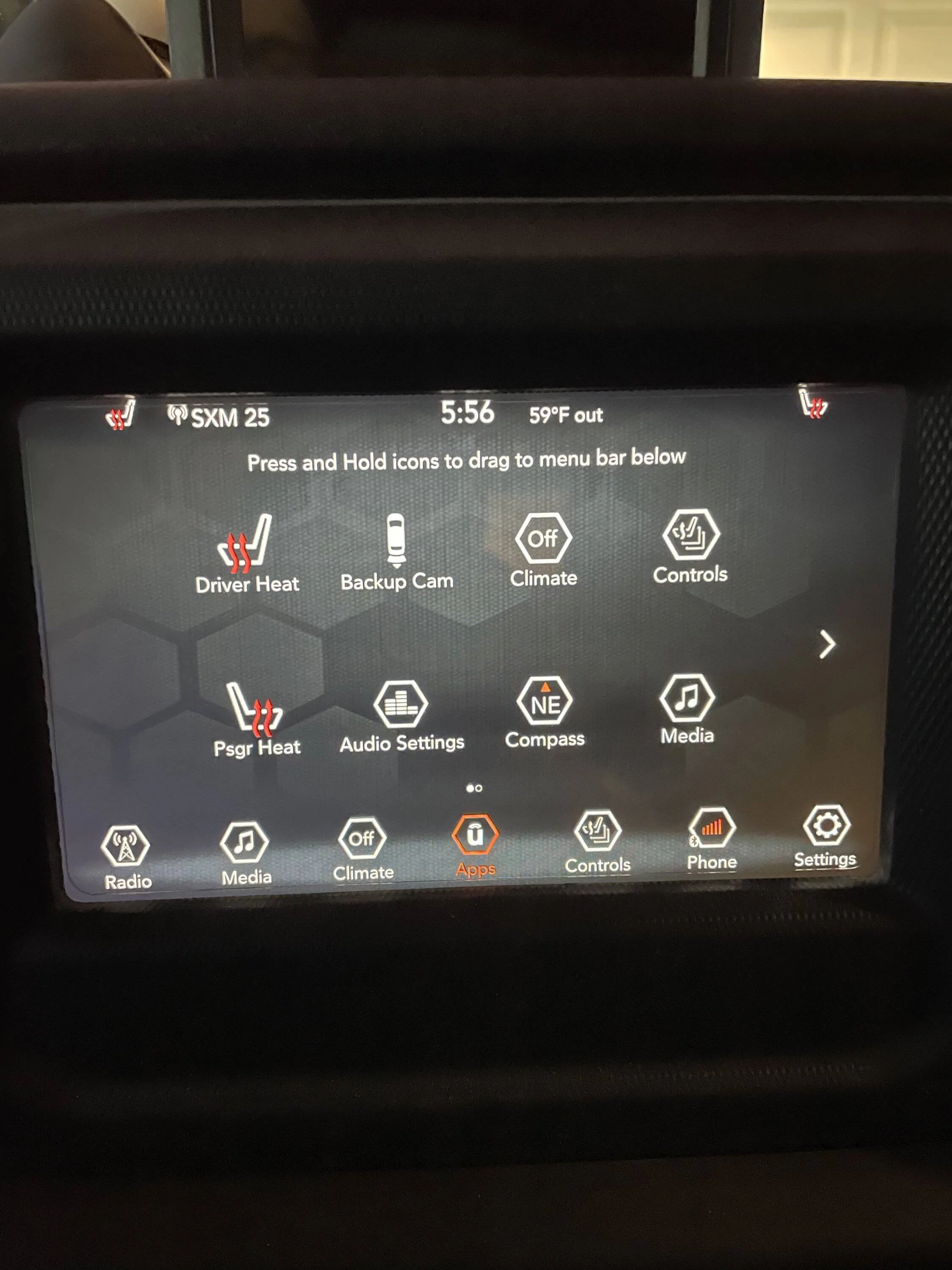

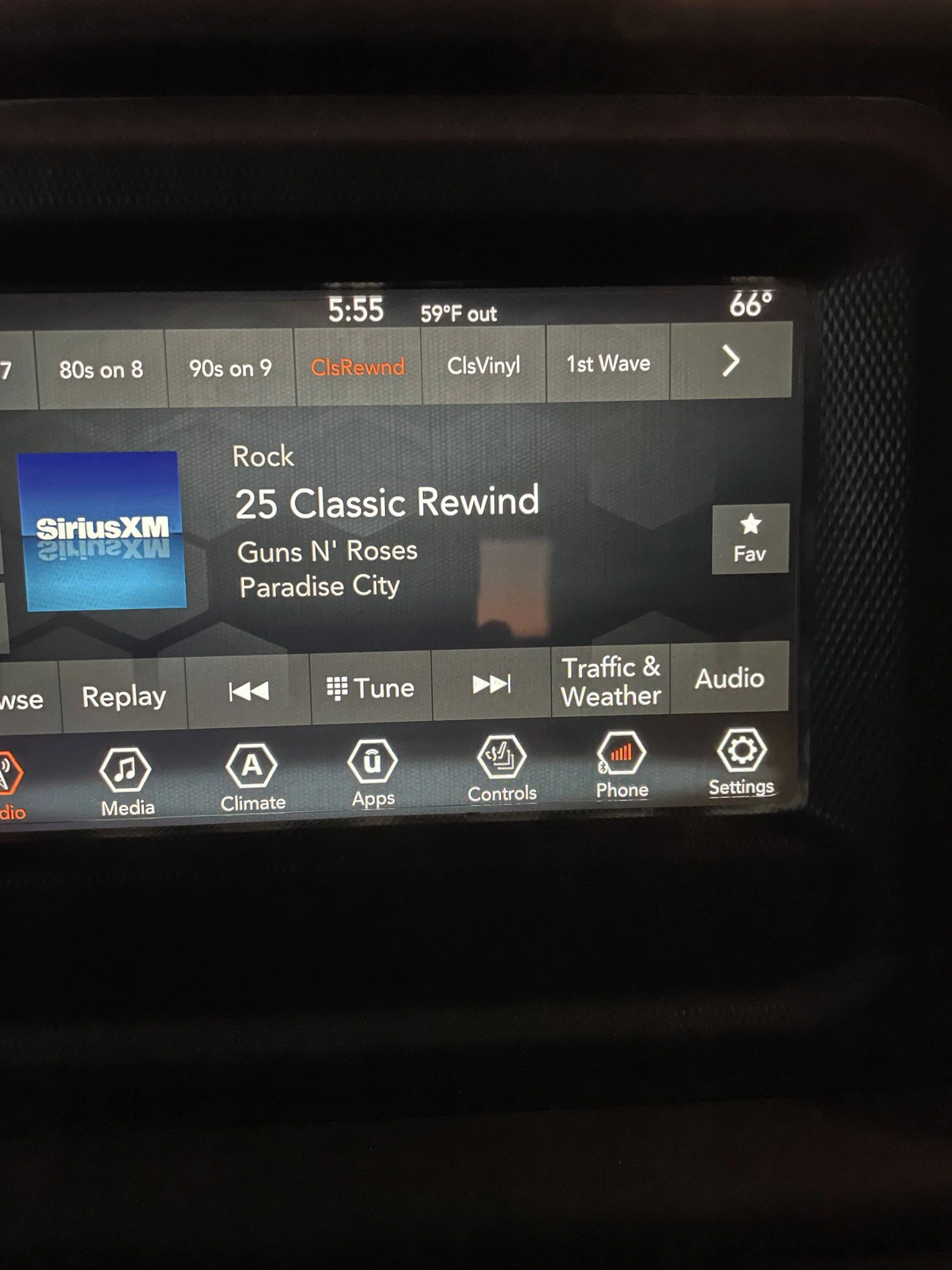

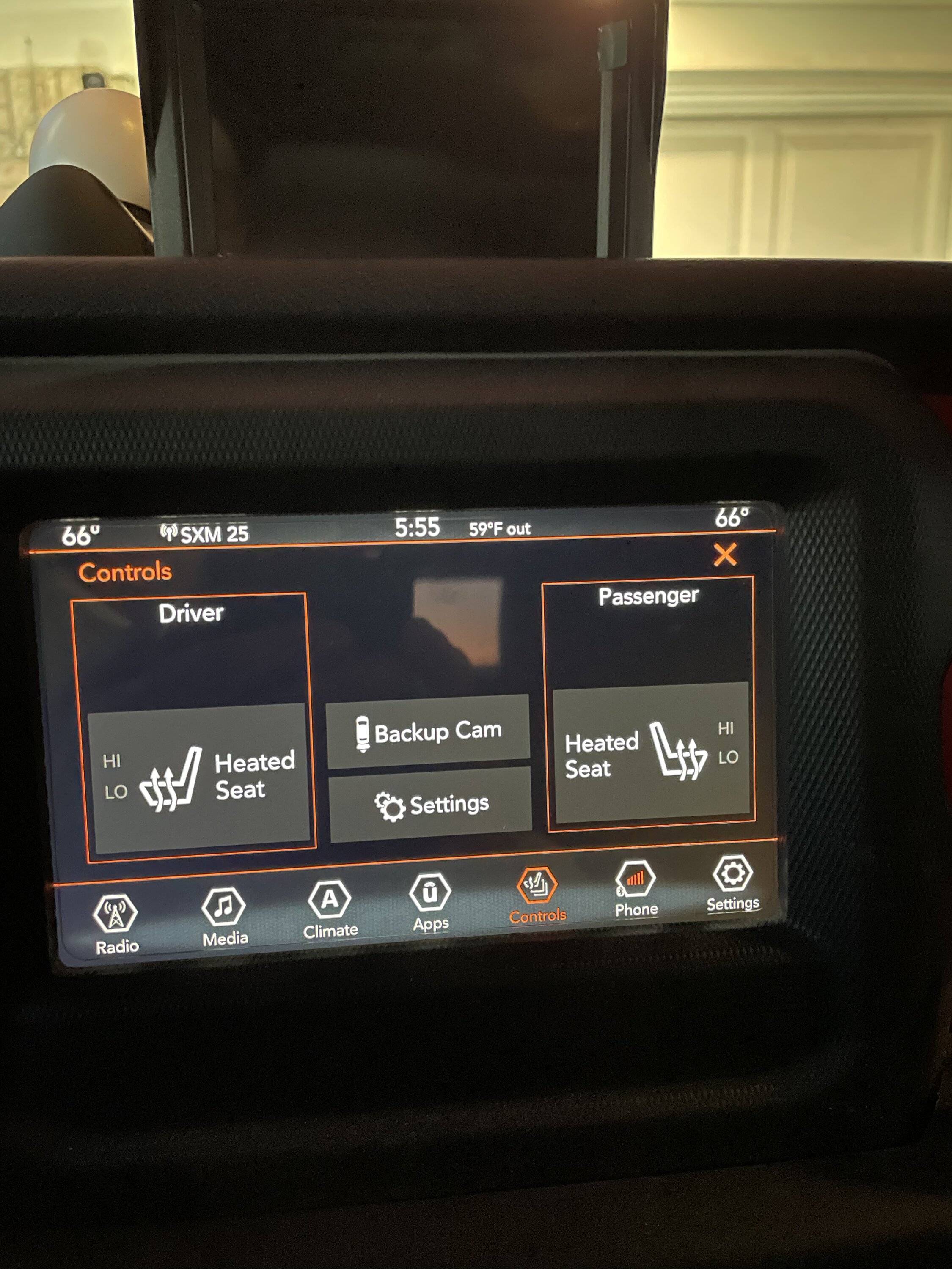

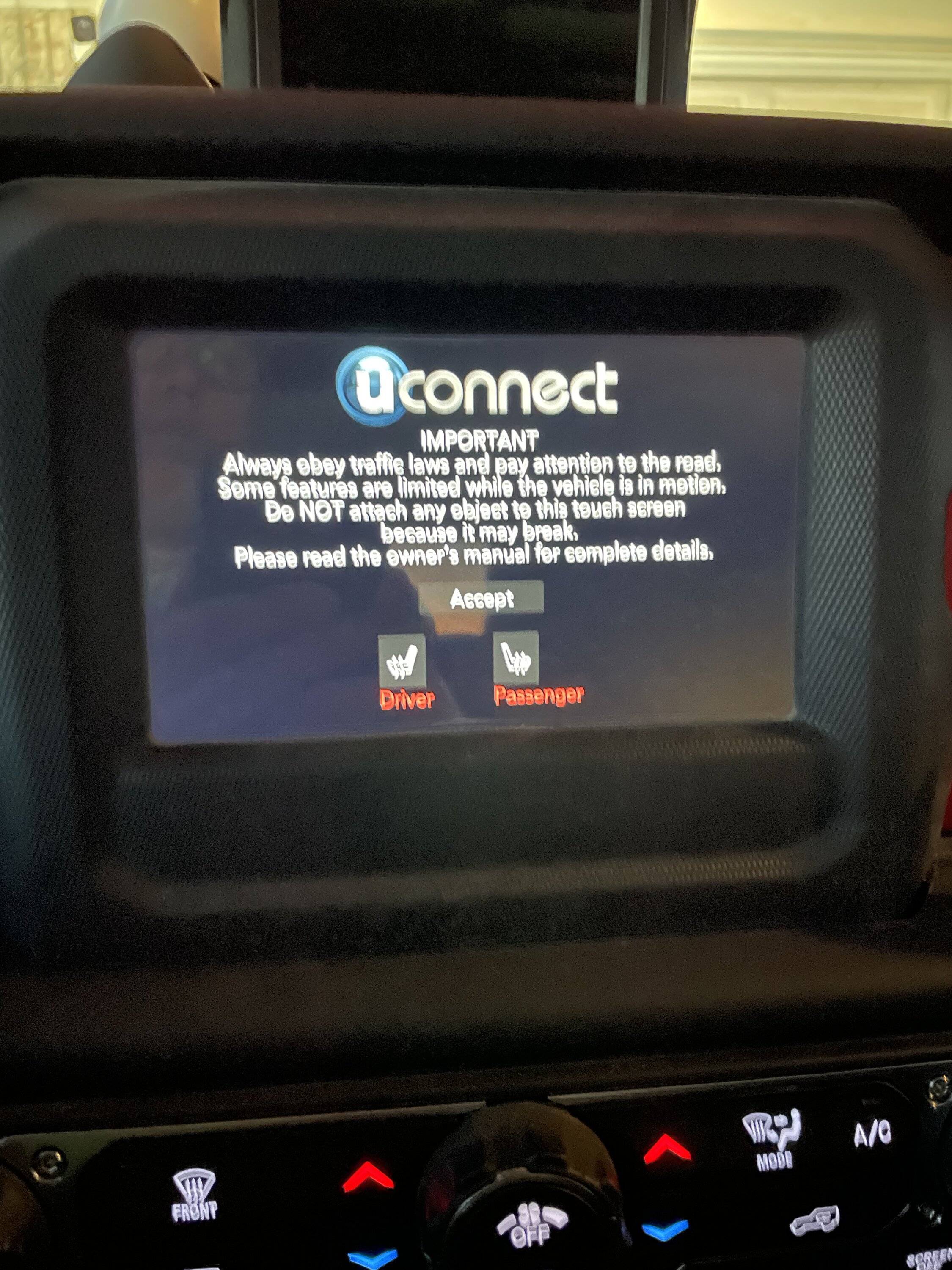

If you added the CSWM to the cabin network the icons show up when the radio is booting up and then they are in the “controls” icon with the backup camera. Click on apps and they will show up individually also.
Jeep Wrangler JL Heated Steering Wheel - It can be done. E62DB0C0-7735-4384-933A-FED6BC4F3501
Jeep Wrangler JL Heated Steering Wheel - It can be done. A74EE474-027C-4DFD-A1AE-EE6F0AC00047
Jeep Wrangler JL Heated Steering Wheel - It can be done. 46249085-59FE-4EBD-870F-BF81F437F8F8
Jeep Wrangler JL Heated Steering Wheel - It can be done. 33CAE1D2-D1DC-402B-A759-5F1B19FA2D34
Jeep Wrangler JL Heated Steering Wheel - It can be done. D133BD5F-E50A-4A22-A8F2-5FBF17CE9A18
Note I don’t have a heated wheel (yet) but it shows up with the drivers seat.

I added the CSWM to the cabin network last night and that was when it (heated wheel, seat lights) started working in the center stack. Of course the seats go out after a few seconds right now as the elements/circuit to the seats are still missing.
What i didn't know was there was additional settings in the miscellaneous setting(in HVAC configuration and more) Front heated Seats Present and Heated Steering Wheel Present. Once I turned those options and the next time i fired it up the uconnect head unit had the icons and the ability to turn seat steering controls off and on.
