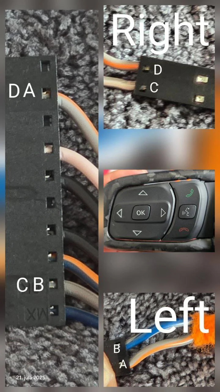

Today I took the steering wheel apart again. I measured all the cables and switches, checked that everything is connected and the switches are functional. After reassembling it, it still doesn't work. I'm at my wits' end. I need to find out how the steering wheel ring and radio are connected. The buttons for controlling the phone, dashboard and cruise control work.

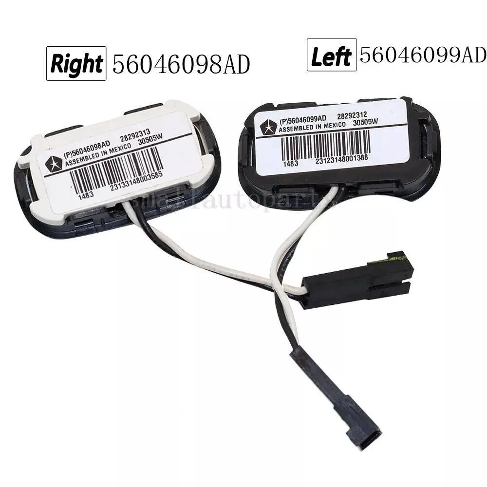

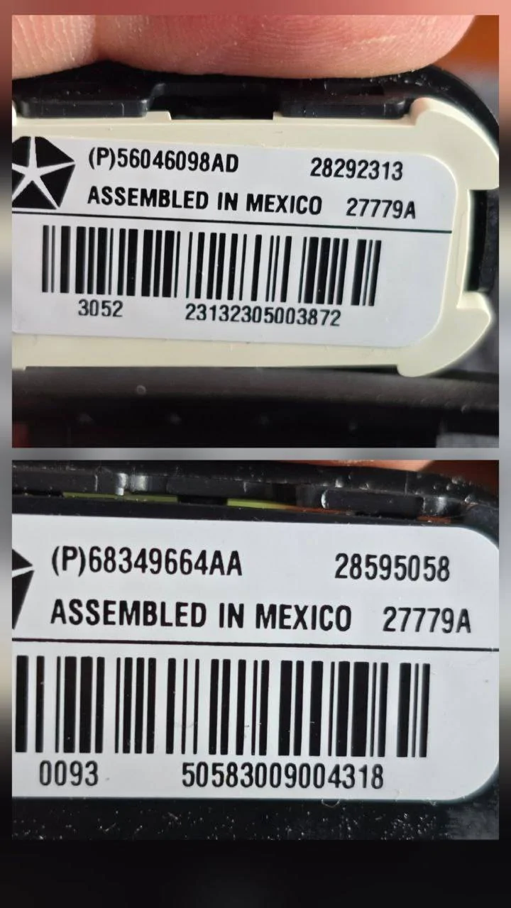

Could you please advise me if the switches for the right and left side have the same order number? What is the part number?
Jeep Wrangler JL Steering wheel audio controls: can they be disabled? photo_2025-07-21_14-56-10 (2)
according this picture I should have another No. of switches, but it previously work.
Jeep Wrangler JL Steering wheel audio controls: can they be disabled? 1753121119498-2d
