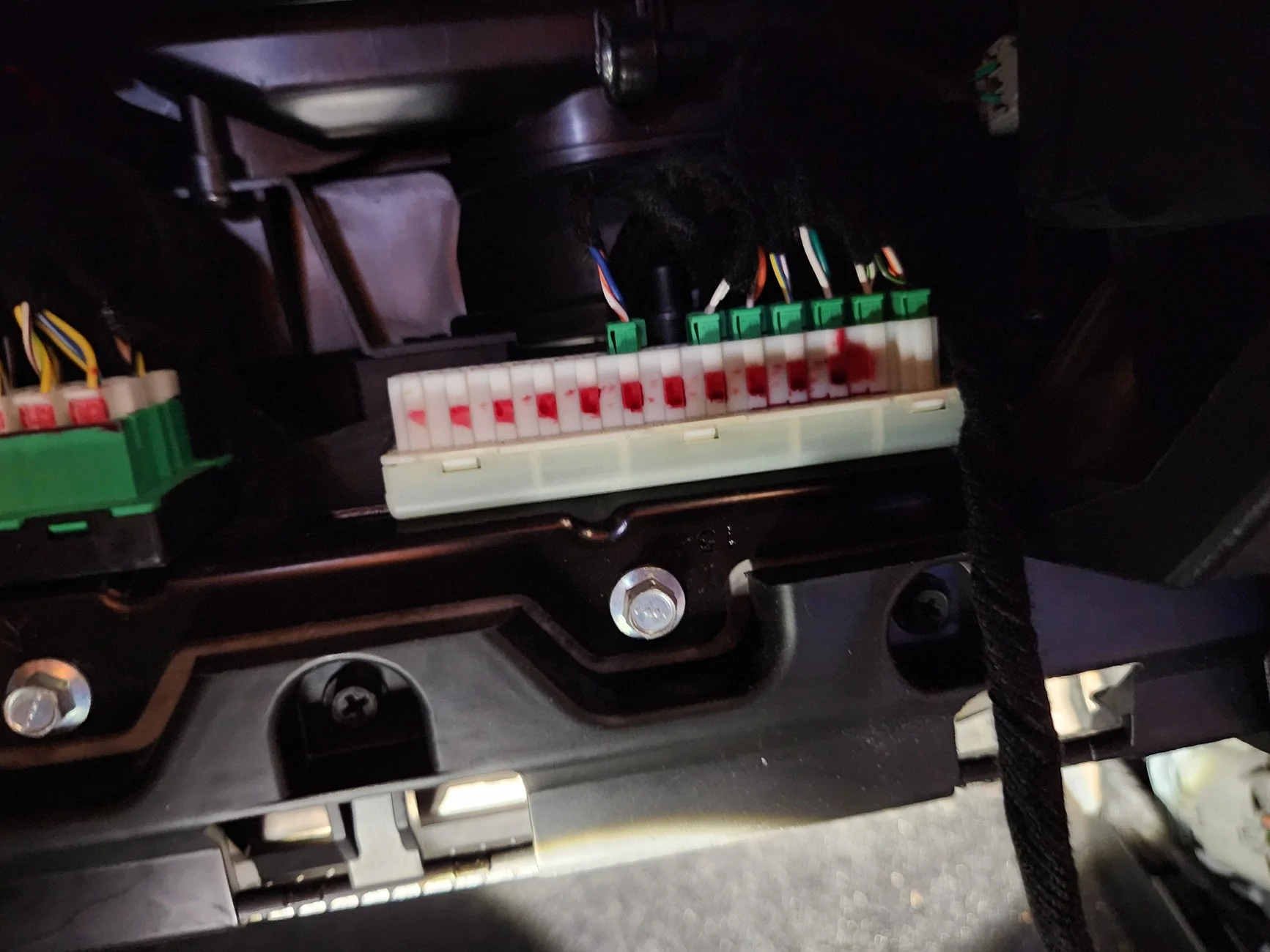

Im doing the oem/mopar autostart system. I ended up wiring it to the front 12V port since I never use it as is, we'll see how that works out. I still have plenty of line to run back to the fuse box or I can extent the wires.
Side note for anyone savy with the canbus system. I already have something in my 8th spot from the right. Any idea what it could be? I've got time while im waiting on my clock spring to come in but I didn't wanna start unplugging things just yet. I got a 21 ecodiesel with the tow package, led package, and 8.4 entertainment package.

It doesn’t matter which port you plug into, they all preform the same function EXCEPT the first one, that one has an extra wire in it. I suppose that extra wire is to power the block 🤷🏻‍♂️.
