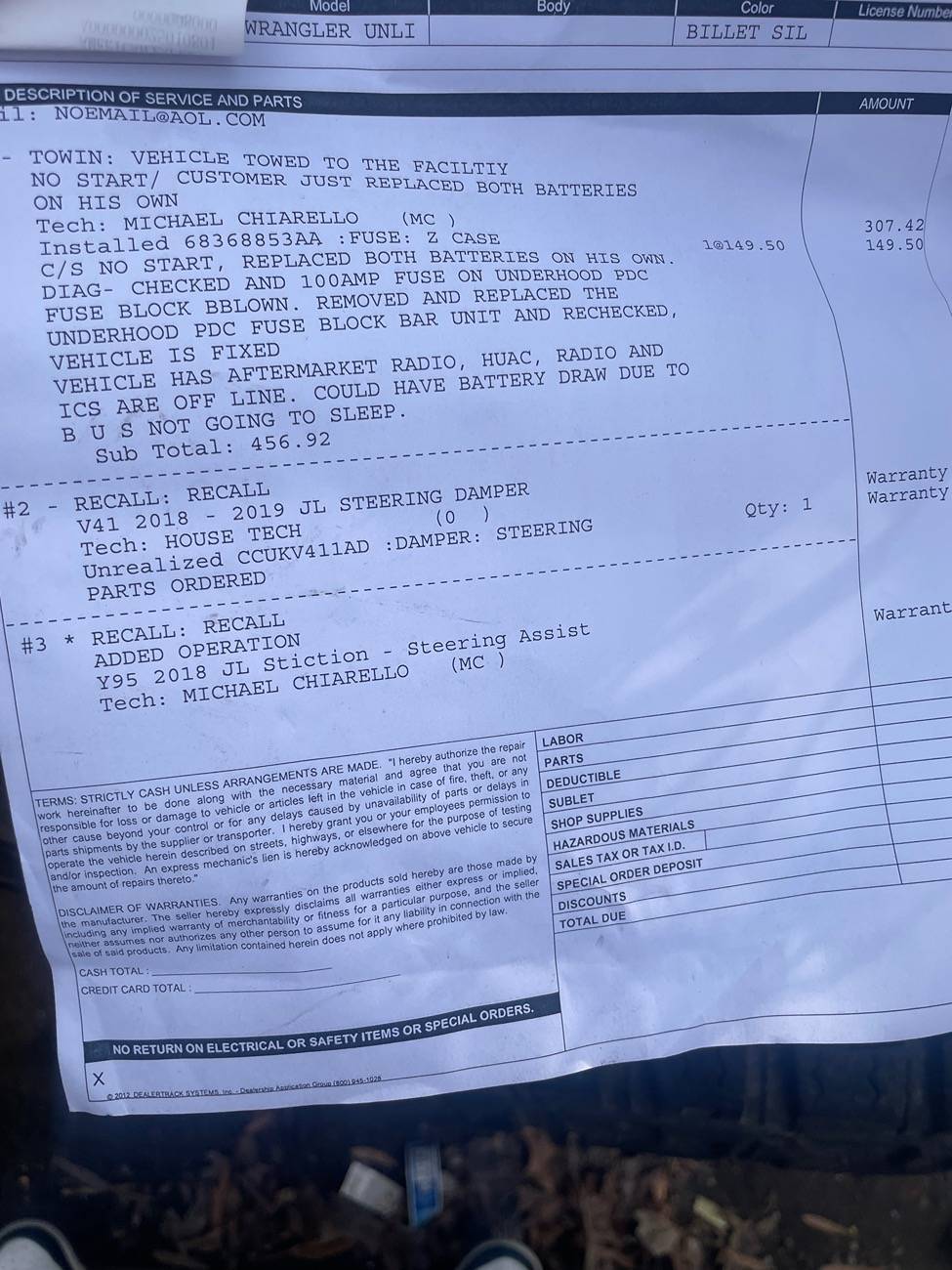

I’m going to give this a shot today. I tried to get them to fix the issue but they are blaming the issue on an aftermarket screen which is bs. I took the screen out and put the oem connection on just to check with the same results. I hate going to the dealer…. Straight money grab sometimes over something simple.

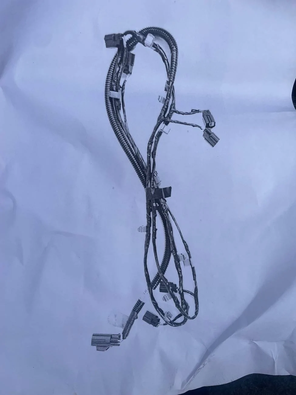

This is the work they did.
Jeep Wrangler JL Heat/AC not working IMG_0951
Jeep Wrangler JL Heat/AC not working IMG_0952

I had a similar thing happen with mine, a year or so after buying it. It was under warranty, and the small a/c control panel was replaced. It is what controls the a/c, heater, fan, etc. My.symptoms were that it took longer and longer, over time, for the a/c, blower to come on. It would sometimes take a couple of minutes. Eventually, it just stopped working. That is when I took it in. I didn't want them saying that the symptoms couldn't be replicated.
