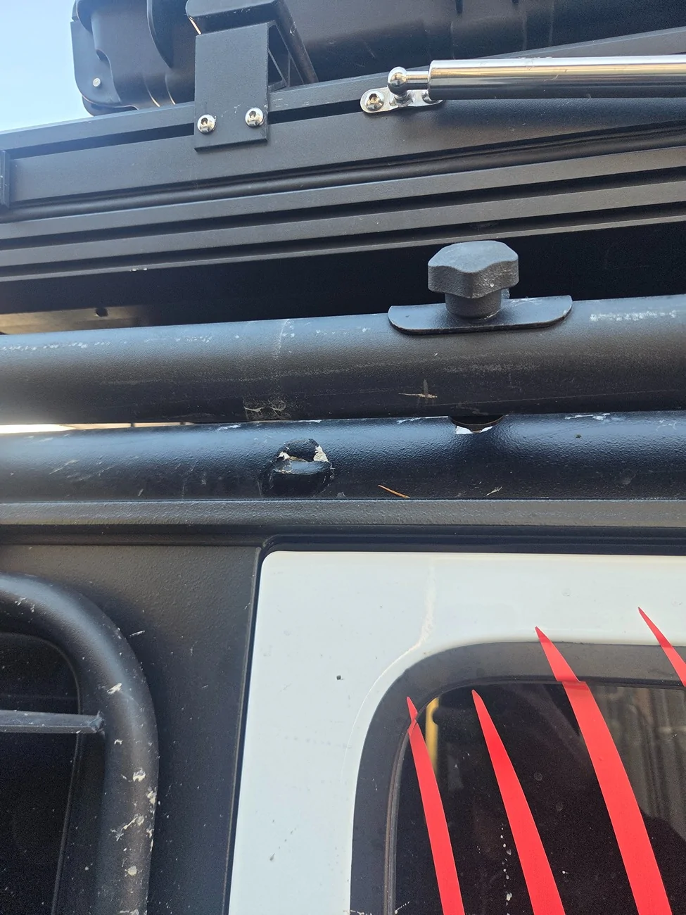

Hi jeep wrangler 2024 hard top pealing off any idea how to fix it ?
Jeep Wrangler JL Hardtop cracking fix 20251027_123242

That looks more like a hole, did you hit something?
Cheap fix would be to use an epoxy. But if it was me, I would consult a body shop that works on jeeps to get a more cosmetically correct solution.

Or a boat repair shop that works on fiberglass.

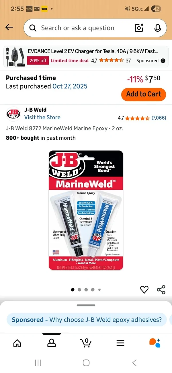

Ordered this from Amazon should work
I punched a hole in the top when jacking up the jeep in the garage. I hit the garage door opener.
I took just the top to a Corvette body shop for repair. Came out great.
Great to know thanks i will check up
