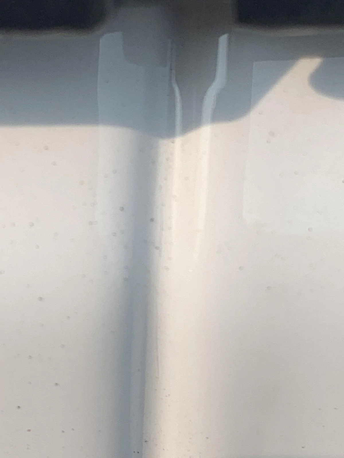

So after getting my rear quarter panel painted, I noticed they left another part of the area with a chip in the paint. Now I have to go back to the auto shop where it got painted to see if they are in The wrong for painting that area :facepalm:. While pumping gas into my Jeep yesterday I looked over the area where the crack in the panel occurred and sure enough it started cracking again:mad:
four low
Feb 1, 2017
3,106
3,681
central New York
2018 JL
These issues might be with the panel seam adhesive/ sealer under the paint. If it happens on mine, October 2018 Build Date, I will check it out. A magnifying glass might show if its under the paint, by seeing how deep it is..

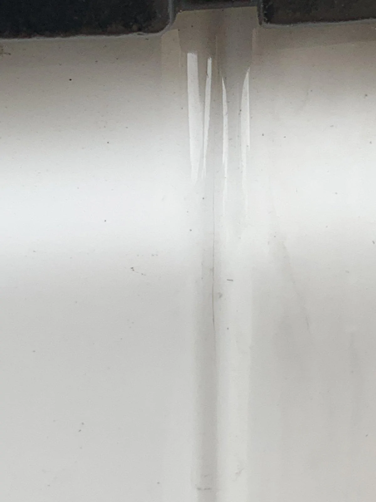

Good evening everyone, so once again my rear quarter panel paint is cracking again! This is like my 4th time, is there anything I can do about this? I’m getting tired of going back and forth from the dealership. Can this be a lemon issue?
DOCXKT
David
Sep 19, 2019
24
184
62
NEW YORK
2018 JEEP WRANGLER JL UNLIMITED SAHARA
Has anybody tried doing the lemon law buy back program in NY? Here’s another picture of my paint cracking after getting it fixed again.

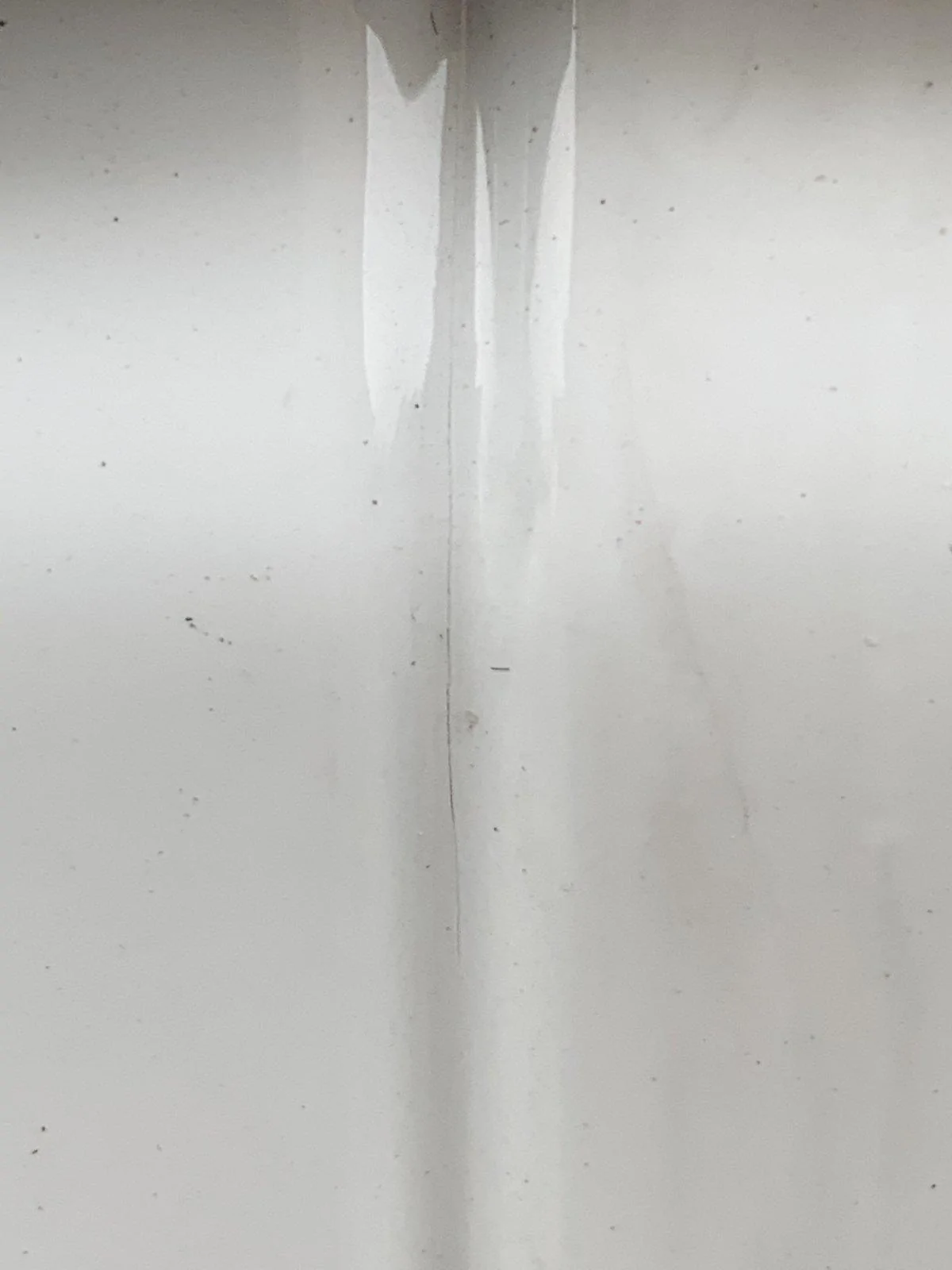

There’s no point of getting it painted cause it only lasts about a week to a month.. I’m working with Jeep cares and gonna see if I can start lemon law
Jeep Wrangler JL 2018 JLUR quarter panel paint cracking 9310CD48-9344-40A0-AC1D-5BD2FFC2B034
DOCXKT
David
Sep 19, 2019
24
184
62
NEW YORK

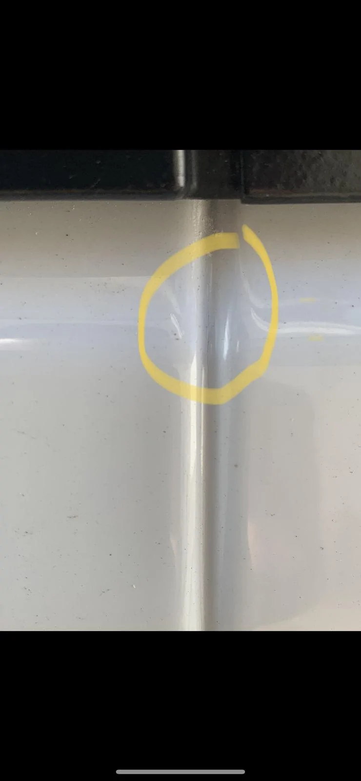

Got the car back about a week ago after another paint job and once again my paint started cracking... can someone guide me where to go about this?
mwilk012
Mar 10, 2018
10,990
11,319
Oklahoma
2018 Ocean Blue JLU Rubicon
Service
Obviously there is some relative motion occurring between the two body panels. Painting it won't fix anything.
