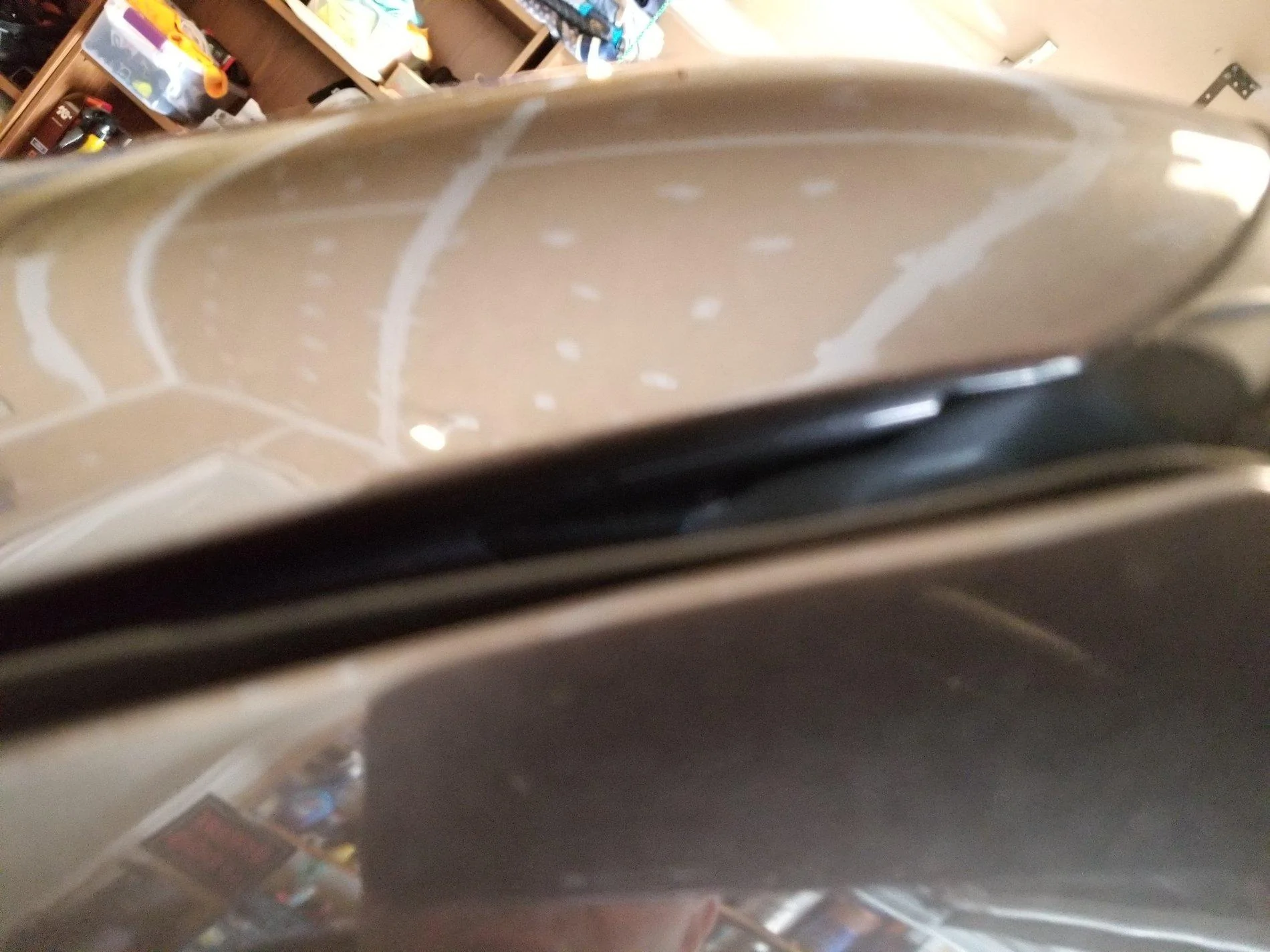

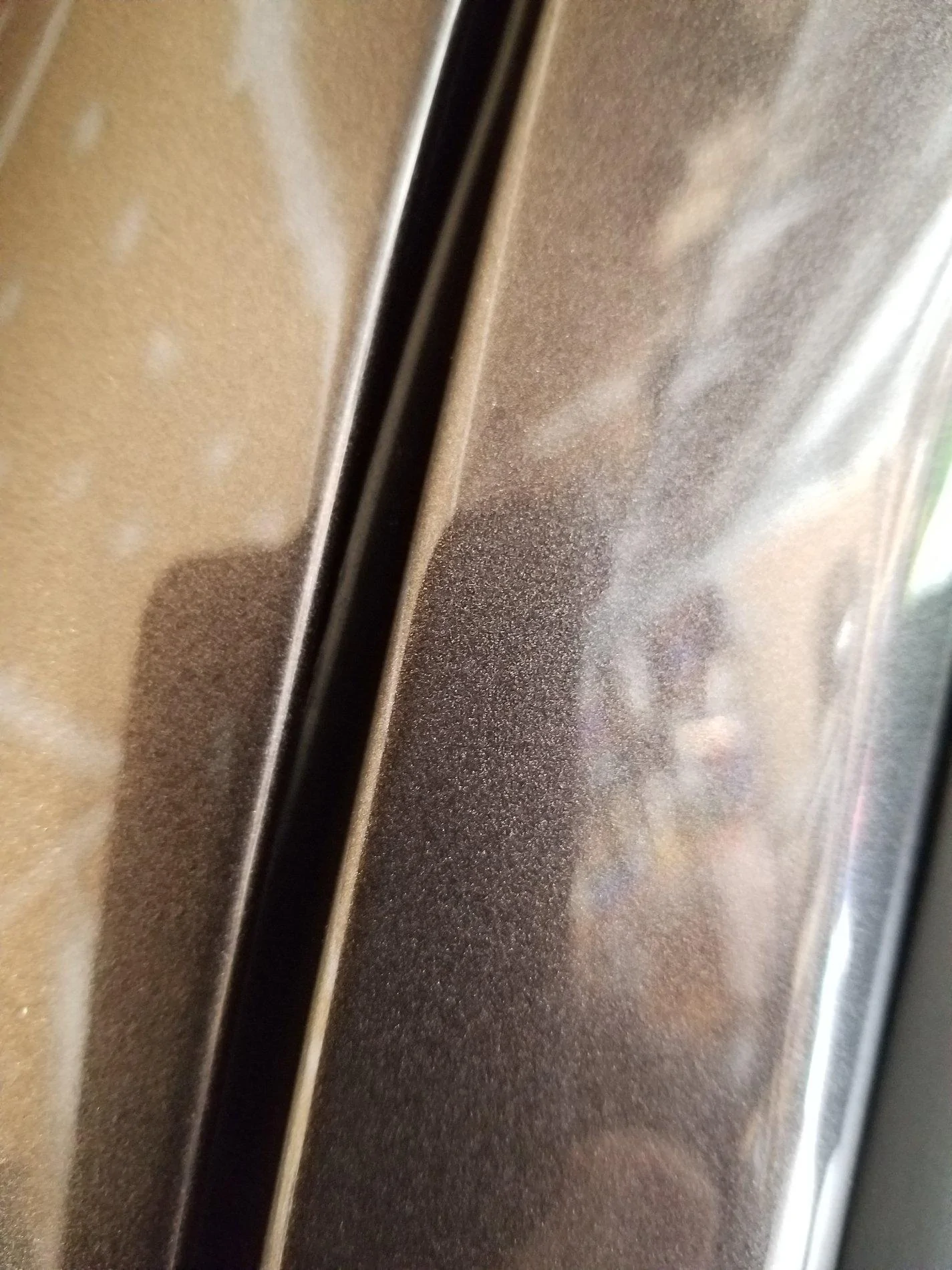

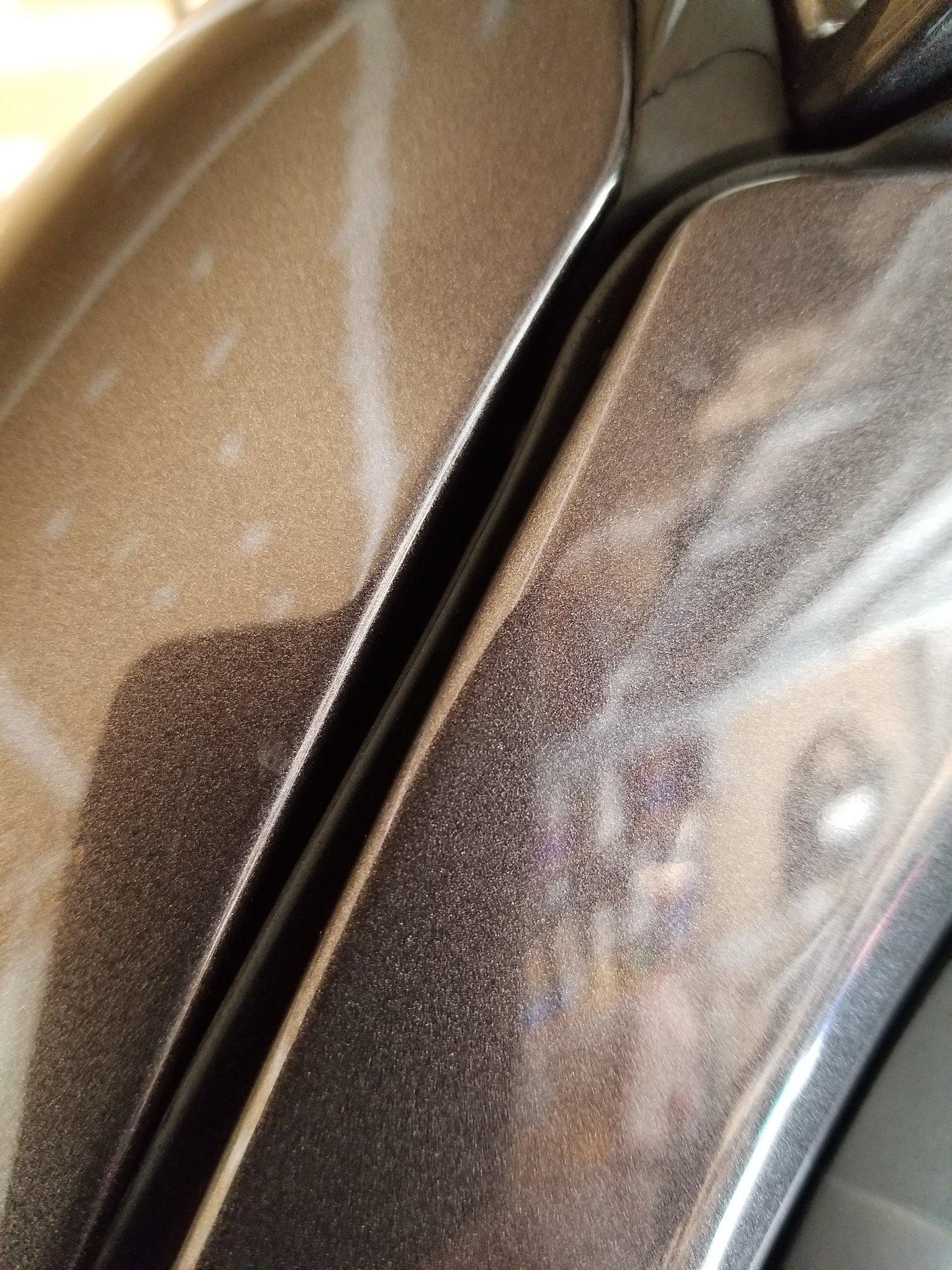

Ok, I've inspected the door and window seals closely. I see on the driver's door top left corner the rubber seal is slightly misshapen (see pics). It's like it's been pressing on the material inside the door jam (the pieces that Jeep adds to the front corner, at the factory) and that pressing has affected the door seal. Kinda hard to explain... Any way, whatever is causing the "morse code" noise has to be minor/easily fixable because;
#1 The passenger side does not have a problem and
#2 My Rubicon is tight as a drum as far as water leaks (numerous car washes and top removal) and not a Drop!
So, I'll tape this corner off and test it the next time the wind blows (now the Maryland wind will litterarly vanish!) with my luck....
I had similar issues with my JK (the misshapen door seal). Had it replaced and Ill be damn if the replacement wasn't pretty much the same (it was the front of the door seal against the A pillar (it left a gap about 5" right above the rear view mirror). Solved by getting some black rubber weatherstrip from the hardware store (approx 1/4" DIA D section profile). Jam it in the spot where its misshapen and it fills the gap and allows it to push against the pillar and seal correctly. After a few weeks I actually didn't need it anymore as the OEM seal was now permanently folded over a bit in the right direction - but regardless since I bought black weatherstripping it wasn't really visible.
Before I did this I had noticeable wind noise near the windshield (not the morse code like sound on the JL).
sad to have to do things like this on a modern car that costs over 40k, but until they stop selling every copy they make. . . . .
