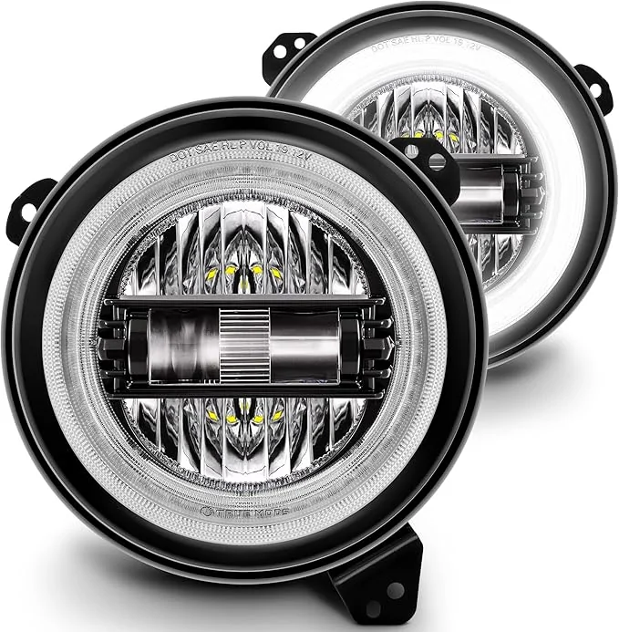

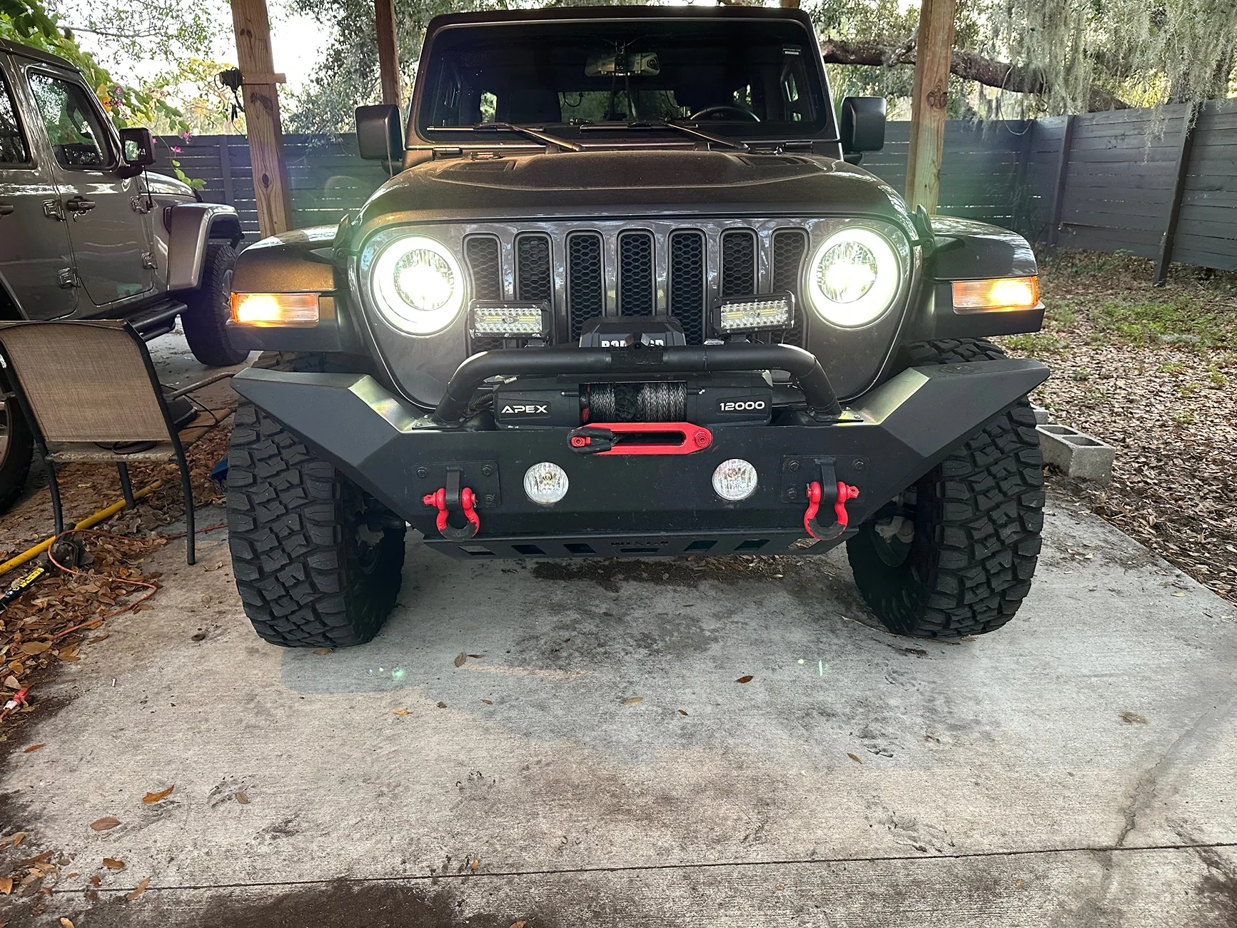

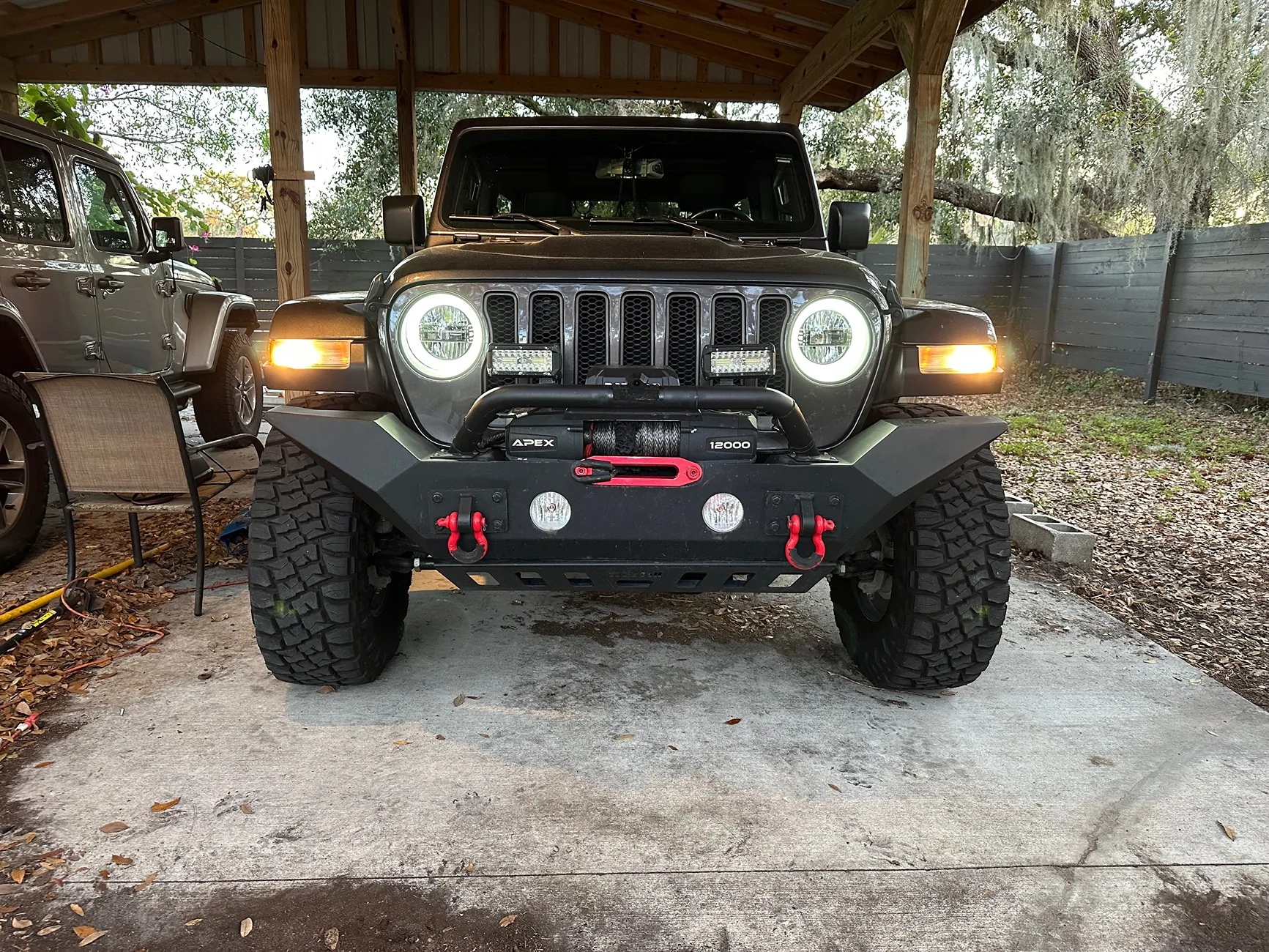

I bought a pair of these late last week and installed them. https://www.amazon.com/dp/B0CMVL75QD?ref=ppx_yo2ov_dt_b_fed_asin_title&th=1
They cost $249.99. They are highly reviewed on well-known Jeep YouTube channels.
When researching headlight assemblies on Amazon, I soon learned that pretty much all of them have resistors that eliminate flashing, and the ones with halo DRLs come with a wire harness with a fused tap. It literally takes two to three minutes to install that wire harness.
I am very happy with these lights. By the way, all of the install videos say you must remove the grill to swap out the assemblies, or even to change a bulb. I have a big-ass winch that doesn’t allow me to remove the grill, as it’s all smashed together tightly. I DID NOT remove my winch OR grill, and was able to change the headlight assemblies anyway.
It’s very easy to do. Just remove the plastic retainer pins (all six) along the top of the grill, then in front of each headlight bend the grill out just enough to allow removal and install, and repeat for the other headlight. You can prop it out with an appropriately-sized piece of wood. The grill is very flexible and will bend sufficiently without breaking it or cracking the paint on it. I have done this multiple times on three Jeeps, with no damage.
