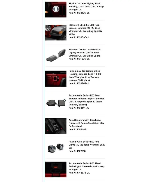

A really cool dude in Facebook upgraded all his lights off his 2020 Rubicon and took them off before returning it to the dealer (apparently it as a lease). He's now selling everything for a really good price, and I am thinking about getting it all from him, (please see picture attached so that you can have brands and models, for your reference) but again, that fear of maybe them not working properly hits me again. I want to only do one thing and forget about it, pretty much.
What are your thoughts?

And yours were literally plug and play? No need of extra harnesses? Flashing at dealerships and none of that?

Many of them are plug and play. Did the guy you’re considering buying them from say he needed the dealer to flash the changes or that they’re plug and play?
If you end up needing to flash at the dealer, I’d consider getting JSCAN instead. The OBD II reader, SGW/SGM bypass, and license is about 1.5x the cost of the dealer flash (depending on the dealership, it could be the same price), and then you have a programmer to also change tire size or other things.

I had a 2020 JT with halogens, I replaced everything with LED. Headlights, Tail Lights, Fogs, Turn Signals… the only thing I needed to flash for was the turn signals, and I just used my Tazer for that. It was super simple, and WAY better than the factory halogens

What brands did you use?
The guy said he took all that (items from the screenshot I uploaded) off his 2020 Rubicon.
I trust it, but IDK if there's anything different from that one and the my 2019 JL so I really can't be certain unless I get them and install them all. I may just do it for the sake of it!

I used bulbs for the headlights that came 100% plug and play, I looked at some different complete replacements but didn’t like any of them, and bulbs in the fogs and tails, IIRC, all the bulbs were sealight, the side marker/DRL/turn signals I used quake slims

I used bulbs for the headlights that came 100% plug and play, I looked at some different complete replacements but didn’t like any of them, and bulbs in the fogs and tails, the side marker/DRL/turn signals I used quake slims
I see... I don't really want to do bulbs. I want to change the whole thing. Actually, those Skyline Headlights are well known and mentioned by a lot of people because they look like the OEM LED.
