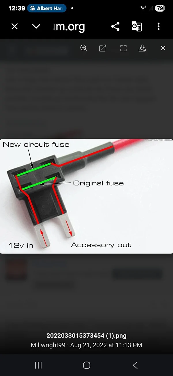

I did a fuse tap for my after market fog light upgrade (drl). Basically ran a wire from each light up to fuse panel under hood and spliced into fuse 52 I believe. You can get fuse taps from Amazon at an affordable price and splice into fuse. Buy the fuse tap with a 10amp fuse and put it at top with the factory fuse on bottom. Worked perfectly for me.
