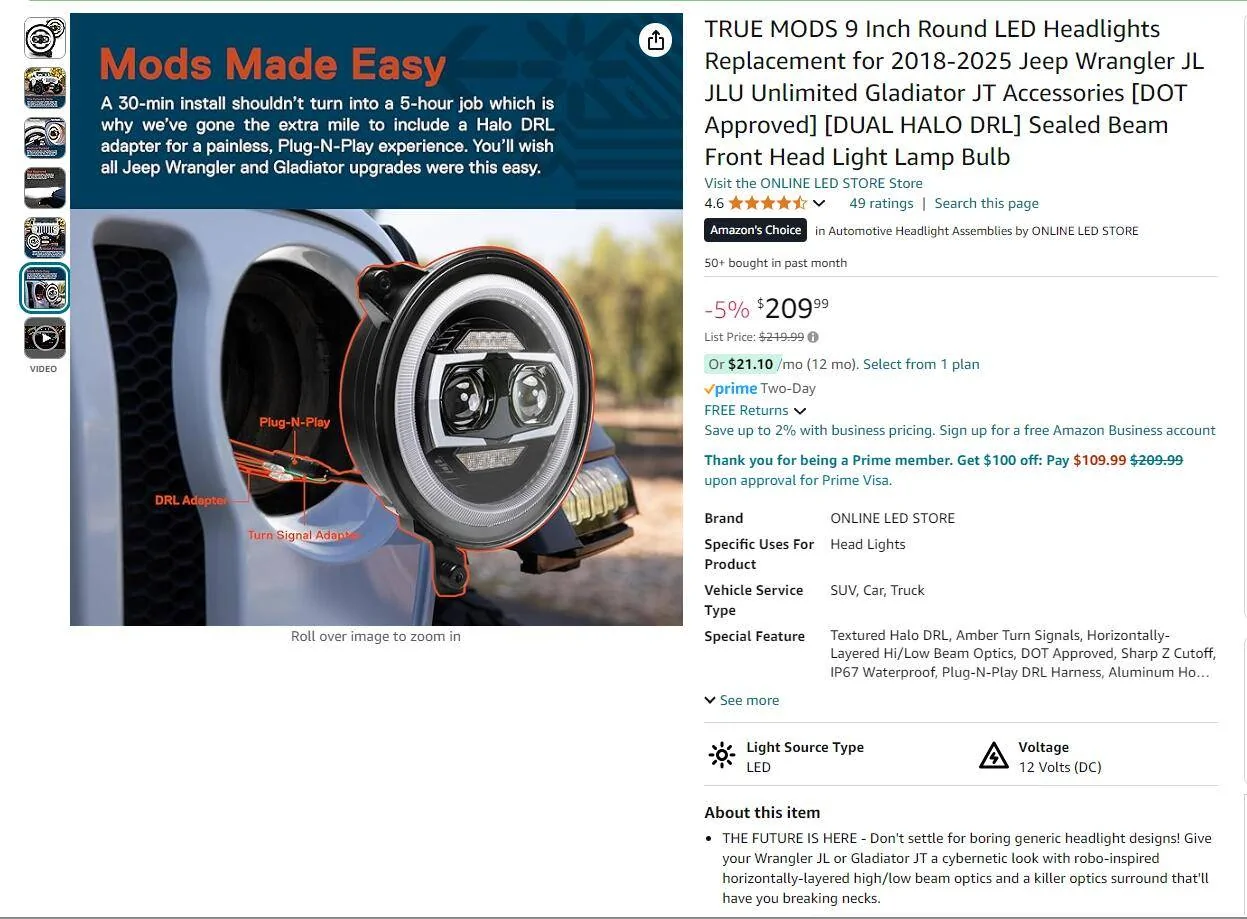

JL ME
JOHN
Jan 25, 2022
388
749
Portage Wi
2021 JL Willys ,2006 Roadking , 2008 Hayabusa
Industrial Maintenance
I'm thinking about this.
