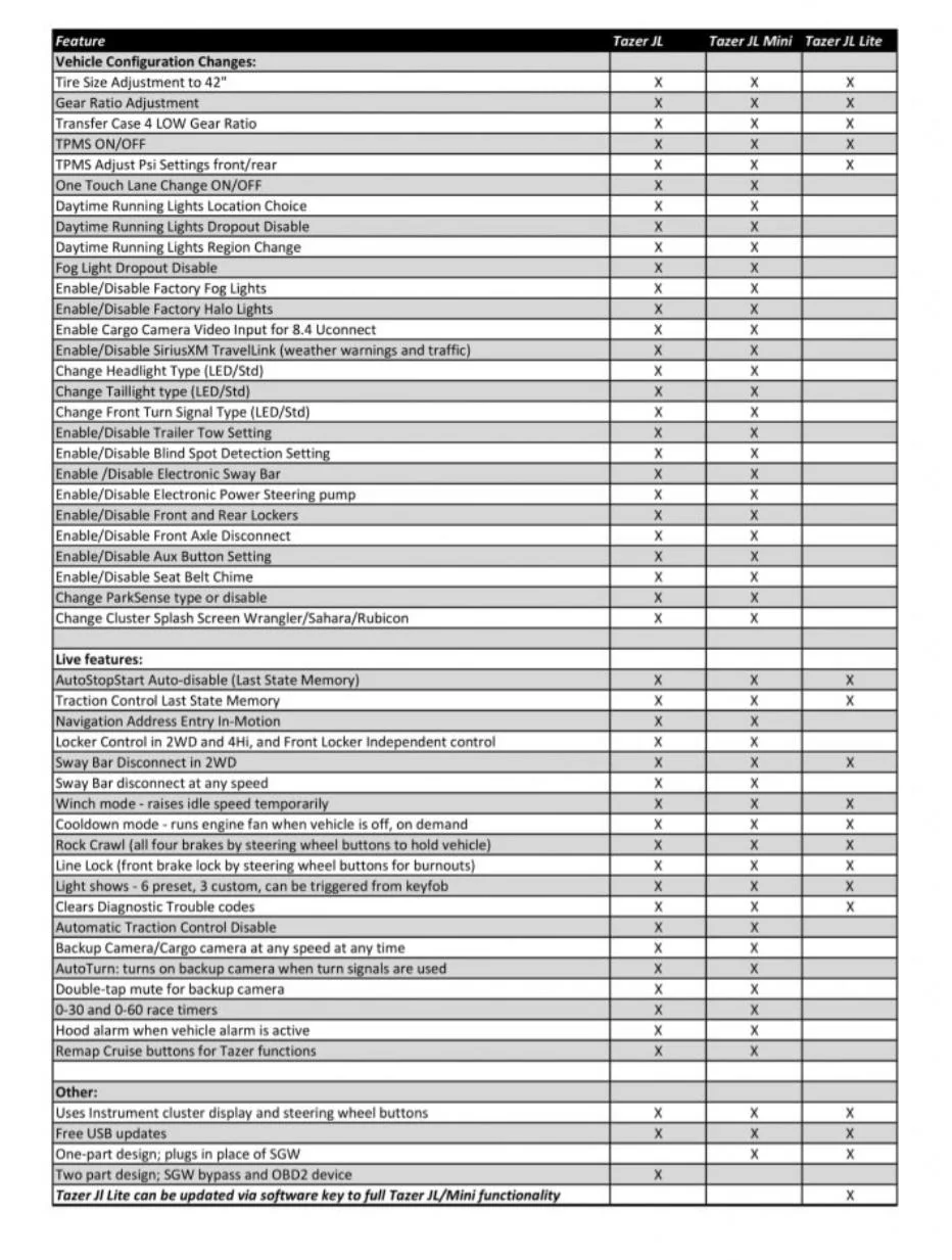

Tazer Lite will not work for this change. Need at least the mini. @Alasek I believe you can send your Lite to Zautomotive and get upgraded to a Mini. Here is features list by model.
